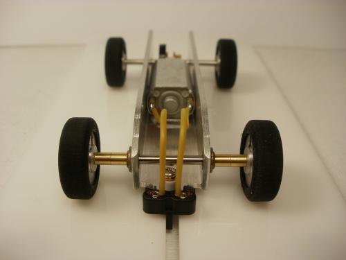

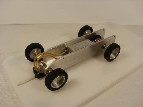

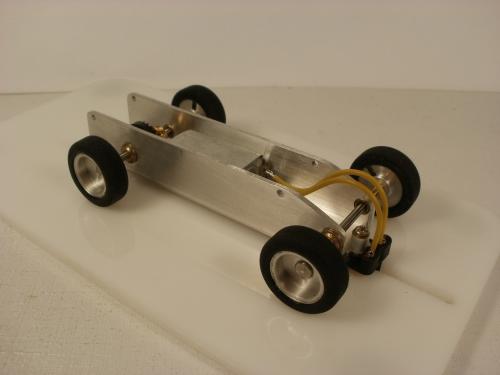

J-van chassis runs, and it's quite fast. It just needs to be mounted to the body.

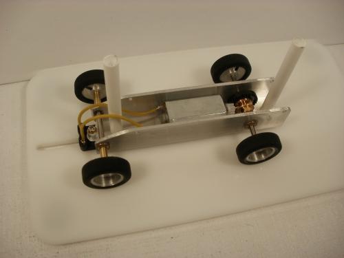

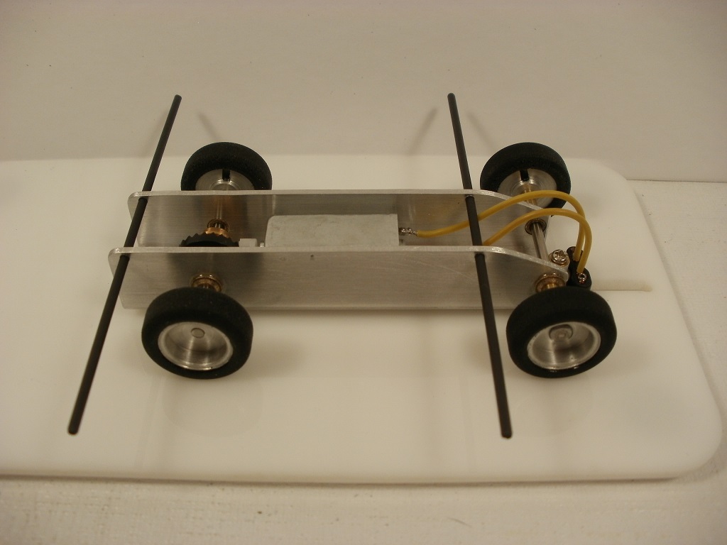

Body mounting options.

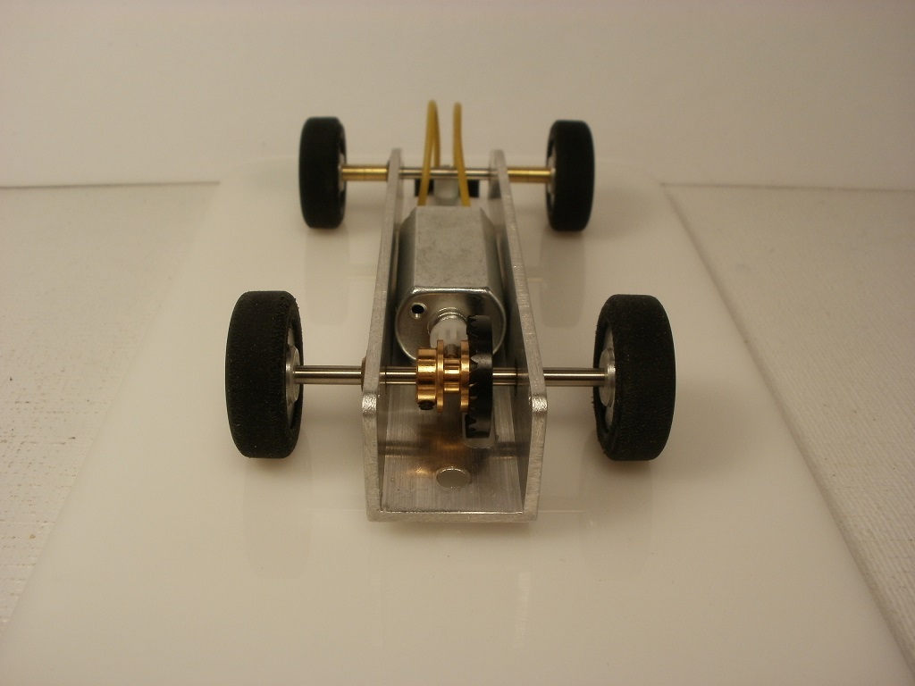

RS Slots 14x5 wheels. Urethane tires (glued and trued). Professor Motor hardened axles, Oilite bushings, competition 1mm braid, CH10 guide, competition motor wire, 27T crown gear. Scalex FF 050 18K motor with 9T pinion. Independent front wheels.
2 x 4-40 brass inserts, 4-40 countersunk screws with #227 Evergreen styrene tubing and 2 x 5"inch lengths of 0.070" carbon fiber rods.

Great chassis ,just one point though ,will the front vertical body mount interfere with any cab detail .

I think that's exactly why Ken has thoughtfully provided the horizontal rods as an alternative.
Having said that, on the real thing the engine compartment protrudes a fair way into the cab, just to the left of the driver, so it may be possible to glue a containing box to the body, with the body post inside.

Fluff. I have not seen the inside of the van. I have no idea what to suggest for body mounts so I provided several ways. The tall sides can also be used to mount the body in some fashion.
Jeremy. It's a fluke. The tall sides were left on because I had no idea how Jason was going to mount the body. Mind you it's not like we're building the next record breaking slot car. The extra weight of the sides won't make it lose a race against another J-van or anything.
