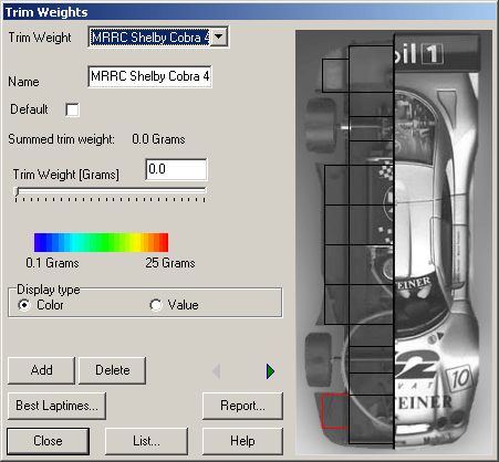

Trim weights are added by clicking the corresponding part of the chassis displayed on the right of the dialog and by setting it´s value using the text field or slider control. This way the position and strength ov the magnet is configured.
Note that the displayed values are meant to reflect the correct added weight on the left AND right of the car (a symmetrical setup is assumed).The right part of the image only serves for better orientation (car front and rear).
The current chassis part is coloured or marked according to the trim weight.
The option “Value” is recommended on older computers.
If the parameters have been set, the weight setup´s description can be saved using the “Add”-button. Parameters are changed by going to the previous or next description (“<” or “>”), using the list or report or by closing the dialog (“Close”).
Clicking the “Best Laptimes”-button starts the dialog for analysing the Best laptimes10KJFMO and filters the lap times using the current description.
Use “Delete” to remove a description and all of it´s associated lap times etc.
