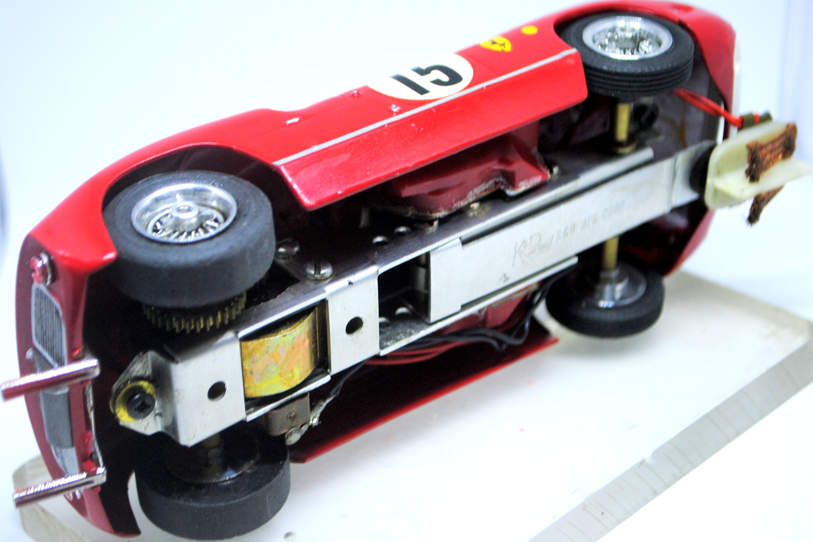

In no particular order, I have decided on building a K&B lola T70 that I bought from epay likely more than 10 years ago. All the body bits are there and minty minty, but, the chassis was built (not well) and is missing a few bits,.....luckily, I have what I need.
Box contents..........

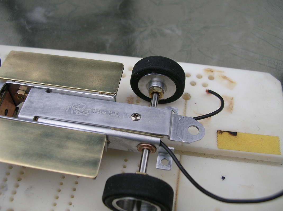

As far as the chassis, I did want to improve the handling, by adding some weight, and freezing the drop arm/adding adjustable guide height, while being able to revert the chassis to stock if the need arose.
So I used the many wheelbase holes on the chassis to bolt on some drilled brass strip, and then used some simple piano wire "L's" to attach the pans......much improved handling. without altering the stock chassis.
I did trim the top aluminum rails on the chassis so that I could lower the body just a touch,...not "slammed" but more in line with the actual car.

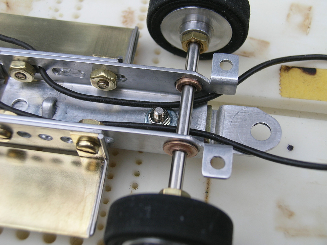

I did replace the rather sloppy original front nylon axle bushings with some 1/8 oilites.......and the sharp eyed among you will notice that front axle spacers are yet to be installed
