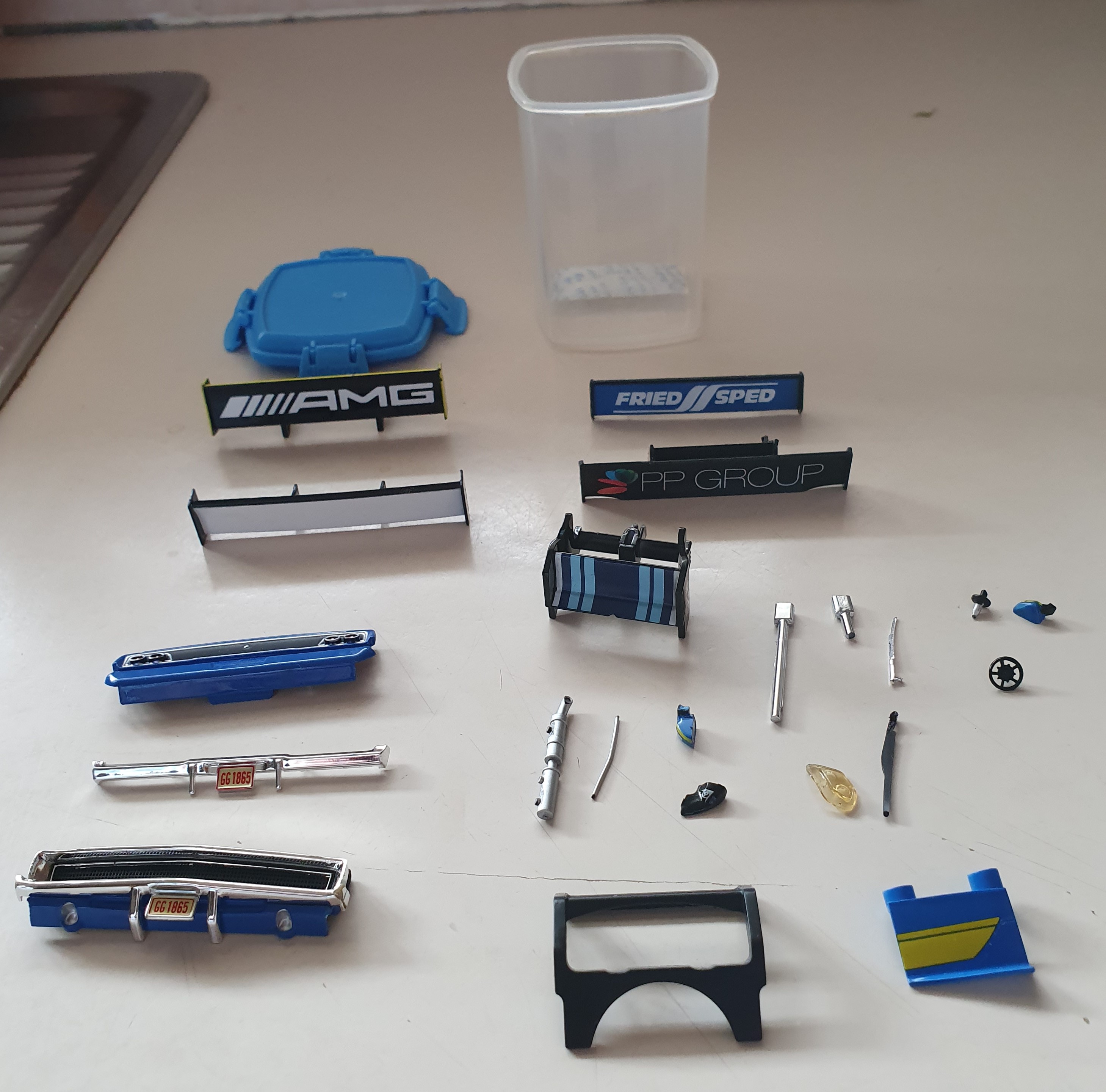

Not specifically related to buying replacement parts, though images show the damage that can occur.

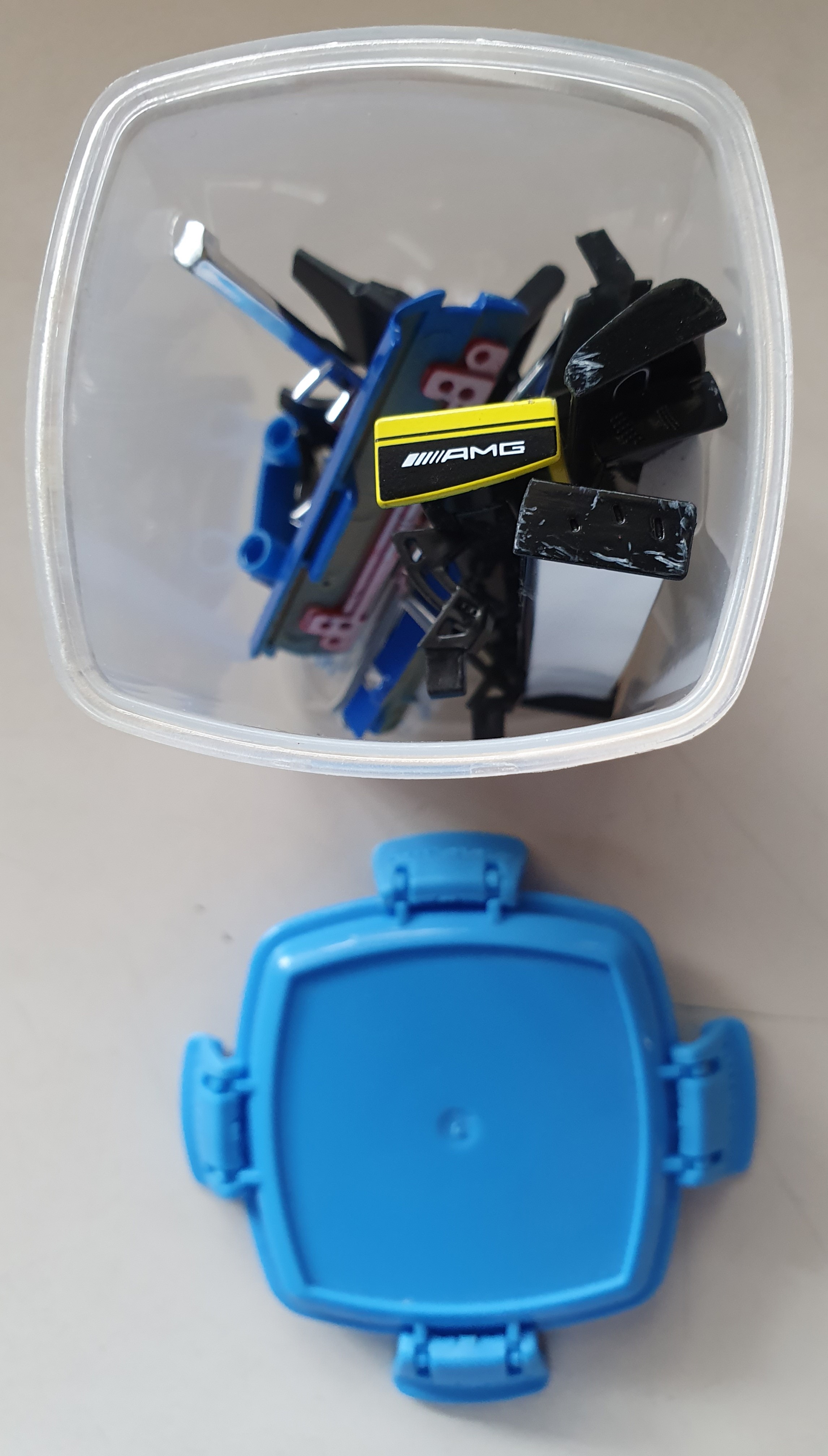

Thought I would show the left over carnage from a mixture of Scalextric AMG GT3, Scalextric F1 and Pioneer cars. There is a variant in items, from antenna, side mirrors, wings, exhausts, bumpers even a steering wheel.
I have glued the front wing of a F1 car with Selleys PlasticFix which contains two parts to the glue.
Part 1 is the Primer, and Part 2 is the Adhesive (like SuperGlue tube but not). The PlasticFix does work really good, I suggest though, some careful prep work be done such as smoothing both joints before application and do a dry 'fit test' I buggered it a bit as the plastic sort of melts a little, used too much pressure and ended up with a ridge line, so had to get the trusty Rotary Tool and grind it down.
I've retained the parts for 3D scanning replacements eventually.

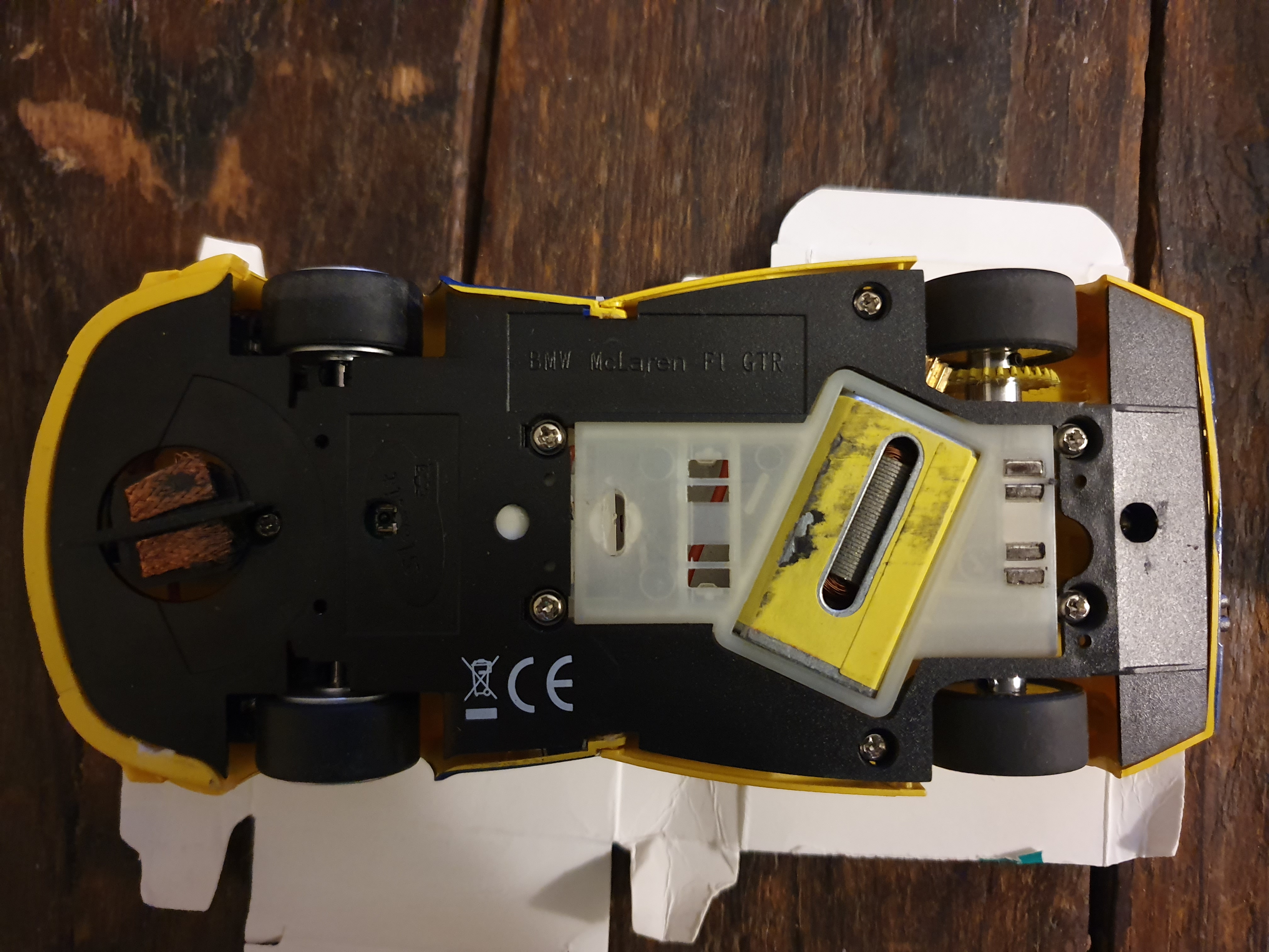

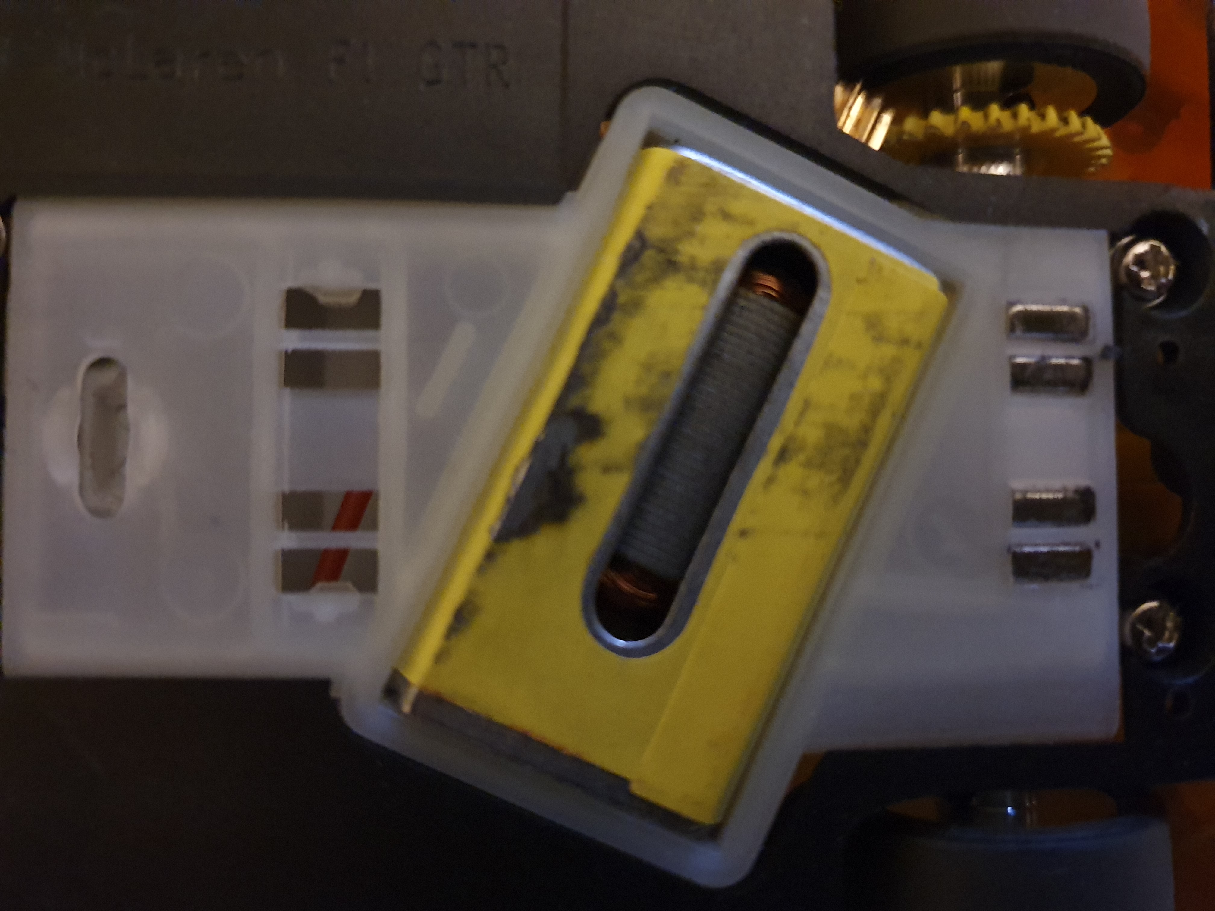

Not technically parts broken off cars, however these images show how low the BMW McLaren F1 GTR is.
SLOT.IT CA10L-SSD - BMW McLaren F1 GTR - Donington 1997 #27 under pan 1
SLOT.IT CA10L-SSD - BMW McLaren F1 GTR - Donington 1997 #27 under pan 2 (close up)

Or how bumpy your track is!!!
