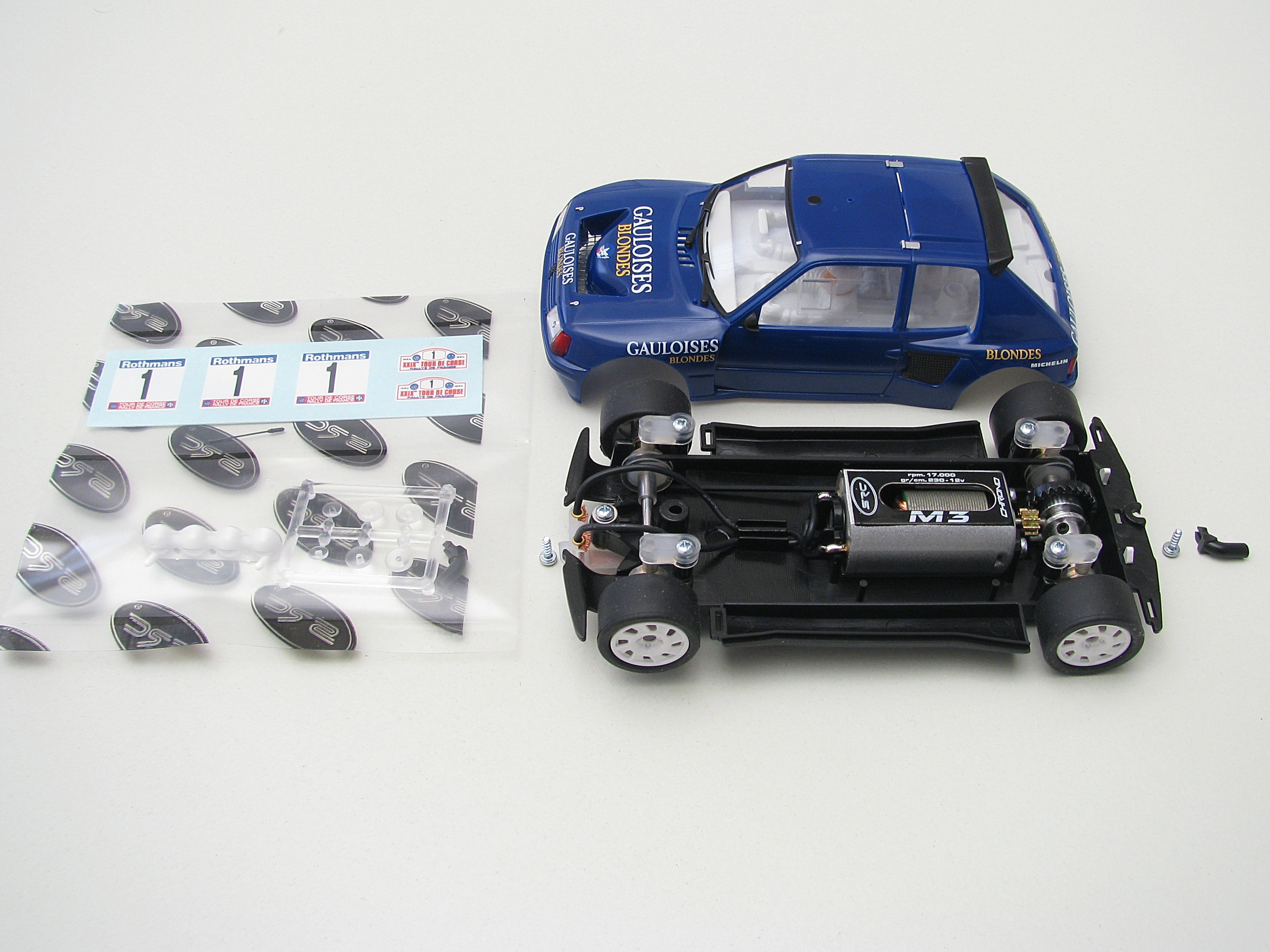

The inliner 17000 rpm 230 grcm M3/N motor drives the sprung rear axle. The sprung front axle is driven by pulleys and a belt.
Naturally, it has also a sprung guide.
You can apply decals of starting numbers and rally plates yourself as desired.
The same applies to the roof antenna and the lamp pod with lamp lenses.

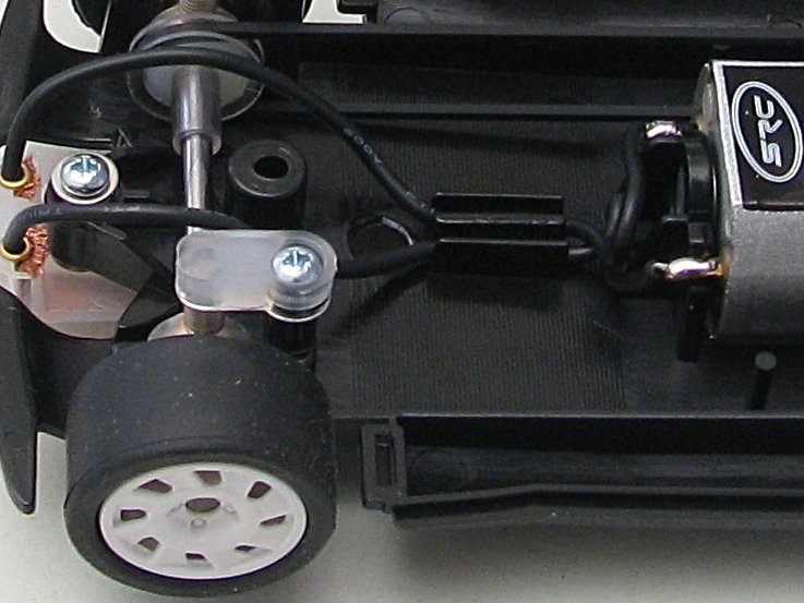

I have a question, if I look at the picture of the chassis (on SRC website) I get the feeling that it is 3D printed because of the difference on the front. Is this the case or is it just the picture confusing me?

You can see the ejector pin points so I'd say it's injection moulded.
Hi Henk,
It is injection moulded.
I have seen that photo too. The reflections of the light cause this confusion.
That ribbed part is also present on my other SRC Peugeots.
Here's a photo of the floorpan and a detail of the ribbed area in front of the motor.

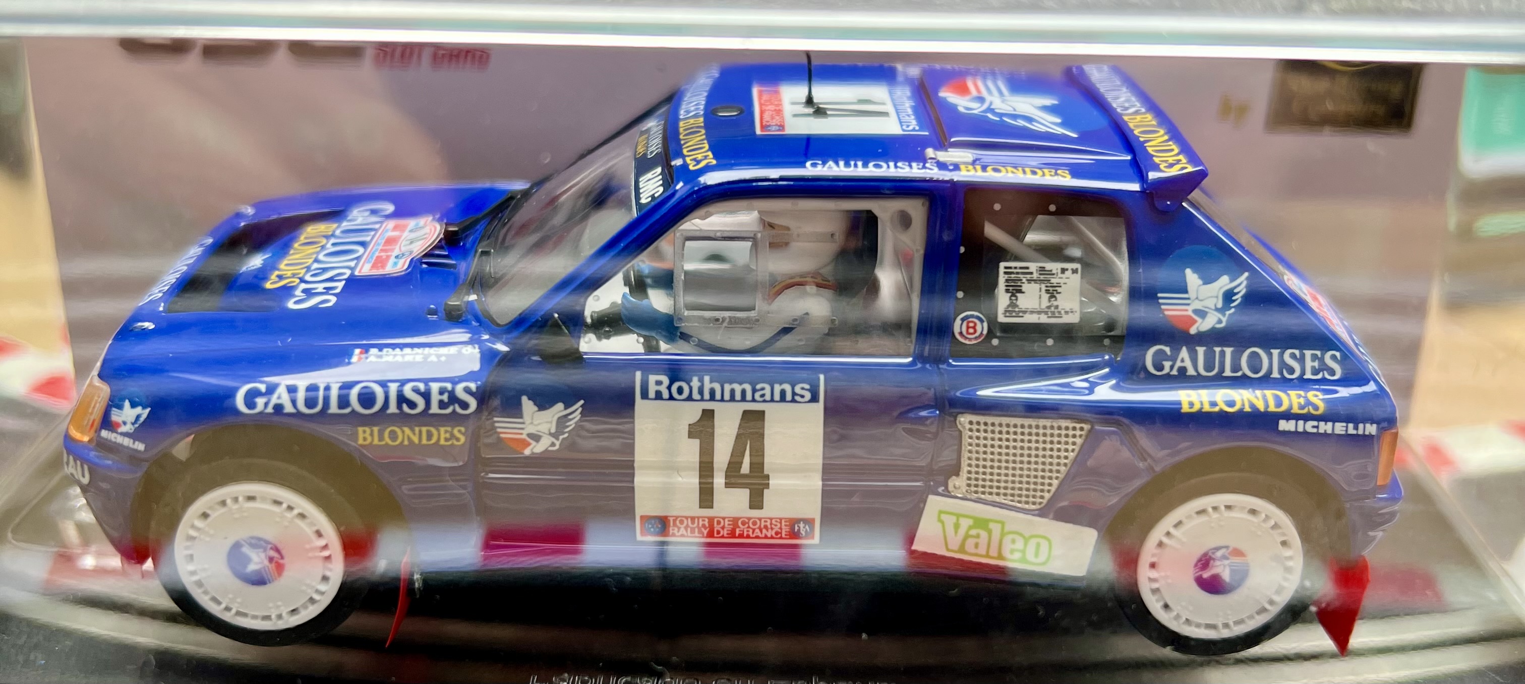

By the way: SRC does a decal set for the car driven by Darniche/Mahé at the Tour de Corse in 1985.

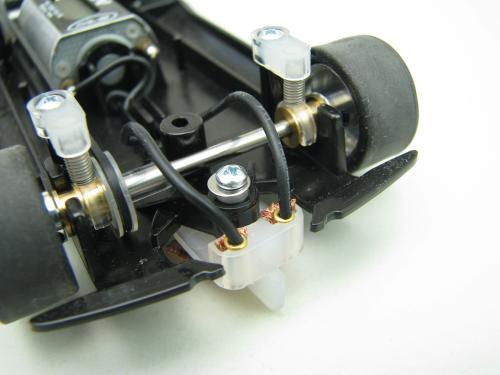

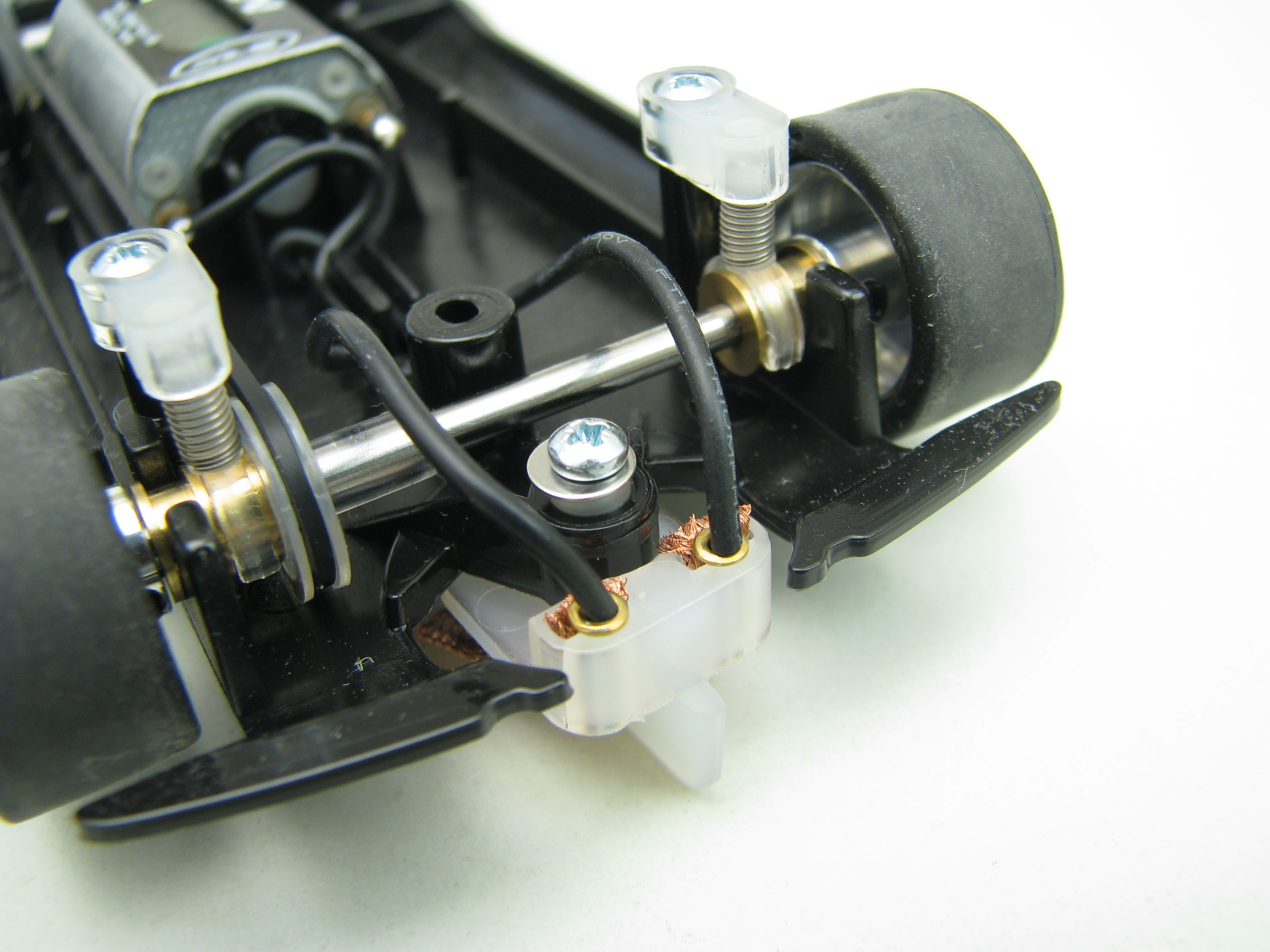

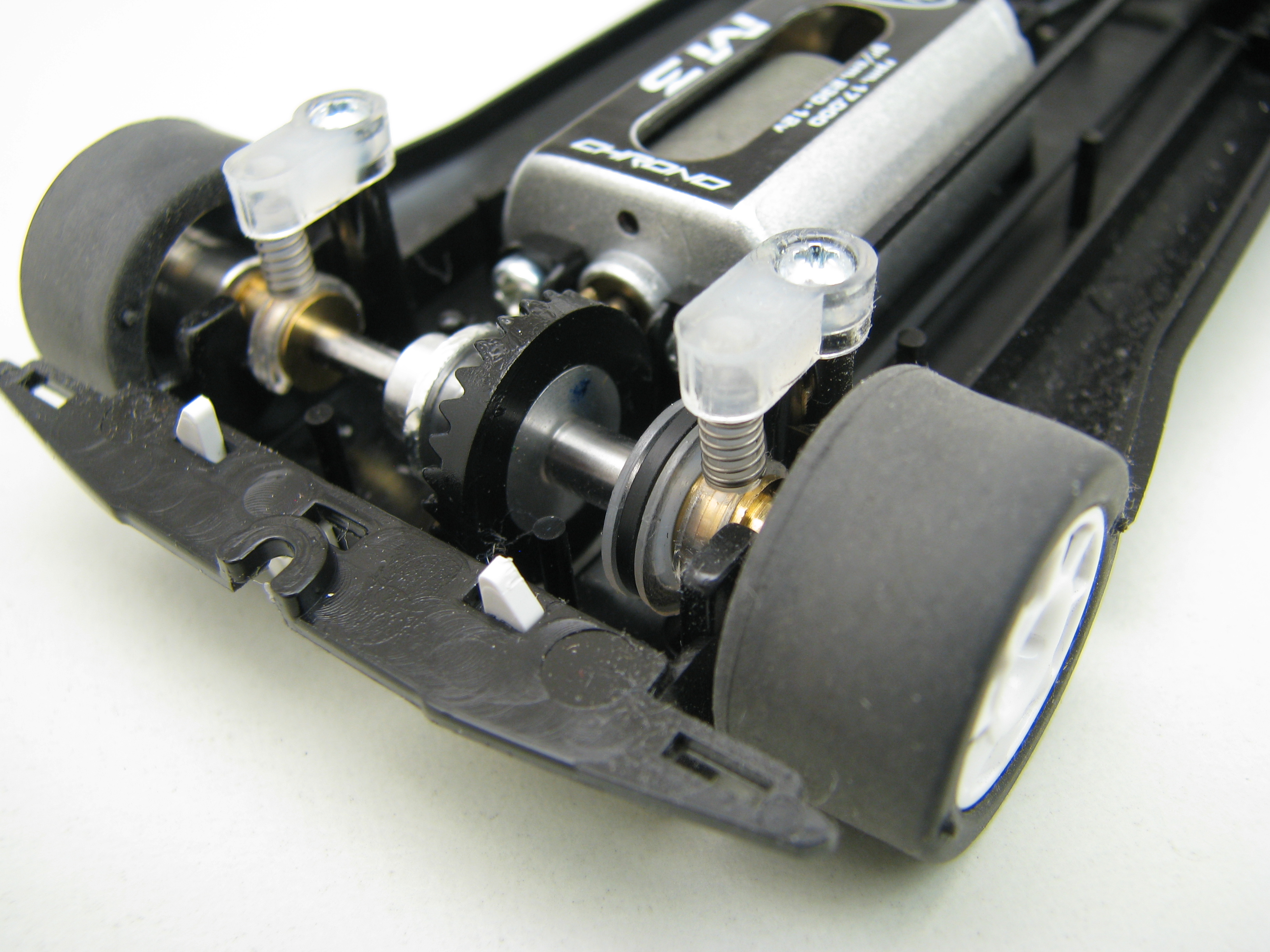

I can't really make out the suspension in the photo but it seems to me that the rear axle moves up and down relative to the motor. How much suspension travel is there ? As (apparently) axle is moving relative to the motor, is gear mesh negatively affected at extremes of suspension travel ?
Hi steveaca,
Suspension travel is about 1.5mm. In practice, the travel in the center of the rear axle, where the gears mesh, will be less.
Maybe the maximum stroke will only be achieved during a heavy landing.
The gears can handle that suspension travel.
In the photos you can see the coil springs above the brass bearings:
