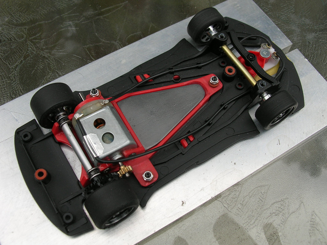

Here is a car with the MRSlotcar .25mm washers used between the chassis plate/body posts,.....these can be glued to the chassis plate with a tiny drop of CA, or, a dot of silicone/shoo goo etc.
I have also used the washers both above and below the pod lugs to "sandwich" the pod, allowing for controlled torsional flex.
[Image: DSCN4929.jpg]

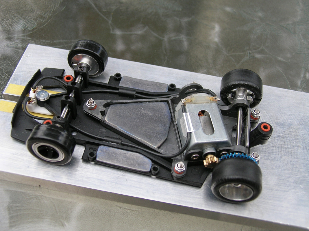

A little easier to see in this pic.,.........when adding the washers below the pod lugs and the upper surface of the chassis plate, you may need to reduce the thickness of the pod lugs themselves to maintain the original  ride height of the pos in the chassis plate............while it is hard to see, there are washers under the pod lugs/on top of the chassis plate.
The Nylok nuts/machine screws make fine adjustments possible, and there is no risk of the screws coming loose/backing out
