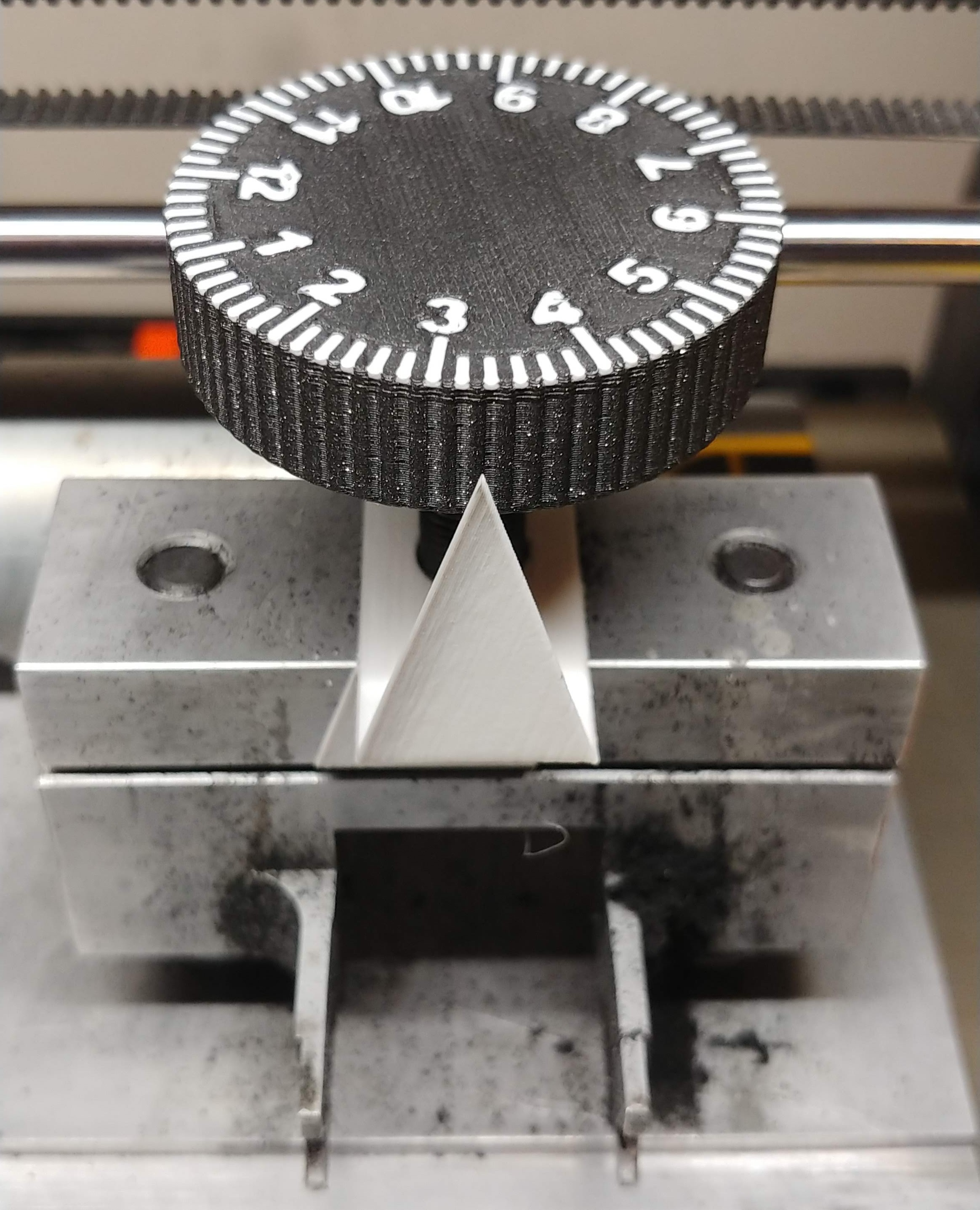

Tire Razor Indicator Knob
For more easily repeatable tire truing diameter. This fits over your existing Tire Razor knob. Hit the link for a full description of how this is helpful if it's not immediately apparent to you.
https://www.printables.com/model/412133-...cator-knob
Print your own, or PM me. $10 shipped in the states. Intl shipping extra.

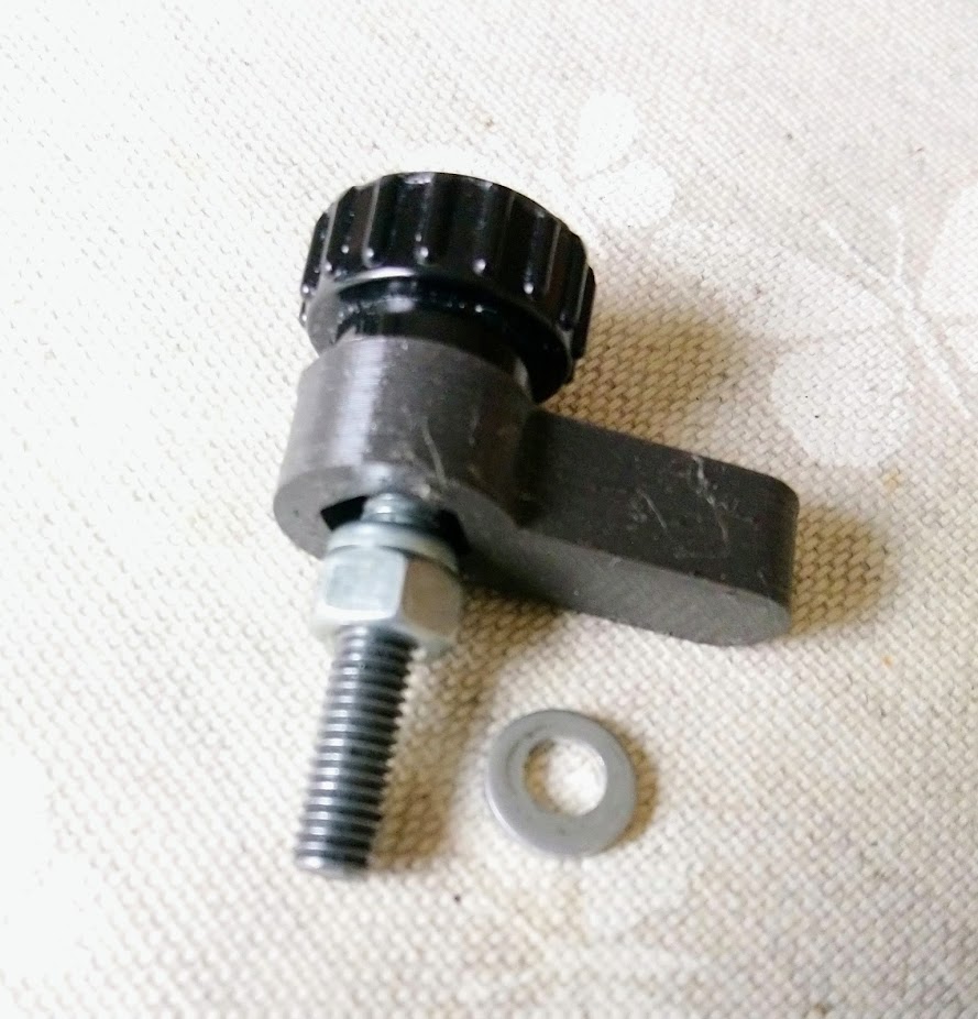

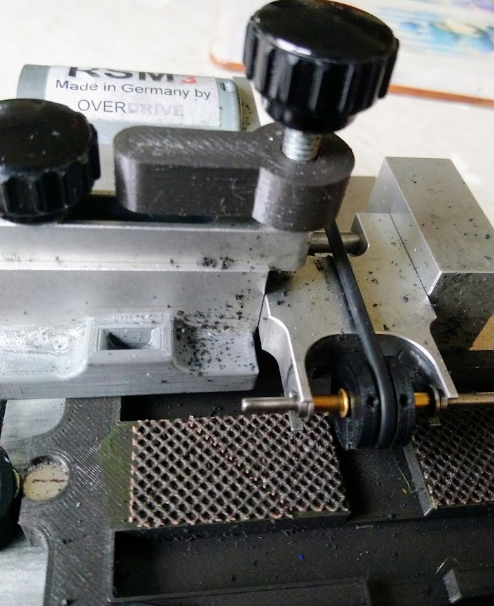

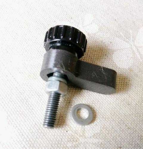

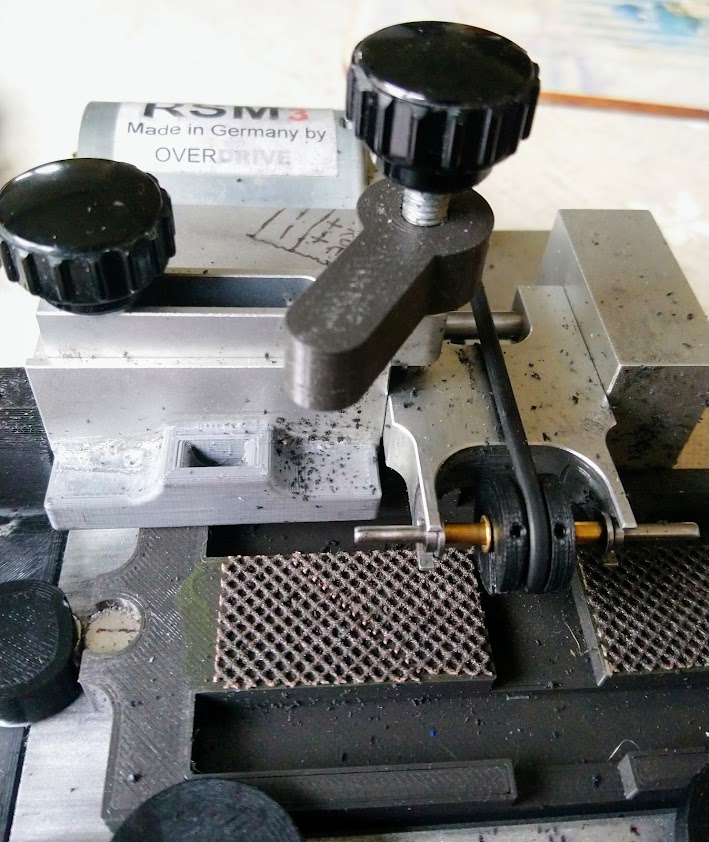

RSM Downstop Lock.
Place the downstop lock onto the thread followed by an appropriately sized Nyloc nut and washer under the nut.
Wind the adjusting handle down to the desired height with the 'lock' off
Add a small cut to the tyres and lock the handle in place
This stops the screw adjustment backing off which unfortunately is a 'feature' of these kinds of truers.
