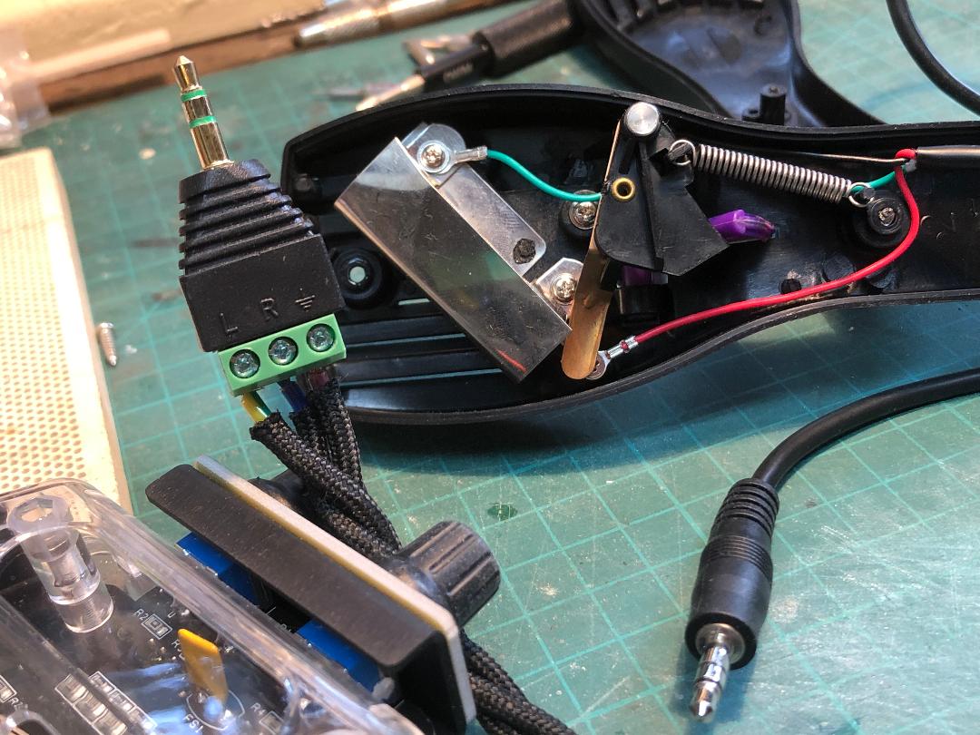

I would like to replace this large Truespeed plug with a thinner one plus I want to add to the cable length.
In my pic the truespeed wires are L =green/yellow R=Blue Earth=brown, the scalextric controller has red green and black wires.
Can someone please advise what wires connect to what when I join them up?
It is scalextrix analouge Sport track.

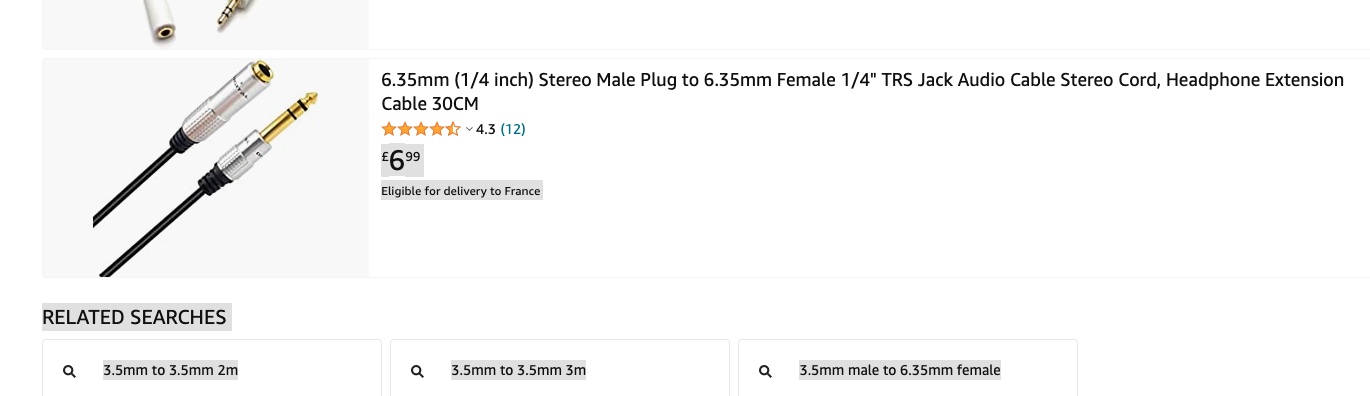

Couldn't you just use an extension cable? Then you don't have to worry about which wire goes where!
If this isn't the right size there must be one out there.

(9th-Dec-22, 02:33 PM)Gordon Steadman Wrote: Couldn't you just use an extension cable? Then you don't have to worry about which wire goes where!
I didn't even know you could get such a thing.
I'll try and find one local, not an amazon fan myself.

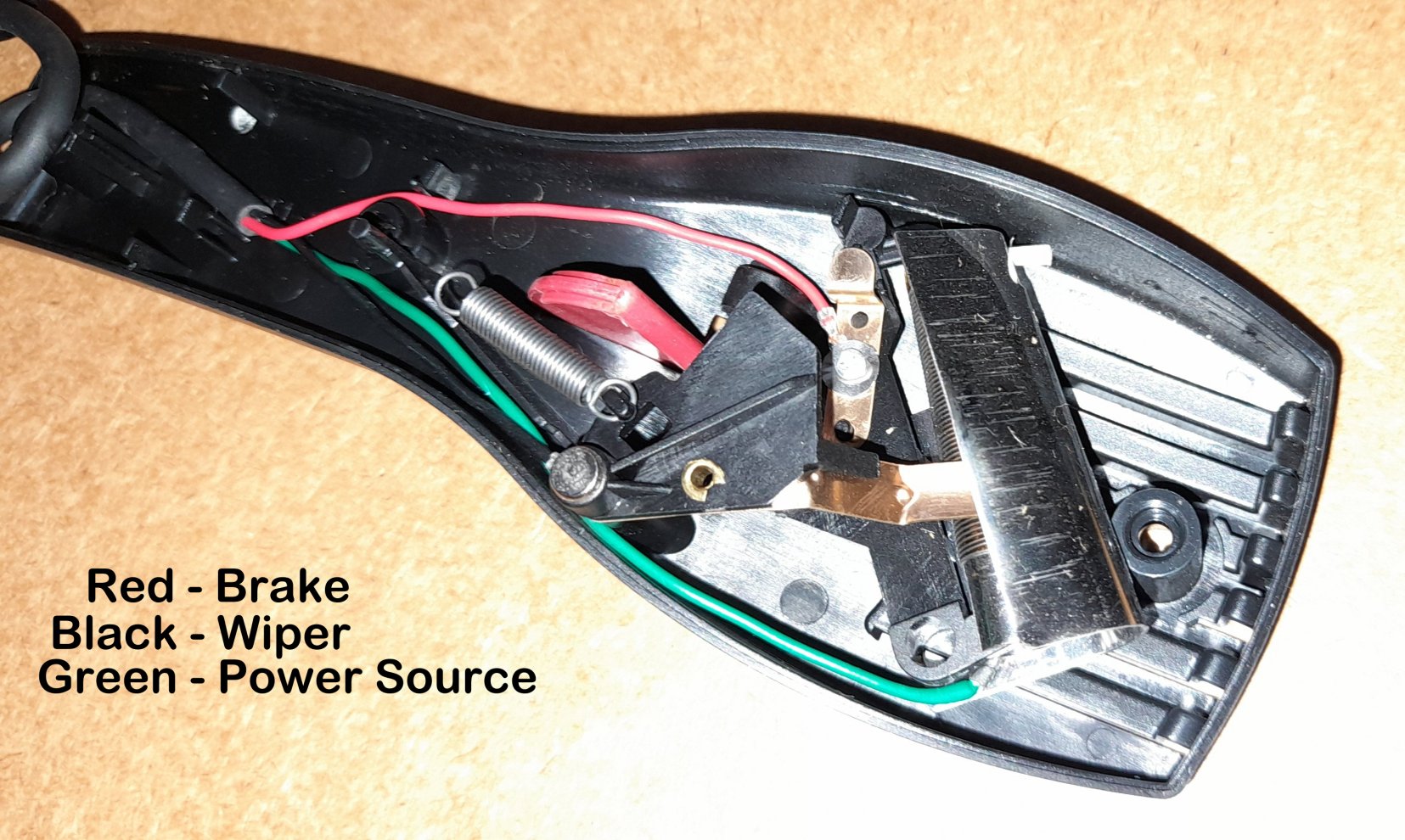

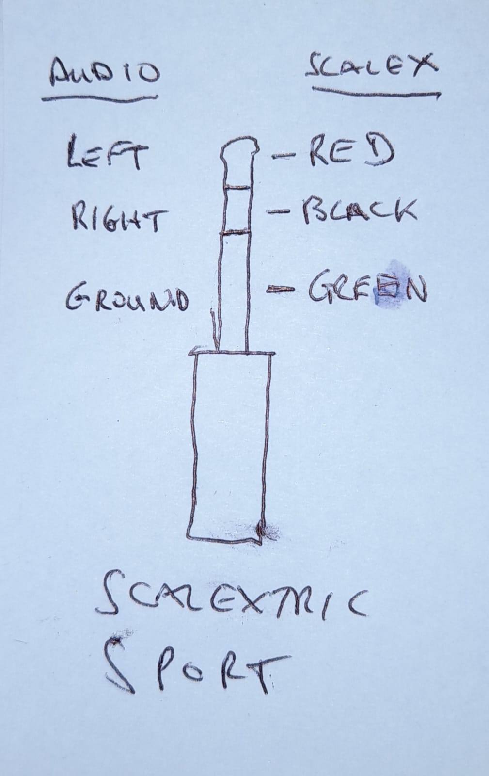

Hello Tony,
Firstly, I must say that I have no experience with TruSpeed controllers so cannot advise on the hook-up.
I just opened a Scalextric Sport controller and found the colours are used as on my diagram below and I believe that all Sport controllers are the same.
I then found via Google a diagram showing the use of the 3.5mm plug for audio and have annotated the diagram.
Obviously there is a risk of damaging the controller so my suggestion is that you contact Steve at TruSpeed for advice before deciding what to do.
Presumably the controller is an analogue type where the power to the track travels along the cables so using an audio extension with low current capability may result in a voltage drop to the rails, whereas the Sport cable is more or less "fit for purpose".

I've used an XLR extension cable without any noticeable drop in current but probably best to check as you suggest.

(9th-Dec-22, 05:48 PM)Scuderia_Turini Wrote: Hello Tony,
Hopefully someone with TruSpeed experience can chime in here.
Thanks Leo,
yes your controller you have taken apart looks exactly the same as the one in my pic.
