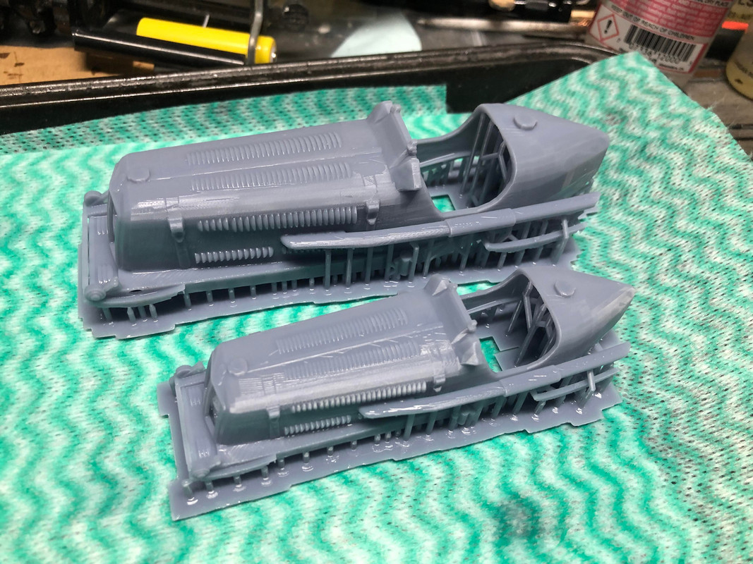

Here are the first couple of prints
This is an ERA Type B that Vlad did. I modified it by adding some details.
Happy with the outcome. Not sure it is perfect but happy with how it looks.
Printed in 1/24 and 1/32 scale
