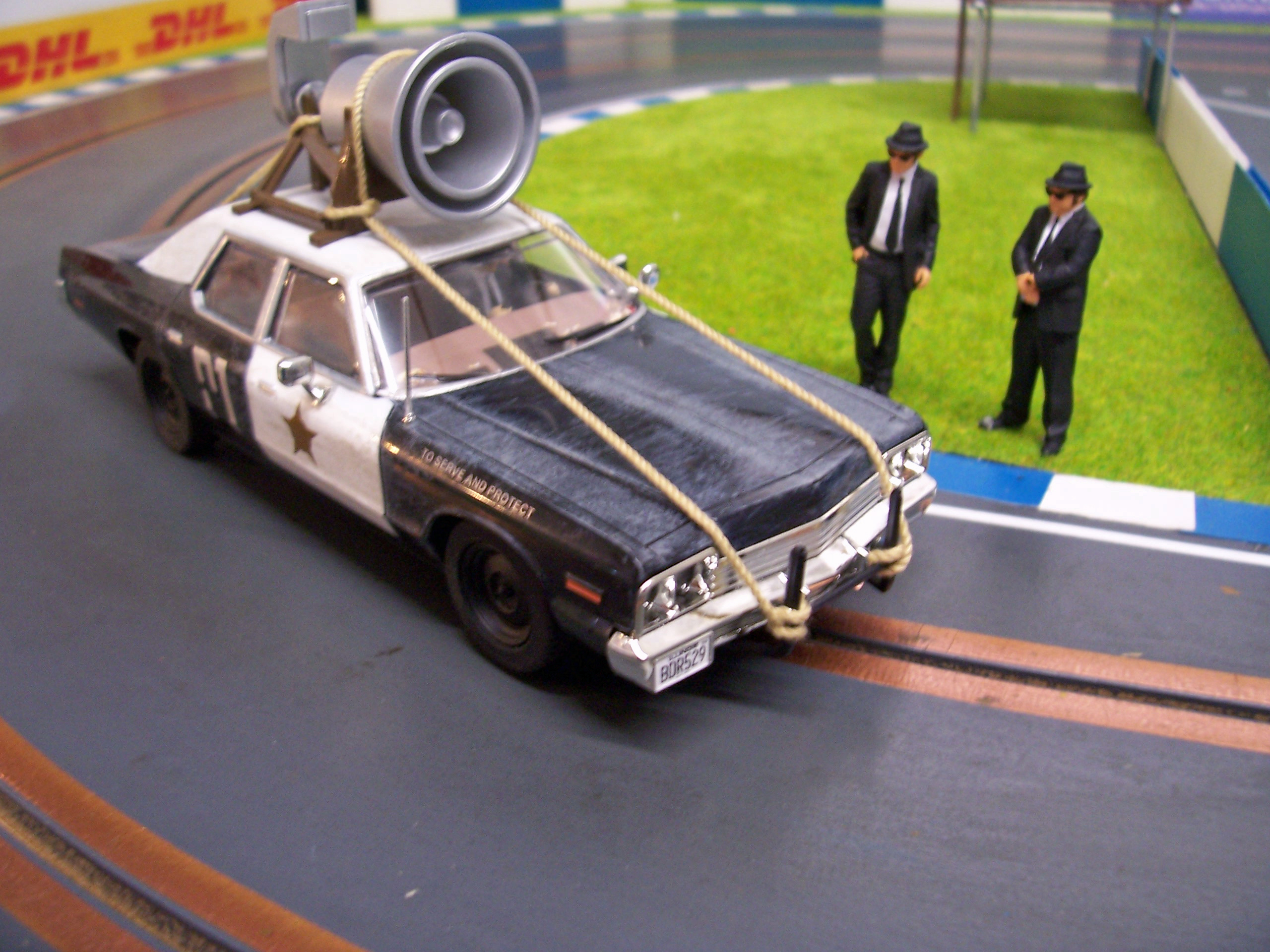

As a model

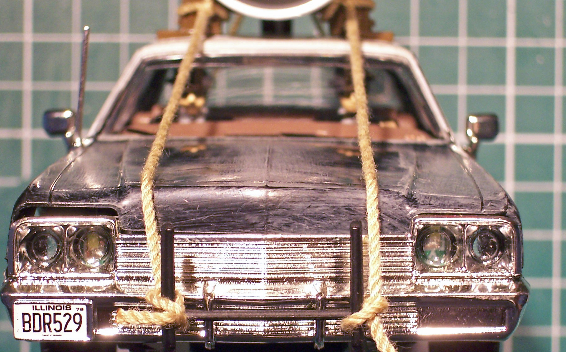

Absolutely first class, they have captured its very essence - faded paintwork, assorted debris on the dashboard with a mini Jake and Elwood in the front seats.I would have preferred it not to have the roof mounted loudspeaker as it only appears in a small part of the film but it does have a certain charm. You could remove the loudspeaker if you wish but it would need some cosmetic surgery to cover up the holes left by the glued in attachment pegs.

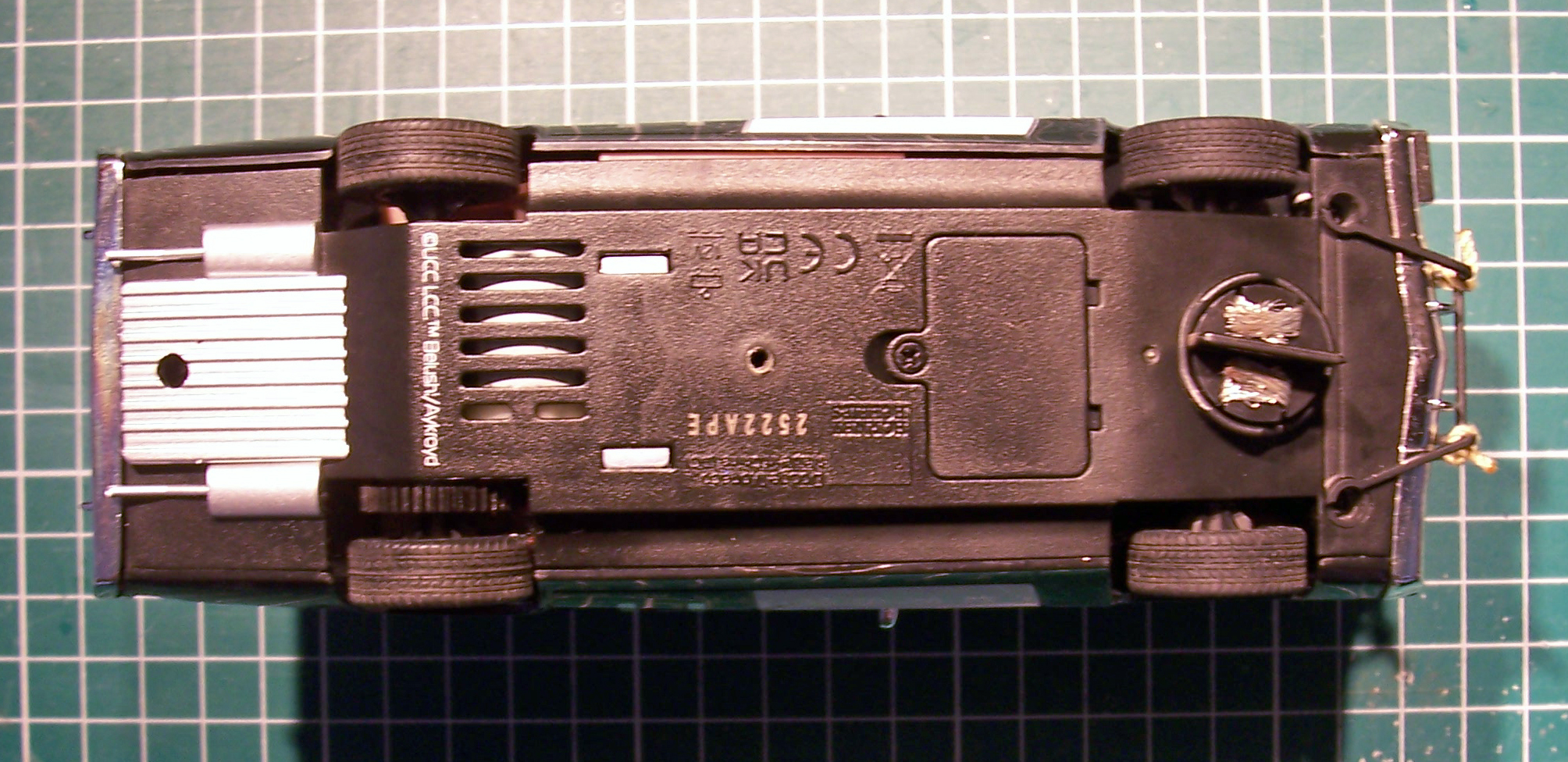

2) Rear axle bearing not fitted properly:

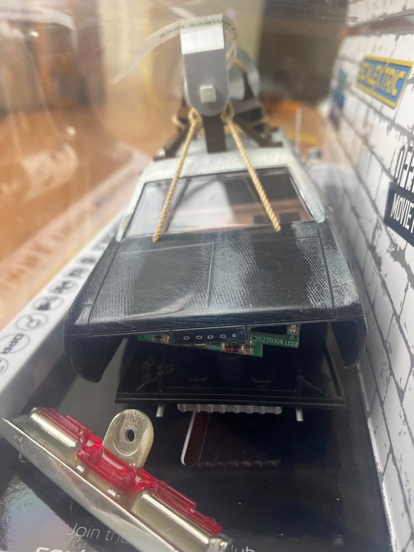

All easily fixed but nowhere near acceptable for a £50 plus car. I found an even worse example on t'internet with a car bought directly from Hornby:

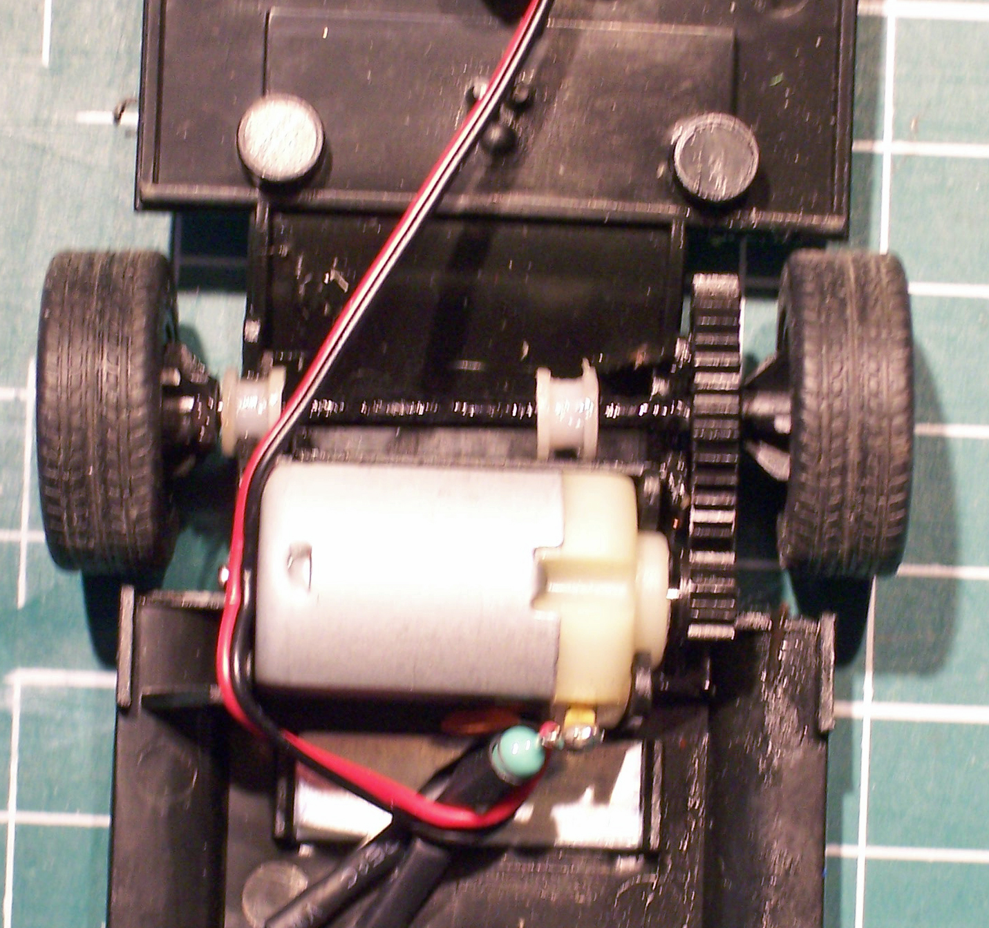

Don't be silly, this is a huge car with a high centre of gravity. The motor is mounted on its side which seems a strange thing to do. Presumably to fit in with the full interior but there is plenty of room in the rear and it wouldn't take much design skill to fit it in the normal fashion. Doesn't seem to make much difference to the performance though.

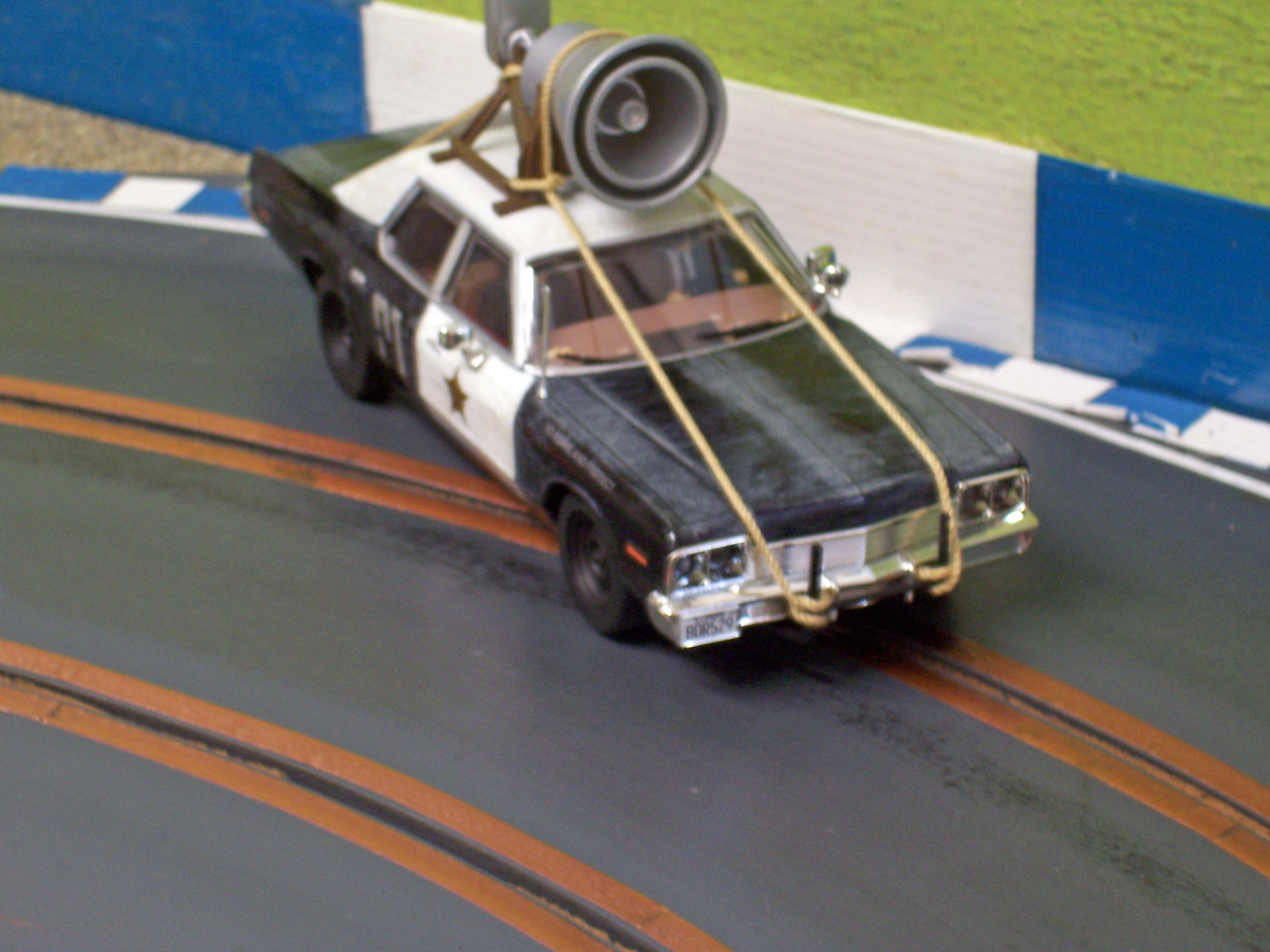

First thing to note is that Scalextric have actually fitted some half decent tyres at last with a reasonable level of grip on my wooden track, on a par with the Slot.it C1 plastic track variety. Good adhesion on the straights but still plenty of tail out action on the corners which is exactly what the Bluesmobile should be like.
In spite of the high centre of gravity it showed no real tendency to roll over which was a bit of a surprise and it would happily lap without drama in around 7 seconds on my 50 ft track which is pretty slow but much better than expected. Due to the weight it takes a while to reach top speed and even longer to slow down but normal Scalextric saloons are only about a second a lap quicker so that is not too shabby for something the size of a bus.
