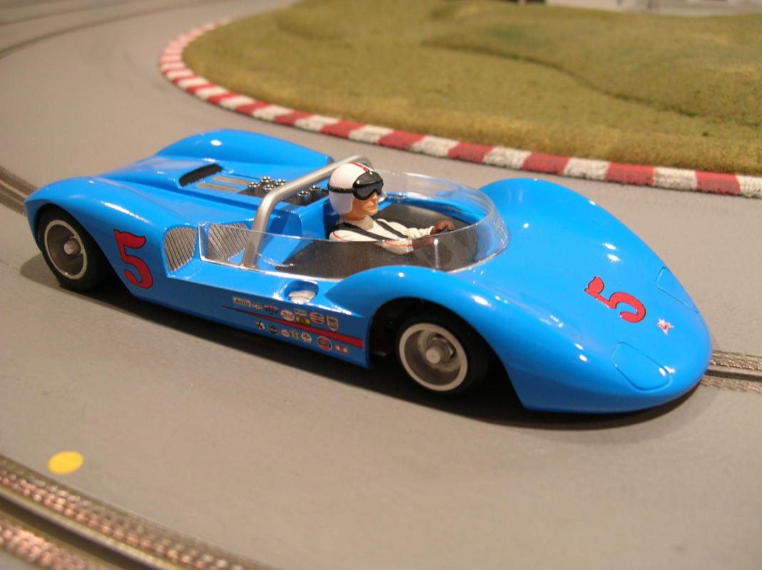

The "Classic" Industries "Astro V",......to my mind a fairly hideous looking thing, and in my opinion the most ridiculous thingie produced by "Classic".......not to say I was terribly attracted to the other 'Classic" models![[Image: rolleyes.png]](https://www.hrwforum.com/core/smilies/0/0/4/7/6/4/images/smilies/rolleyes.png)
Definitely "Land speed record" looking......and considering its launch date, it is highly conceivable that some of the "Bonneville" guys took some inspiration from this shape !!.........I took the following pic. from "Images".
