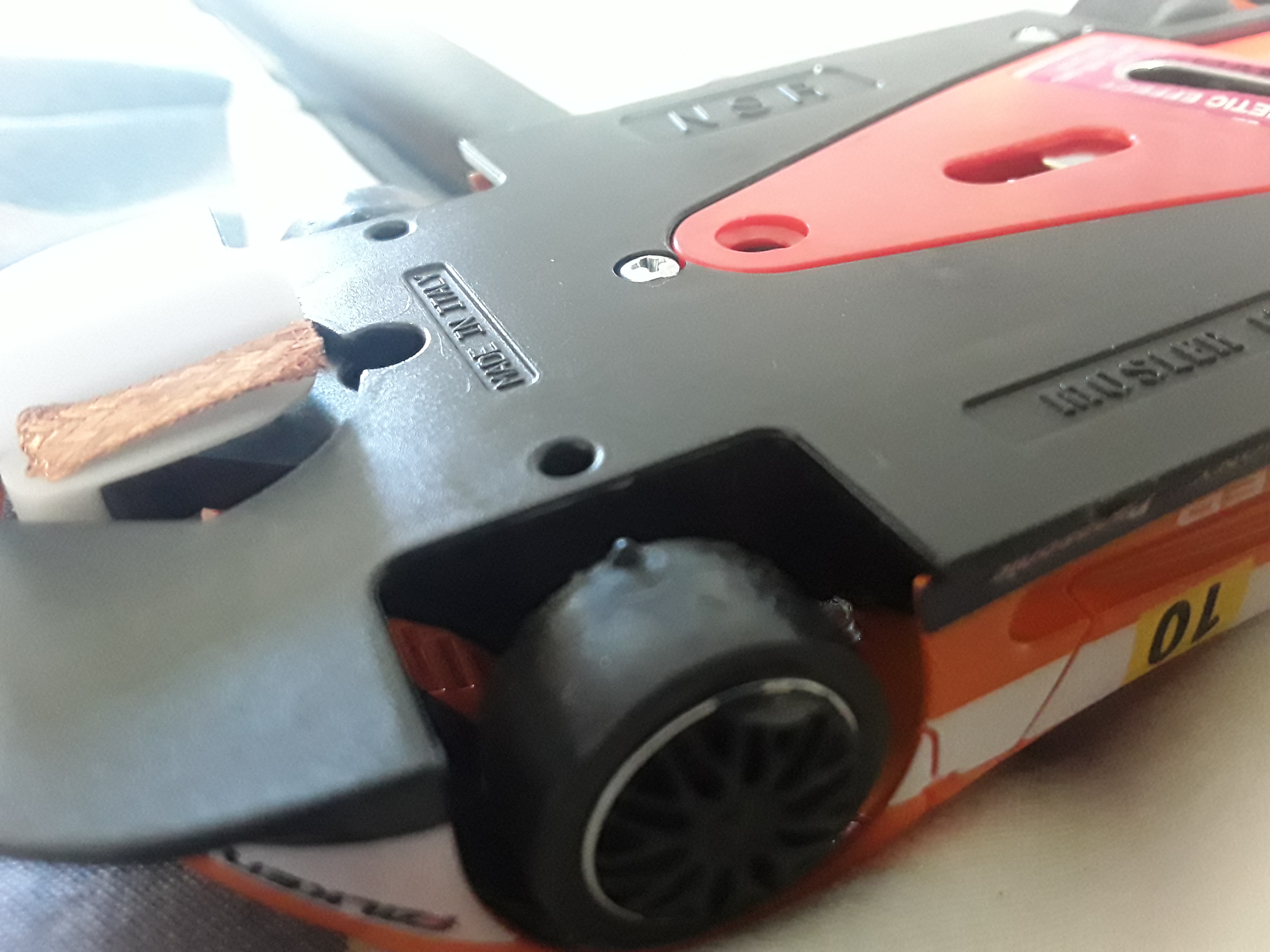

First NSR purchase for long time, Moesler from TS&T for just £39.99 hard to ignore, Slot it have taken all my pockey money for some time. I know it will eventually run well. BUT
As a seafarer I can only assume that the front tyres were trimmed by a blind man weilding an axe on a trawler mid
Atlantic in a Storm force 10. (See photo)
Some Slot It zero grips will easilly sort it, but maybe time to drop the "Ready to race" motto?
