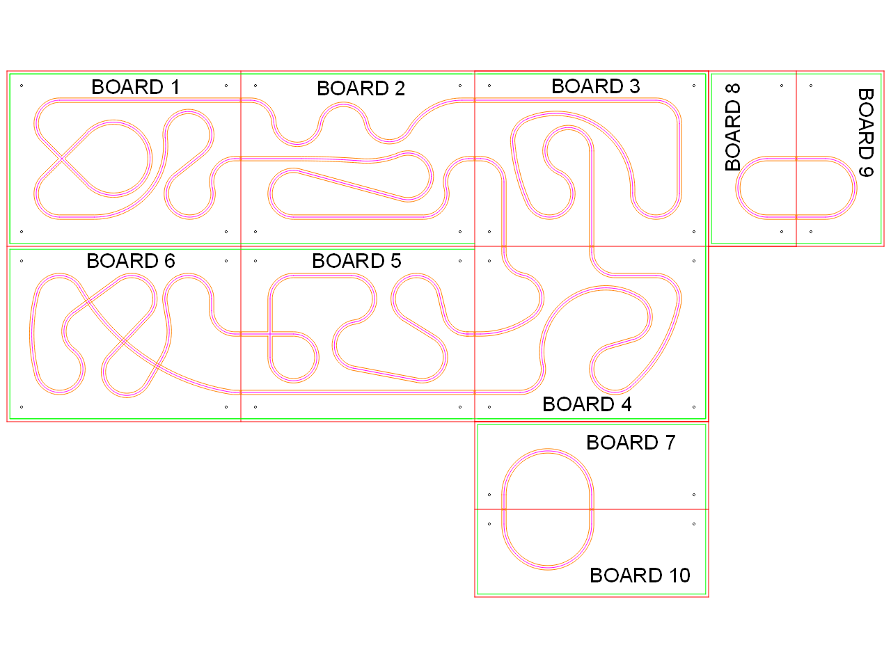

I am using a variation of the 'standard' J-Trak as the basis of a Scalextric hiring business (as yet, without any business...) but I'm already thinking about v2.0 of the modules. My thoughts turned to routed modules and instead, of reinventing the slotcar wheel, wondered if it had already been done. It looks like Jason got fairly down the routed track but I wondered if there were any further advances with it.
If I use routed modules, i would make the modules smaller, so that they are lighter, more manageable and fit in a car, rather than a van. Then I saw the post referenced above and LOVE the modules being the shape of the track. This is so much more elegant, I think, are much more manageable, less wastage in terms of mdf/whatever and scenery requirements.
Has anyone had a go at making something like this and what are the experiences, good or bad?

As far as I know nobody has made one yet.
But the techniques are much the same as building a routed club track, which by necessity involves building the track in sections, and the techniques are tried and tested.
The main differences are just that the modules in a club track wouldn't necessarily be designed to be rearranged, and also a J-Trak would normally include the out and return directions in each module.

(29th-May-22, 07:28 PM)connal Wrote: Would you be able to share you routed modules?
Unfortunately not.
Firstly, because they're all on my computer at home, and I haven't been back home in over a year. Secondly because they are presentation, or proof of concept drawings, and wouldn't be much use as a means to actually making a track, and finally because they're all produced in 3d Max, which very few people have.
If you're serious about having a go at a routed J-Trak, I could have a go at some more useful drawings, but we'd need to decide on some basic specifications, such as lane width, border width, barrier material and width, and so on.

The system I have adopted is to use the R1 radius as the entry exit spacing. It works fine for me, as I can connect pretty much any module to any other module; and I am quite happy to adopt that system for a routed track system. Similarly, I am happy to adopt the rest of the Scalextric dimensions, as this gives me a simple segue from the modules I have.
Not sure what you meant by 'border material'.
I can see the advantages of having the modules the same dimensions (as mine are currently) but I can see that there is a big saving in having them just a little bit bigger then the routed track itself.
