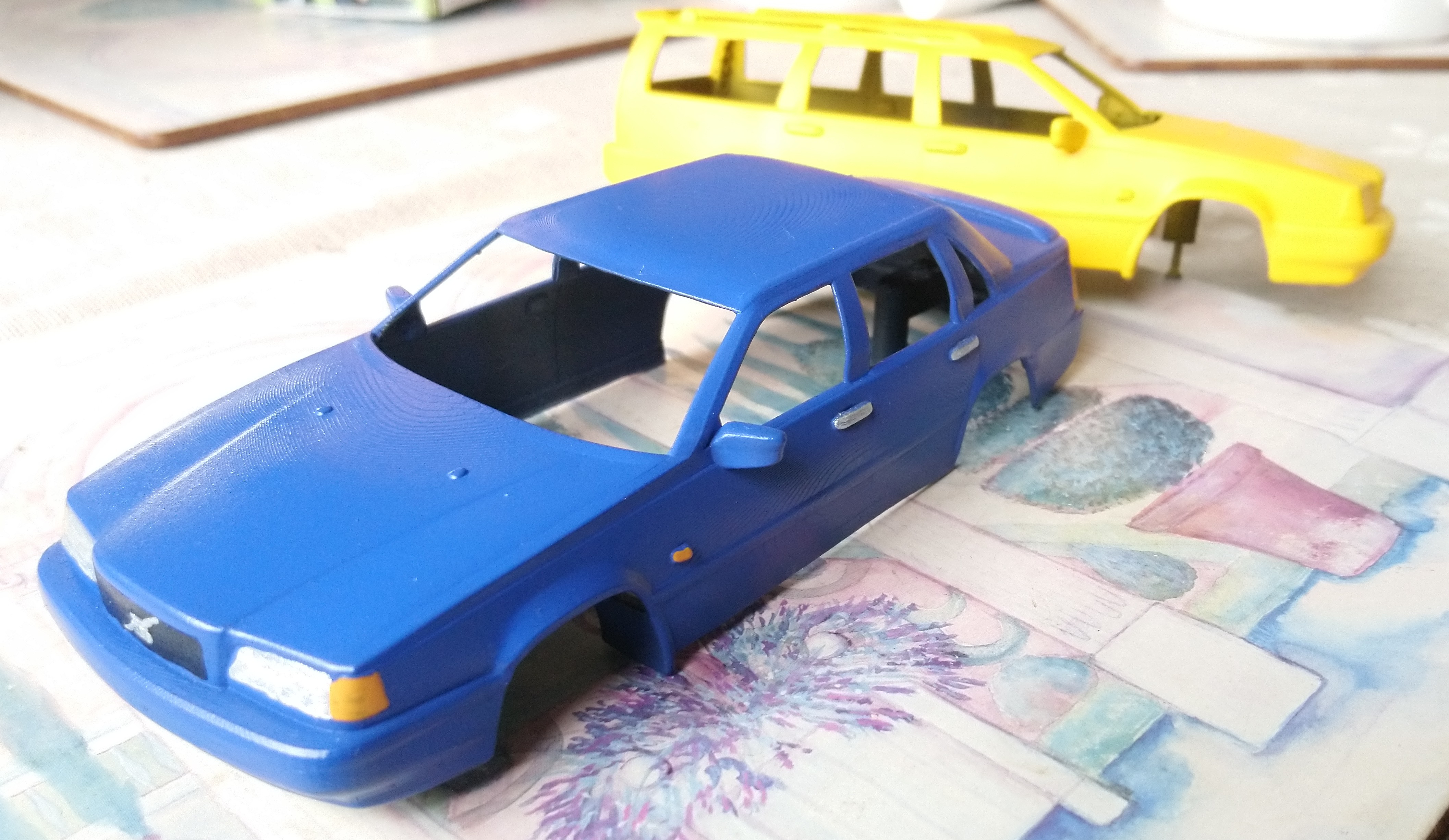

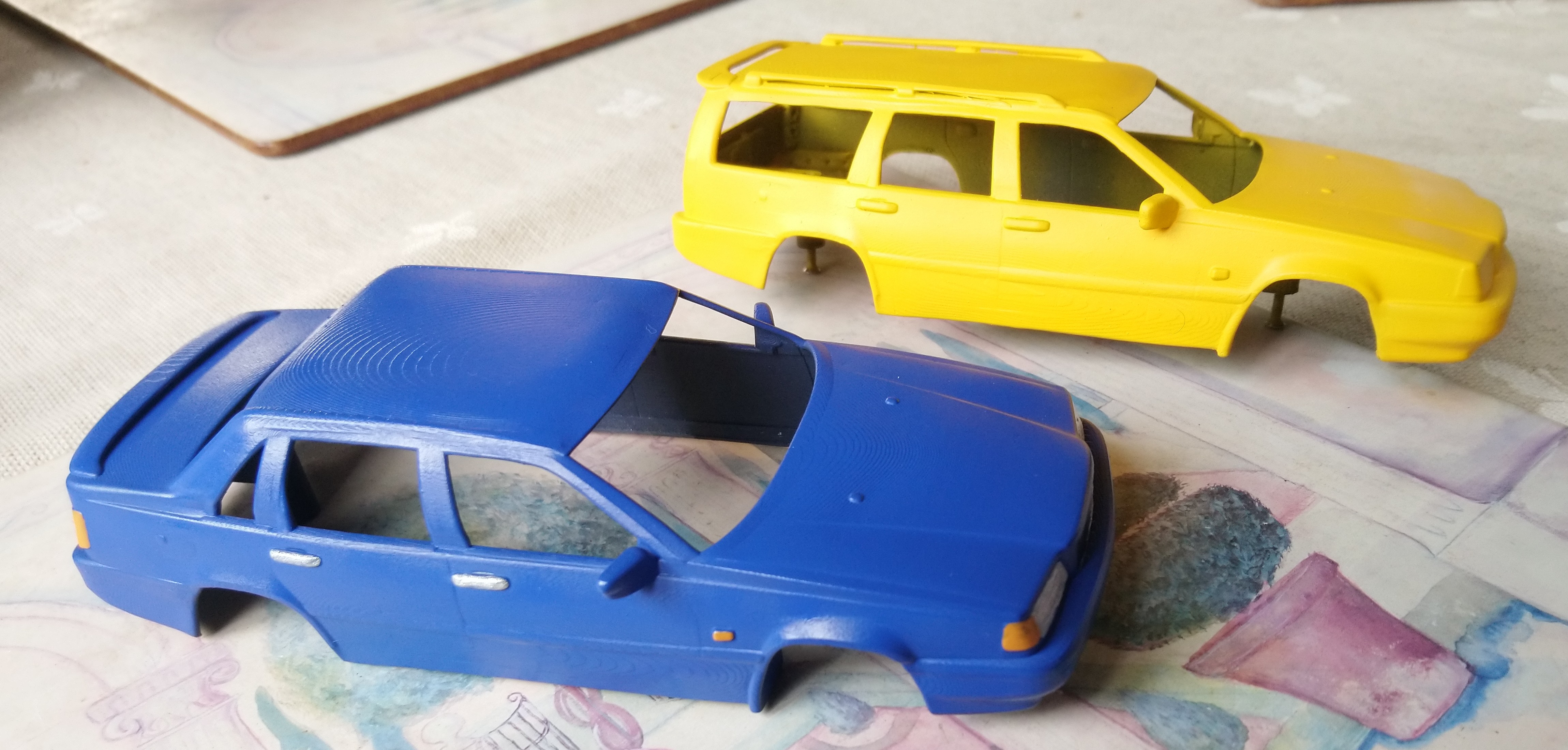

I've wanted a Volvo rally car for a couple of years, the scx ones look OK but always seem to sell for silly money....so let's print one.
Estate or Saloon...best doing both.
Both bodyshells fit the same chassis, one specifically drawn up and printed for the purpose. Slotit IL pod and NSRs with a shark 25.
The blue one will see Rally stages, the estate will probably race in saloons.

The yellow one had a run round our Rally stage last week before the event started...it flew round so really looking forward to finishing it.
Driver & navigator are printed, windows are always a pain but ho hum and Rally plates are easy to do.
Because the estate doesn't have anywhere easy to mount the rear body post (I prefer one in the middle front/rear) I drew up an 'L' shaped one that's glued to the back end and it seems to work really well so the saloon had the same.

Was that in plastic ? The body does not look quite as smooth as the resin prints I have seen of yours.
Not a criticism, it looks great, just an observation.

It's resin printed but at 40um rather than the 20um layers I've printed in recently. Printing a bodyshell in 20um layers takes twice as long, 8 to 9 hours and that's on a mono printer which are fairly quick.
