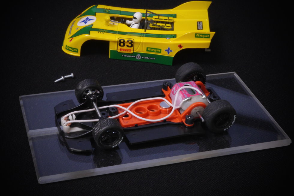

Put it on a setup plate, if you haven't got one make one, then have a look under the car.
Digital lane-changers do have a tendency to catch any low-hanging parts of a car. A set up plate like this...

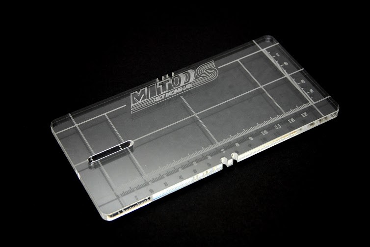

... is good to have - it's very flat and you can see through from the underside to find out what's going on. That Mitoos one is the cheapest Pendles sell here. Mine is a simple 9x17cm piece of 6mm thick clear acrylic - with a 4cm slot cut into the front short side and all the edges smoothed off (they can be rather sharp!). Here it is in action...
An alternative is to take a piece of track - which is never as flat as a piece of acrylic - but you can hold it all up to the light, have a look between the track and car and see what might be catching. It could be the gears, so have a long end-on as well - to see the areas obscured from the side by the wheels.

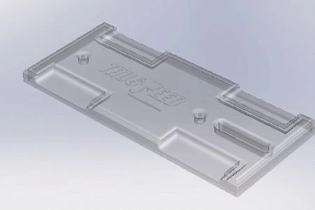

A cheaper alternative set up plate is available from TruSpeed. LINK
It can be combined with their Display/Holder to give a neat storage item which keeps the car's tyres off it and prevents flat spotting. LINK
At just £6 the pair (plus p&p) they are excellent value.
