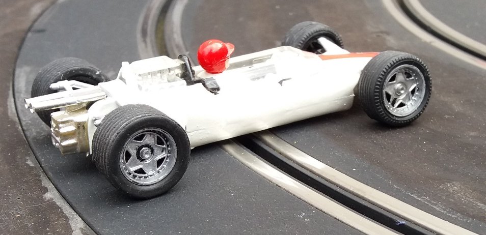

If you just want it to look pretty... I fitted two metal ferrules (large versions of the things that we use to hold the braid-wires in place).
I drilled holes for twin and earth type copper wire then glued them in and then the ferrules over the wire.
If you want, I will send you a couple of the ferrules.
The carburettor intakes are part of the screen aren't they? So special to the C82.
I gave up trying to get reliable running so I cut the pin off the guide/axle...

That looks great! Love what you've done with it so yes please to a couple of those ferrules.

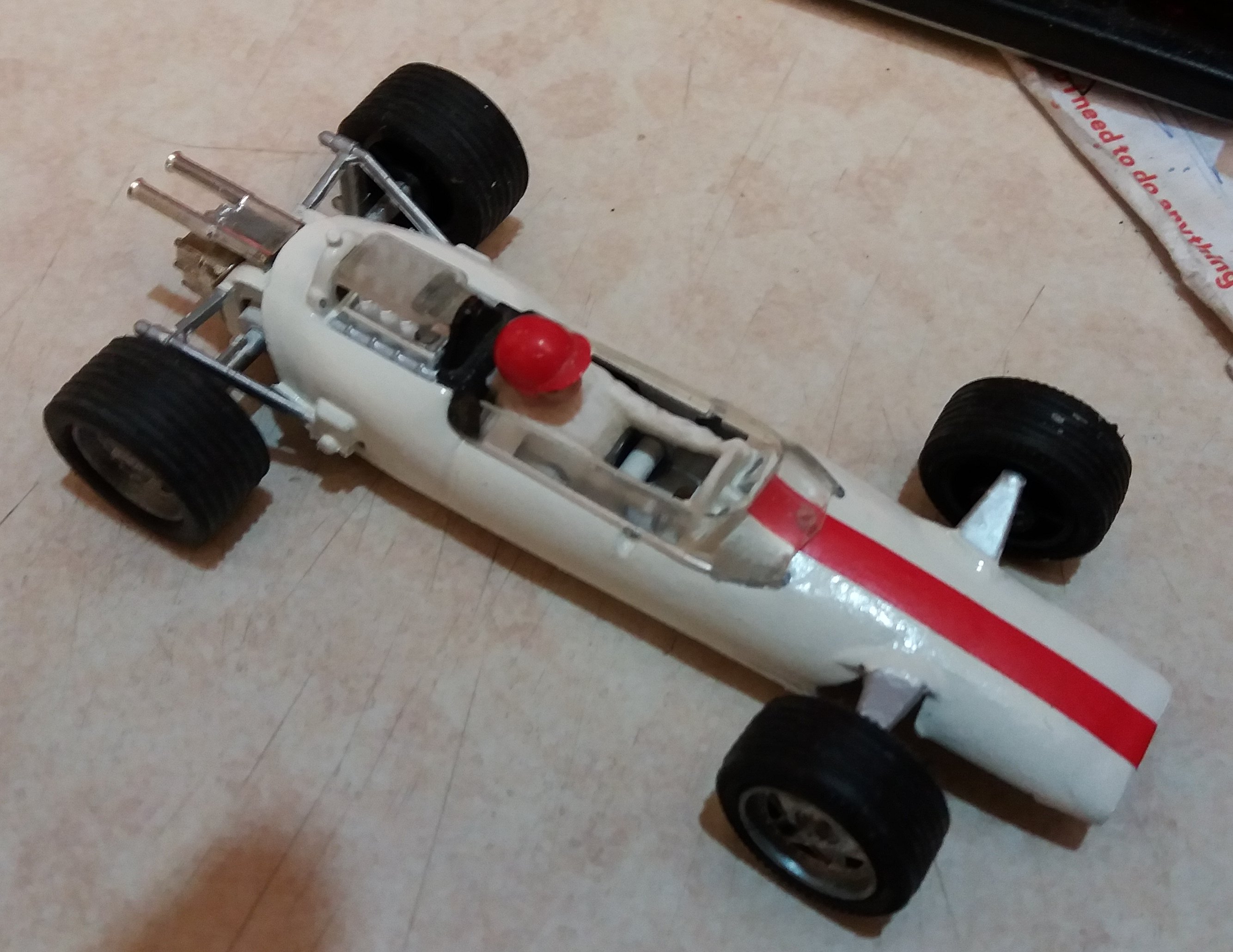

The one I have is complete and original other than one broken exhaust pipe, a cracked screen (which actually is such a clean break it isn't noticable) and there's something missing from the steering arm/guide.
It operates the steering as it should and holds the braids - but nothing reaches into the slot. I don't know whether the bottom of the flag has worn away/broken off, or whether there were one or two rods which came down from it to engage in the slot and they have worn away or broken.
It runs strongly on a PP9 battery but I won't know whether that will translate into decent performance on the track until I can fix the guide.
What wheels and tyres did you use - and would it still run with those if I did something similar?

For the car above, I replaced the front axle with a standard metal one simply glued in place. So fixing the new wheels was no challenge. They are the five-spoke star type wheels from the 90's Scalextric cars. Replacing the front wheels on the standard axle unit would be fiddly and at the end of the day, these guide units were always too floppy for serious use.

'Mine' has a very short 'keel' between the braids, about 1/4" long and maybe 3/16ths deep, at the front of which appears to be the stub of that pin you're talking about. It's so short that on a flat surface all four wheels touch the ground and rotate if it's pushed along.
Sounds like I need a steady hand to drill down that stub - no, on second thoughts I might shorten the keel from the front by the dia. of that stub then drill and insert a plastic coated metal rod I have which, if I can find it, should be just about the perfect size
Since this was left on my doorstep 'gratis' in a boxful of old Scalextric track it owes me nothing - but I feel I owe IT a chance to run under its own power again
I can see how the rear end of the body separates but how does the front of the undertray unclip so I can fix the steering please, or should I just pop the steering out? I don't want to force anything and break it.

Perhaps the front tyres are too large?
I am away from home for the weekend now so can't measure one of my standard cars
The lower body section just pulls off - best to lever it gently with a thin blade.
Yes the steering unit just pops out, again, lever it gently.

Mm? They LOOK original - but maybe they aren't?
