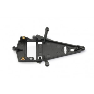

MRslotcar fc130 sidewinder pod MR2114
29th-Nov-21, 03:34 PM
Sidewinder pods for FC-130 motors have not been produced to date..............any reference/pictures etc. stating that the MR2114 is a FC-30 sidewinder pod are incorrect.
The pic. you have posted is a ff-050 pod.

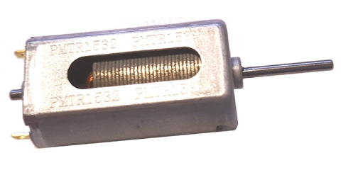

I suspect this slimline would...https://www.professormotor.com/product-p/pmtr1532.htm
...Chris can tell you everything you need to know about that motor.
30th-Nov-21, 02:59 PM

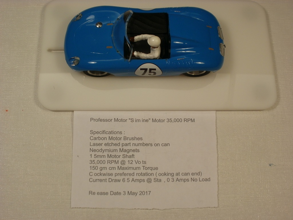

I have a few of those motors. They are not expensive.
Chris helped me gear it correctly, and says it's a nice, fast, motor. But Chris can also drive insanely fast cars. I can't yet.
It's way too much motor for me. I don't enjoy driving the car. You can't blink, or the car is off the track. I rarely drive it.
Note the current draw. You'll have more than enough brakes if you can deal with the speed.

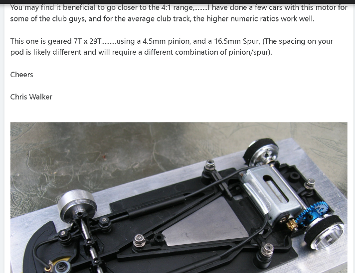

Hi Tater06,.....how long/tight/twisty are the tracks you run on ??........I built the attached chassis 2 years ago for a proxy that allowed a 25K FF-050 motor or, up to a 22K FC-130. The tracks were all shortish club type tracks, and this car won the first 3 rounds..(the proxy was cut short due to Covid).
This is a Policar FF050,.....which will bolt right in to the MRSlotcar sidewinder pod....they do work well geared high numerically...this one was geared 9 x 32.
If you are running on longer/faster tracks a 25K FC-130 may well be the better option.
