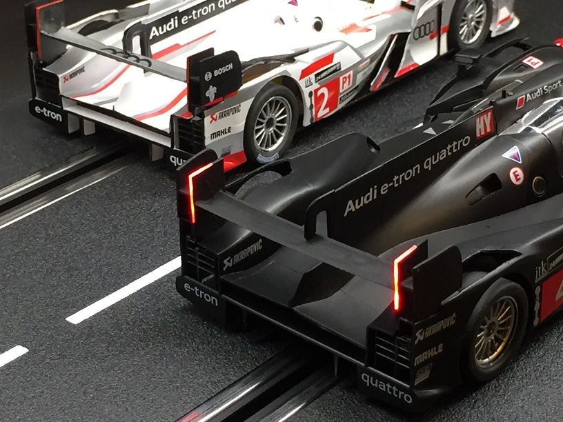

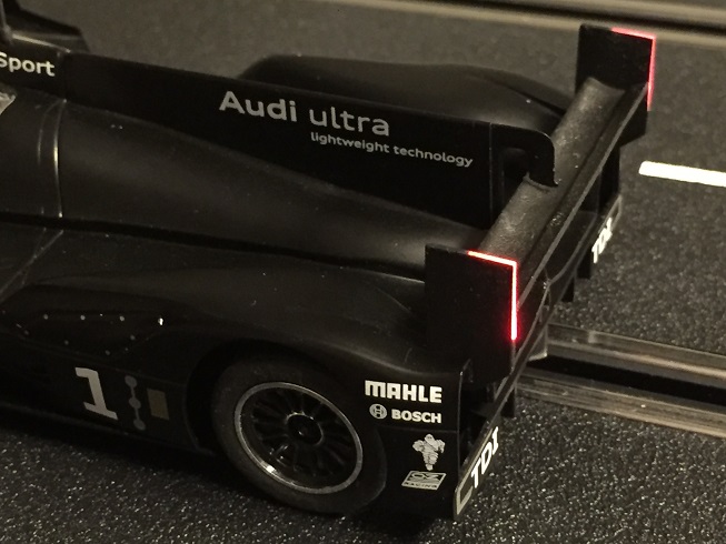

Some years ago I tried to make working wing lights on Slot.it's 4WD Audi e-tron quattro R18.
First using the original non-transparant wing. That turned out to be too weak...

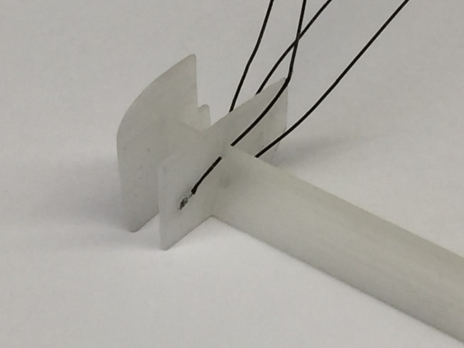

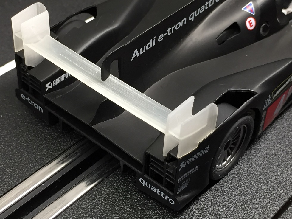

Then I drew a new wing and had it printed by Shapeways (
https://www.shapeways.com/) in a transparent material.
That material turned out to be too brittle for the hard slotcar life...
Now Shapeways has a new material. SLA Plastic - Accura® 60.
I hope this transparent plastic is stronger than the plastic from my first attempt. Anyone familiar with this plastic material?
One of these days I hope to get a print in the new material.
To be continued...
The printed wing...
2 small LEDs on each side of the wing...
The end result... (no lights on the left car)

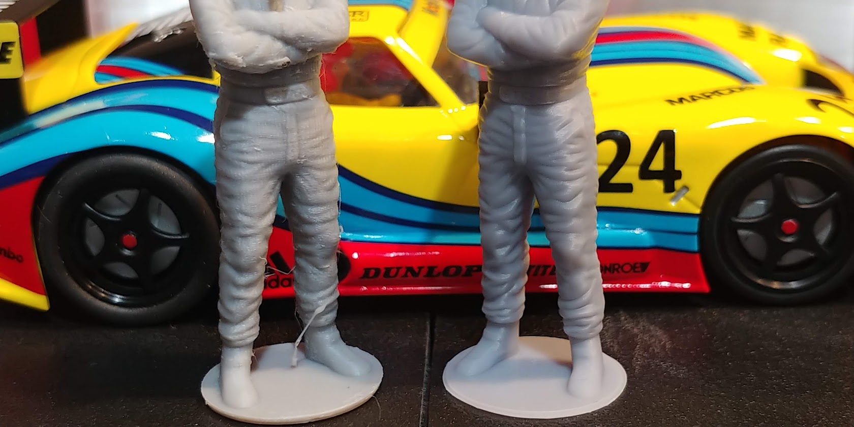

Prusa starts with quality hardware. That's why they are more expensive than printers of a similar "i3" design, such as the Ender 3 and others. What you'll find is that Ender users are often purchasing replacements for things that wear out quickly, or are of lower quality (which shows in their prints), or to add features that are lacking on their machines. There's nothing wrong with those machines, and they can produce high quality prints without too much fuss. I'll put it this way... I've never seen a Prusa owner switch to an Ender and be happy... but I've seen plenty the other way around. No, cheap clones are not just as good. I have two machines because one wasn't enough to fulfill orders/requests in a timely manner. Both machines tend to be printing more than they are dormant, and they have been solid workhorses requiring little to no maintenance or repair.
You can get some great quality, with very thin layers, out of filament printers. That said, if you want high detail with little to no visible layering, then a resin printer is the way to go. There are pros and cons for each type of printing, but detail is where resin really shines. Here's a comparison between prints of the same model (the stig) at exceptional quality on my Prusa (left) and normal quality on my Elegoo Mars (right). Neither have had any cleanup or post processing of any kind. These are straight off the printer (or curing machine).

Thanks for the clear answer, just a pity that I can't display the photo. Maybe an error in the link?
