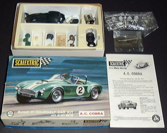

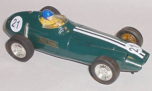

1966 ‘Race tuned’ cars and controllers

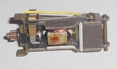

The plastic cars introduced in 1961 after the Triang takeover utilised the venerable RX motor from their existing model railway locomotives. This was a good solid product with excellent torque which would pull a heavy engine and rake of coaches with ease but was never built for outright speed. Accordingly, in 1966 the motor was given a rewind for better performance, with black side plates rather than the standard silver and the ‘race tuned’ series of cars were introduced.
    Standard RX motor
Race tuned version
 Most of the range was available in both standard and upgraded form. Apart from the faster motor the new versions were also fitted with a proper guide blade instead of the original pin, softer tyres, a race tuned sticker and the obligatory 60’s accessory – a go faster stripe! A new 25 ohm controller (#A262) was also provided for these cars which had the added advantage of being wired for dynamic braking.
They were a great improvement over the standard cars with a nice turn of speed and good handling characteristics for the time. They sold very well, are still widely available and amongst the best performing cars they ever made. A couple of kit cars were also available in the range (Cobra and Porsche 904) with two differently geared rear axles as well although these utilised a Johnson large can motor instead of the RX.
Unfortunately, within a couple of years, Scalextric started to apply the term ‘race tuned’ at random and many of the later cars were anything but. Even the abysmally slow powersledge cars were promoted as such.

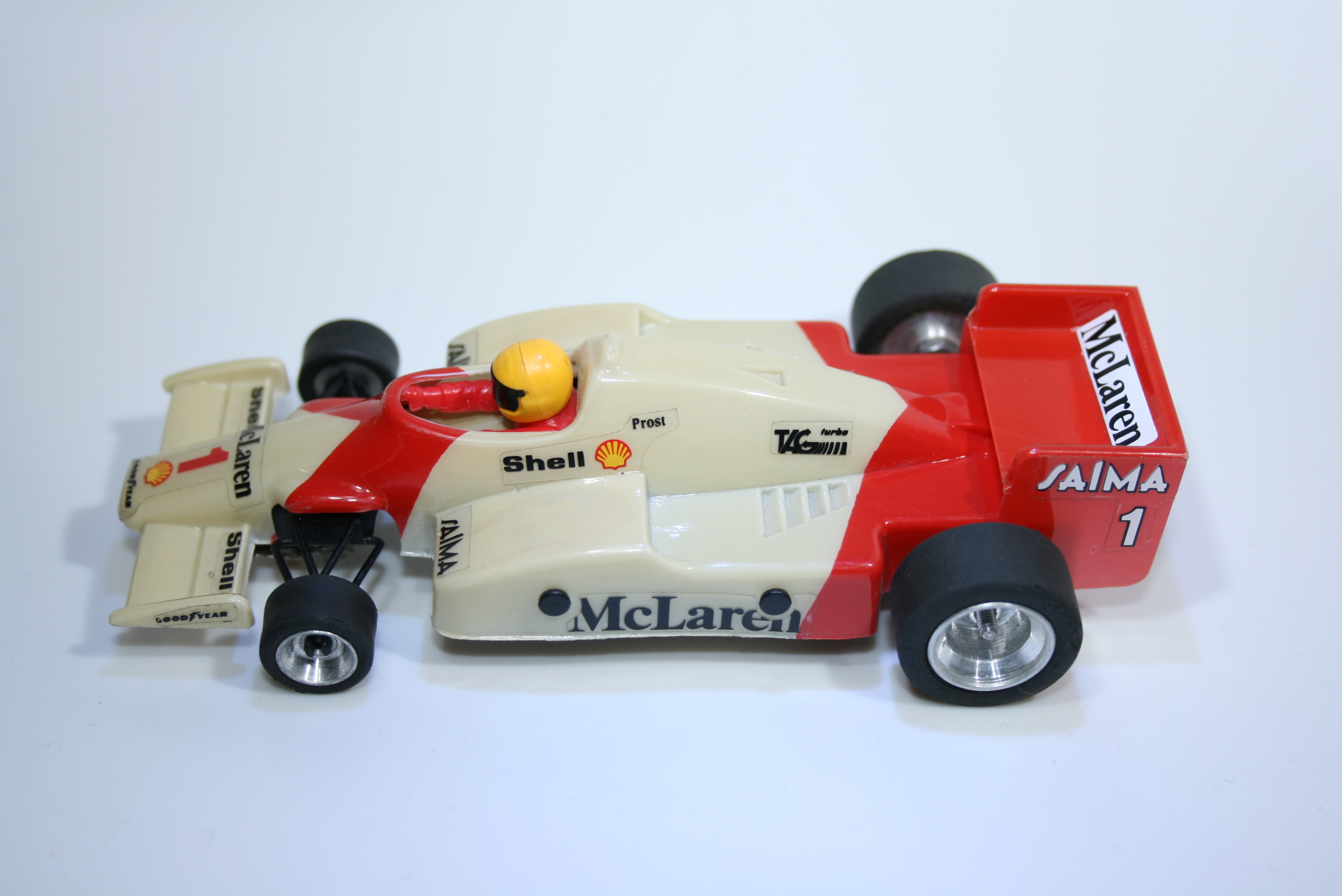

1988 Spanish Scalextric SRS
A few of these Spanish made, ‘super racing system’ cars were imported and sold by the UK firm. They featured a lightweight, factory painted Lexan body, three different axle sets, upgraded RX motor and sticky tyres so performed extremely well but weren’t very accurate models. They didn’t really catch on and were soon discontinued.

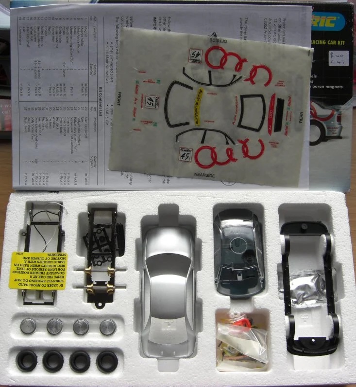

1999 Protec
These were kit cars aimed at club racers. Standard bodies were used with metal chassis, 3mm drill blank axles, brass bearings, alloy wheels, three axle ratios and a higher performance engine which needed a special power supply. Just two cars were available – Vauxhall Vectra and Audi A4.
Scalextric ran a Protec race championship at various clubs but the quality of some of the  kit components were a bit rubbish so the system only lasted a couple of years. I have lifted this photo from MRE’s Facebook page which features a very young Gary Cannell and Sean Fothersgill at a Protec launch event.

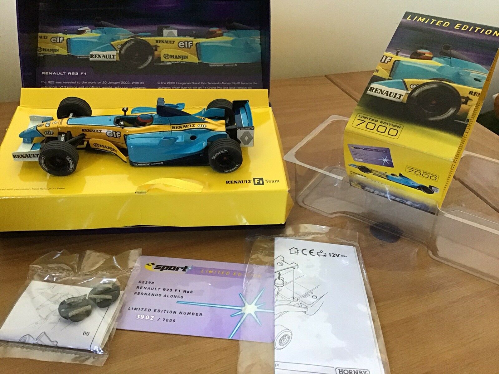

2002 The Sport range
Apart from a new track system to replace the ageing ‘classic’ type, Scalextric applied ‘Sport’ branding to many of their cars which implied they were a new version of the 1960’s race tuned variety. In reality they were nothing of the sort. They did have metal axle bearings, ground axles and a Sport sticker on a bog standard Mabuchi motor but any performance improvement over the standard version was marginal. They really should have been named ‘collectors issues’ as they were limited editions in a fancy box and most of them ended up in display cabinets rather than on the track.
Incidentally this was also the time when magnets gradually began to dominate their design philosophy. Although they had been fitted to most cars since about 1987 they were of relatively low strength. The new Sport track had considerably less grip than the original version so stronger magnets were fitted to overcome this. Eventually they ceased to bother about basic slot car design principles and just bunged in ever stronger magnets to hide their product’s shortcomings.

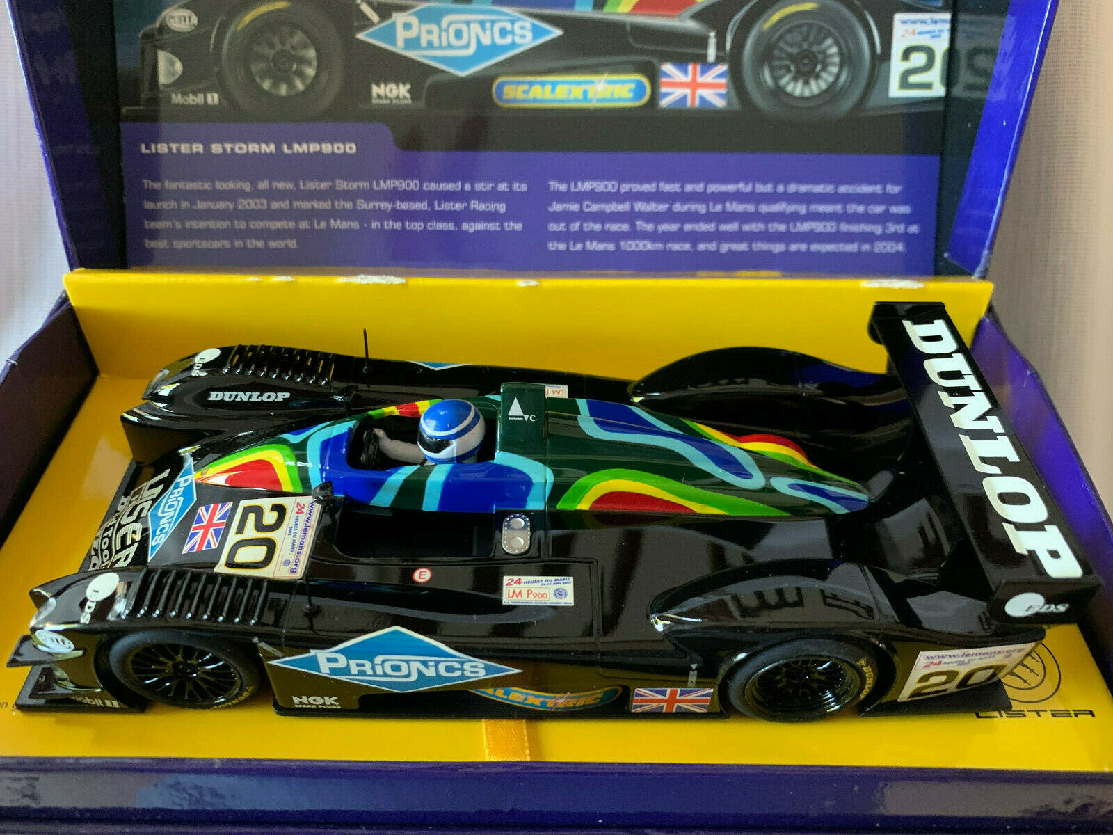

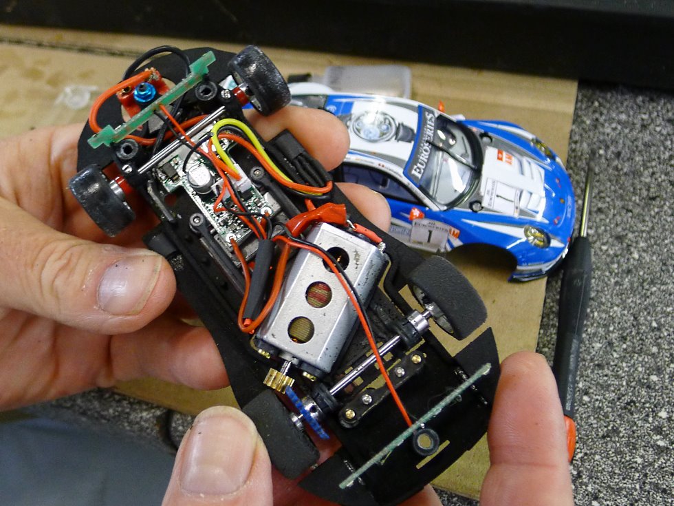

2004 motor pods
C2521 Lister Storm and C2678 Maserati MC12 were announced in the 2004 catalogue as the first of a ‘new generation’ of Scalextric cars for the serious racers. Both cars featured, ahead of their time, separate motor pods and were very reasonable performers. They only remained in the catalogue for a couple of years, no subsequent car was ever fitted with the pods and the new generation disappeared without trace!
