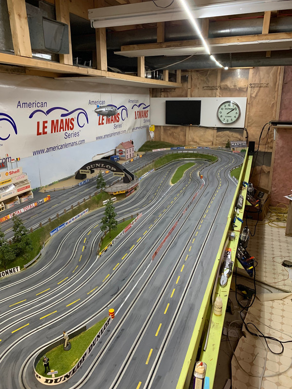

I have been looking into options to create a realistic day/night/day lighting transition for my Le Mans themed track.
There didn't seem to be any affordable options in the model railroad world and then my searches brought me to this controller for aquariums .
TC420
This is the planned configuration using led tape light strips
#1 output:  track lighting and blue nighttime light
#2 output: bright morning light
#3 output: orange evening light
#4 and 5 output daytime
This is purely a plan at the moment and i just wanted to share my findings and see if anybody had any better ideas or reasons this is not a feasible option.  Idea

Meanwhile I tried out the wife's new kitchen lights Bigsmile
 18W x 16Ft light strip , I'm planning to have 2 of these for daytime.
The TC420 allows for up to 48W per channel on 12V so it could be increased to a more powerful strip.
I think it looks quite promising.
[Image: LED.jpg]
[+] 4 members Like Anglocanadian's post
Wow that strip is giving great light.  Racing at "night" has always been one of the dreams of imaginative slot-racers of all ages but the dream ends when the room lights are simply switched off and on. This could be the start of something big.
