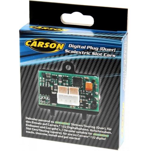

To work on a Carrera Digital132 layout, all cars must be fitted with a Carrera digital decoder (or “digital chip”). There is a plug & play decoder for Scalextric Digital Plug Ready (DPR) cars...
This is made by Carson and will allow a Scalextric DPR car to work on Carrera Digital132. They are widely available in North America. In the UK, they are available from Jadlams here.
Non-DPR cars are less easy to convert. Slot.it are just about to release a Carrera-compatible decoder - item ref SP43 - that can be soldered into any analogue slot car or is plug & play with the latest Slot.it models.
I hope that helps!
