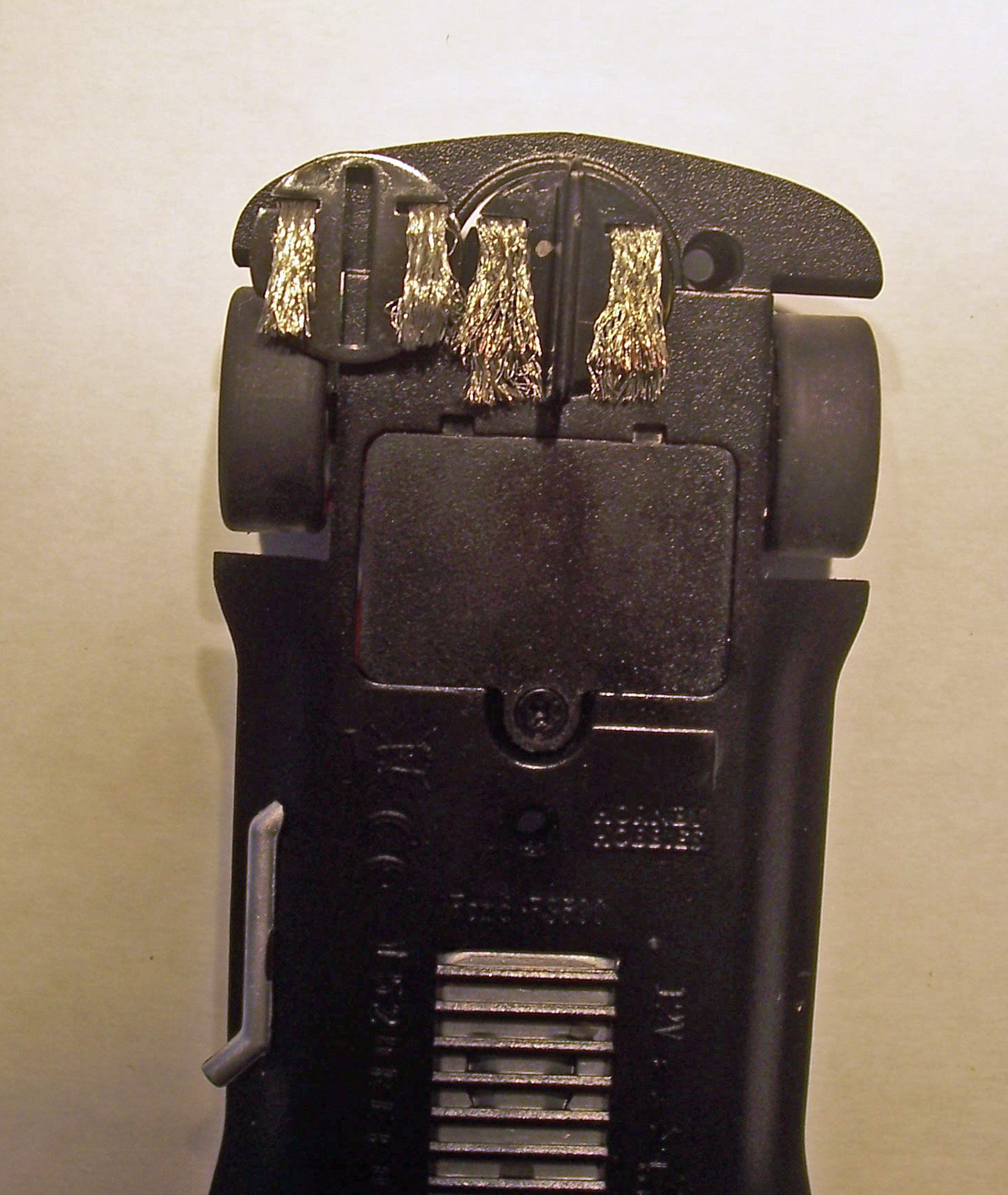

A pleasant surprise as everything fitted and worked correctly with the exception of the front wheels which failed to touch the track. This was easily fixed by my usual practice of unfolding the braids into an SCX pattern thus lowering the guide and the wheels then made contact with the track. This is a useful modification for all Scalextric cars as it also increases the contact patch for the braids.
    Standard on left, unfolded on right.

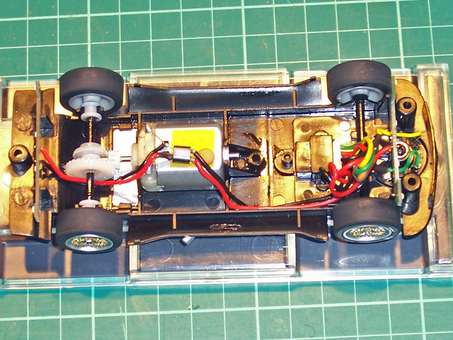

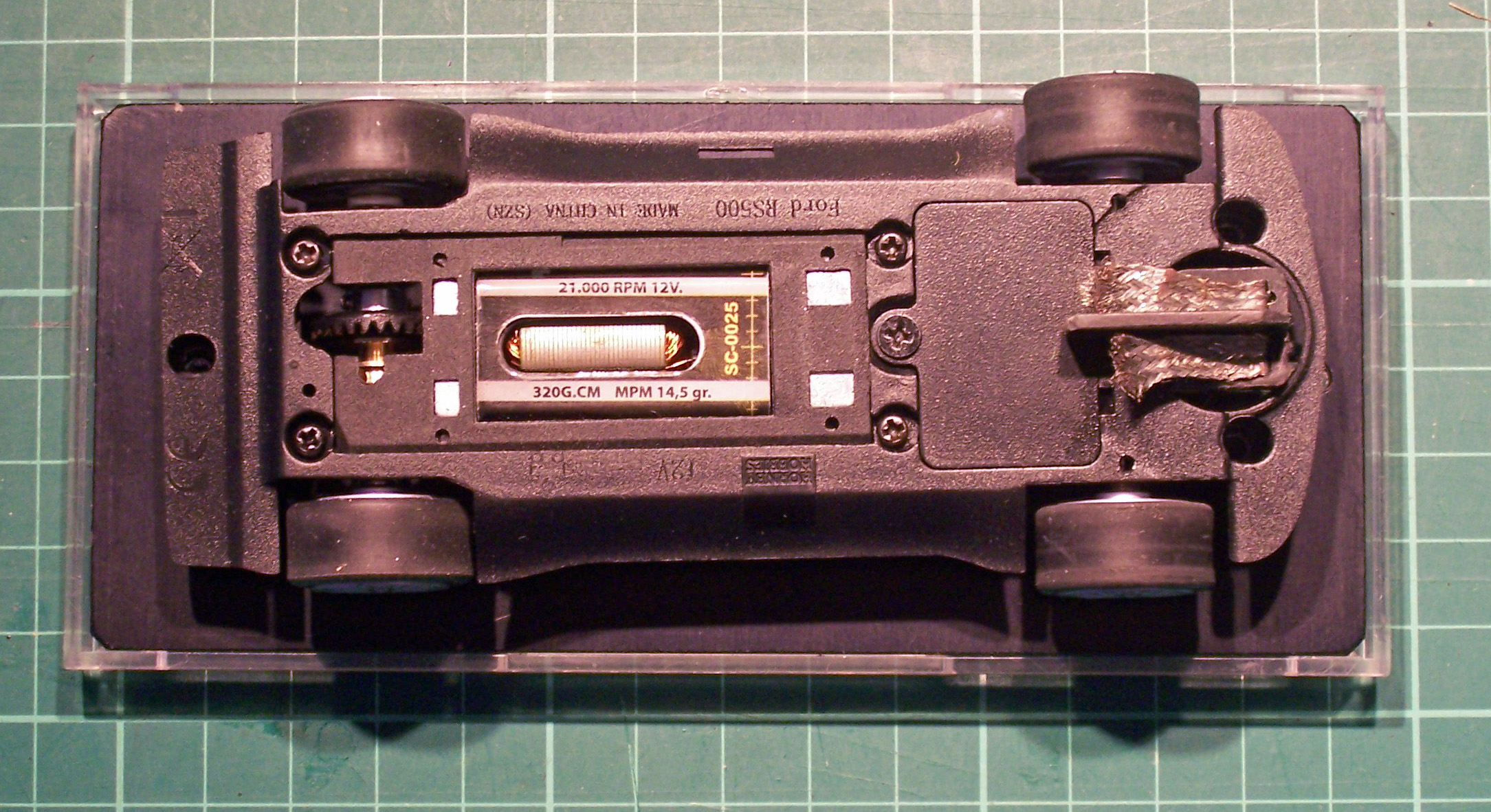

Removing the body reveals the normal inline chassis:
Note that the wiring for the rear lights is routed under and touching the rear axle. I didn't think this was a great idea as friction would eventually wear through the insulation so I rearranged it over the axle and took care to make sure it was out of the way when I replaced the body.

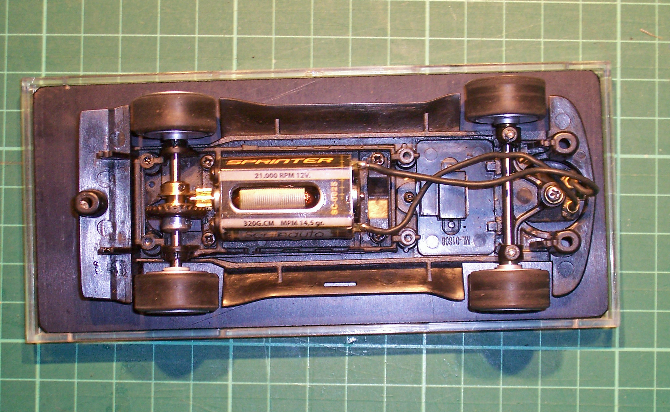

I mentioned in the review that the car came with a free PCR chassis so I have now tried it out.
A rummage in the dead car box turned up a complete Scaleauto chassis that once belonged to a GT3 Mercedes. I used its pod complete with motor, gears and wheels, trimmed it slightly with a craft knife and it fitted perfectly. The spares box provided some shorter axles, a Slot.It wood guide and some Wasp urethane tyres.
On to the track and I had a half decent slot car. Terminal understeer gone and lap times improved by half a second. It now laps consistently in the 5.7 second range without any major dramas. It could probably be improved further with some better gears and wheels than the standard Scaleauto ones but it will do for now.
