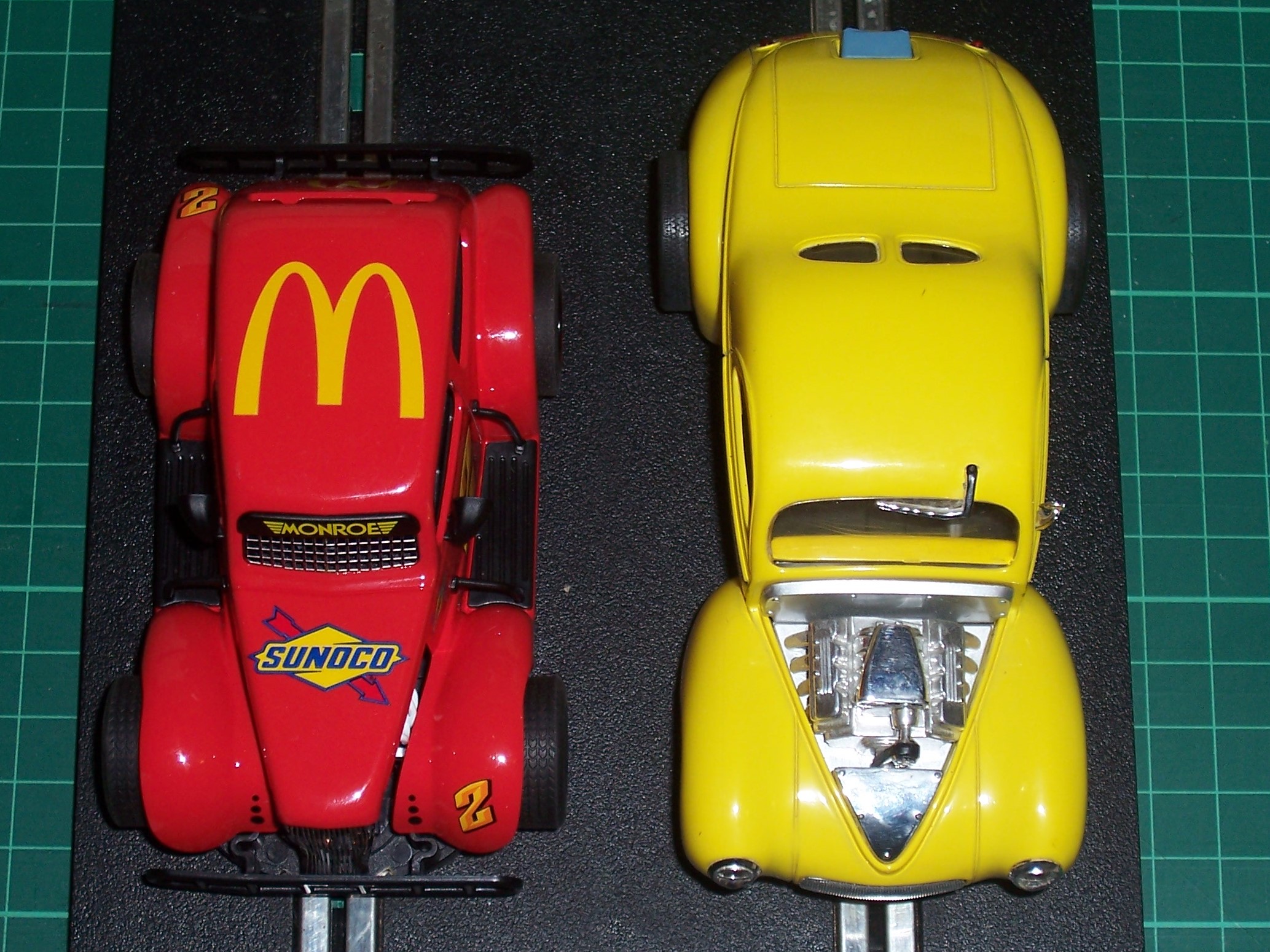

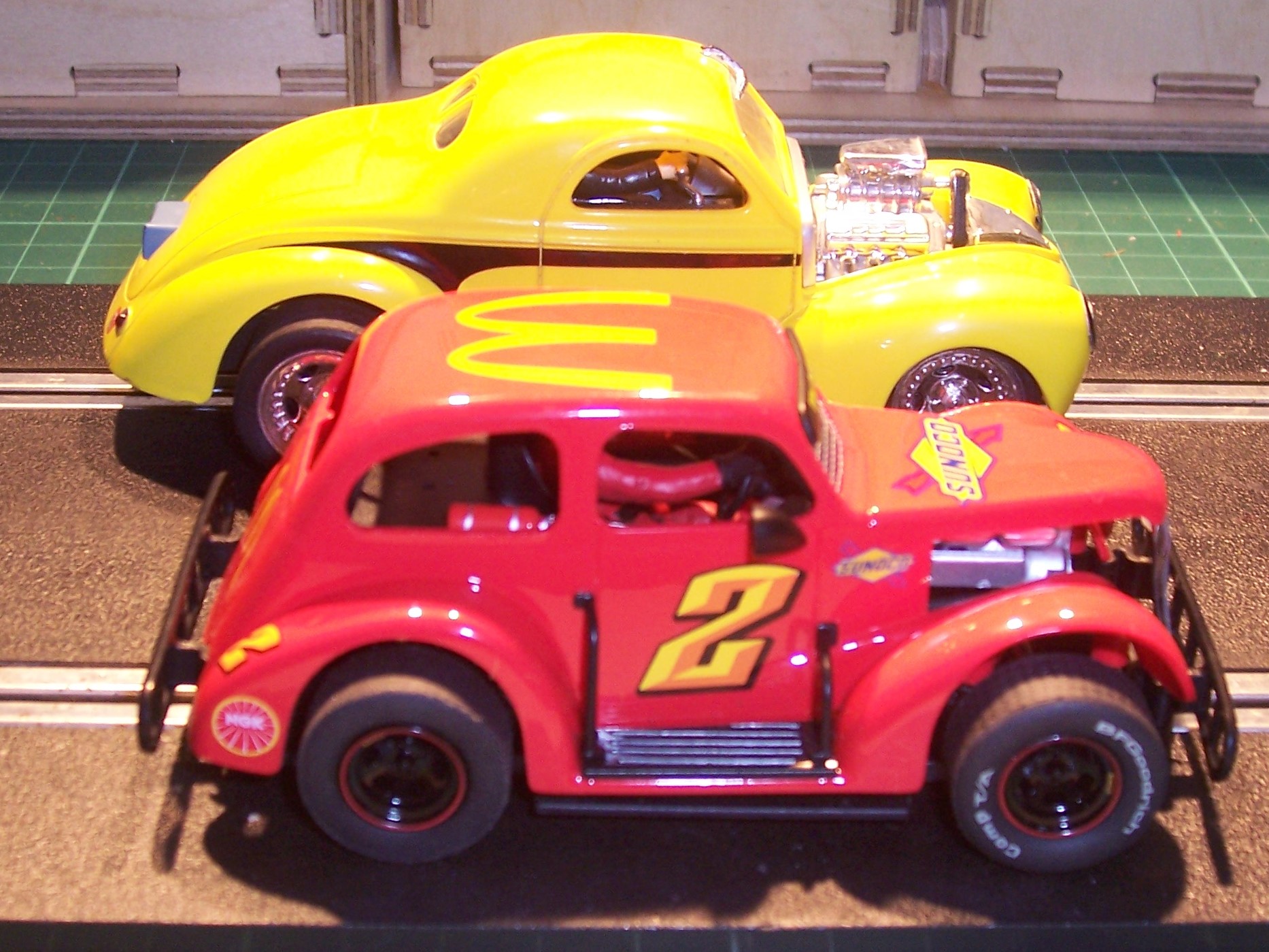

For comparison purposes here is a Legend and a Carrera 1/32 hot-rod of the era.

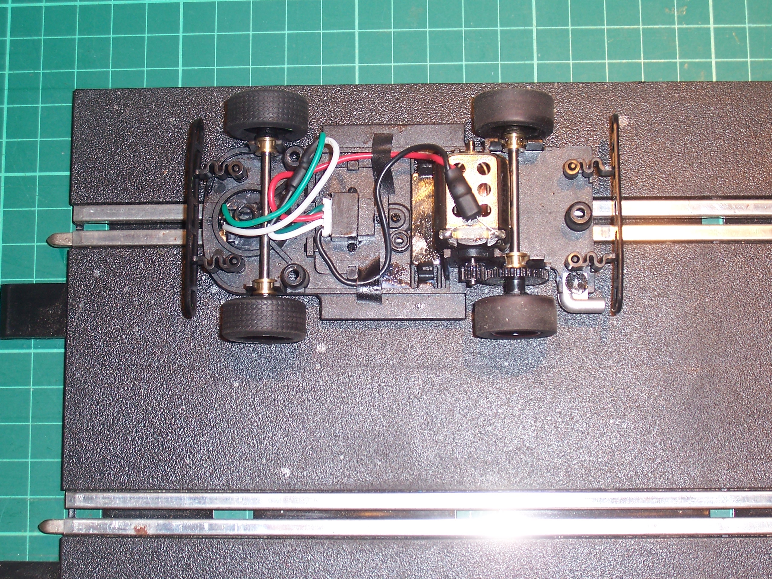

Under the bonnet
The body is secured by three screws and lifting it off reveals the standard Pioneer layout and mechanicals:
It is nicely put together, wires are taped off where necessary and all components are solidly mounted. Quality control is up to their usual high standards. The front and rear bumpers are not fixed in as they are the most likely things to get broken in racing incidents and can be easily replaced, assuming they become available as spare parts.
I am not a fan of Pioneer's guide blade assembly though, it wobbles about too much and the braids themselves are far too stiff and springy. For club use I would change it to an aftermarket version but it can be improved for home use so I have left it in place.

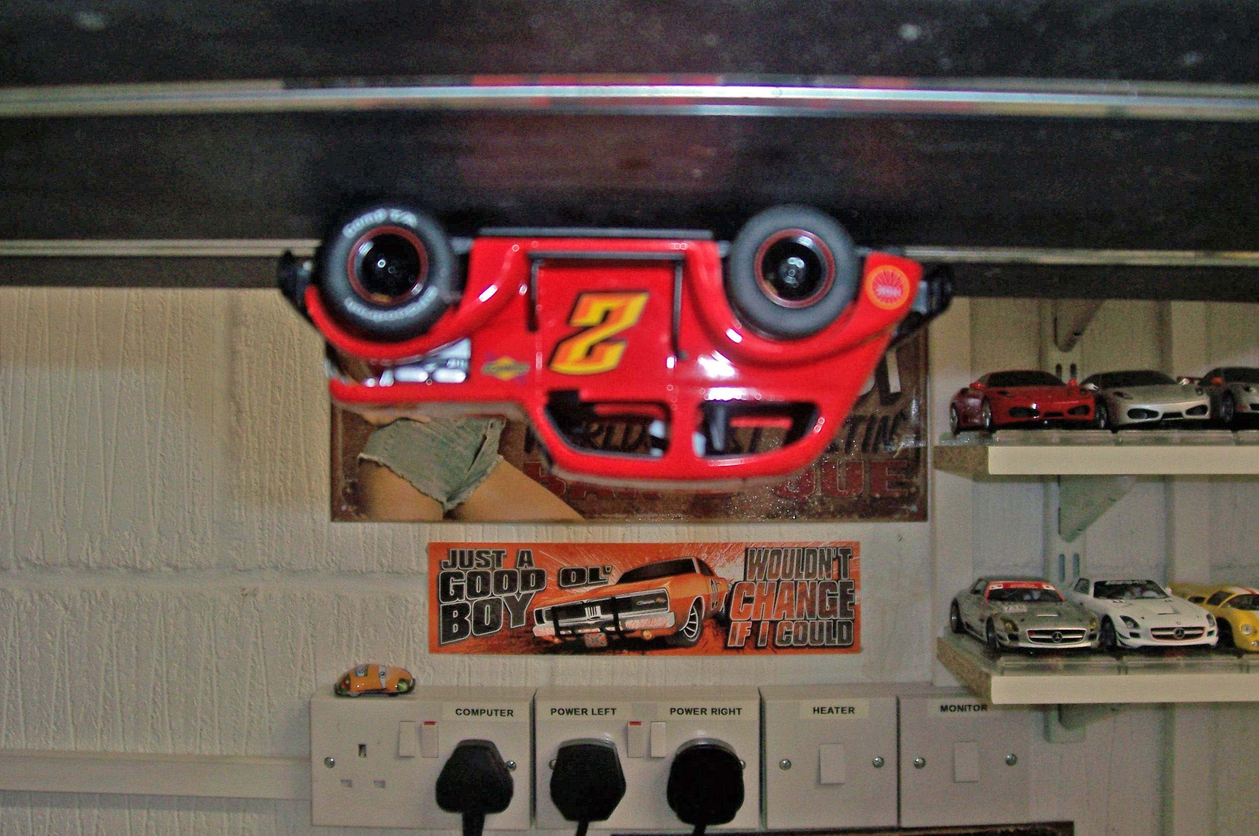

My home track is copper taped wood so I couldn't test the car on plastic but this may give a clue to its performance on this type of surface:
No, the picture is not the wrong way round! The magnet is so strong you could race the car upside down without it falling off. This leads me to expect that it will circulate at very high speed on plastic track until the magnet lets go and a truly enormous accident follows.
