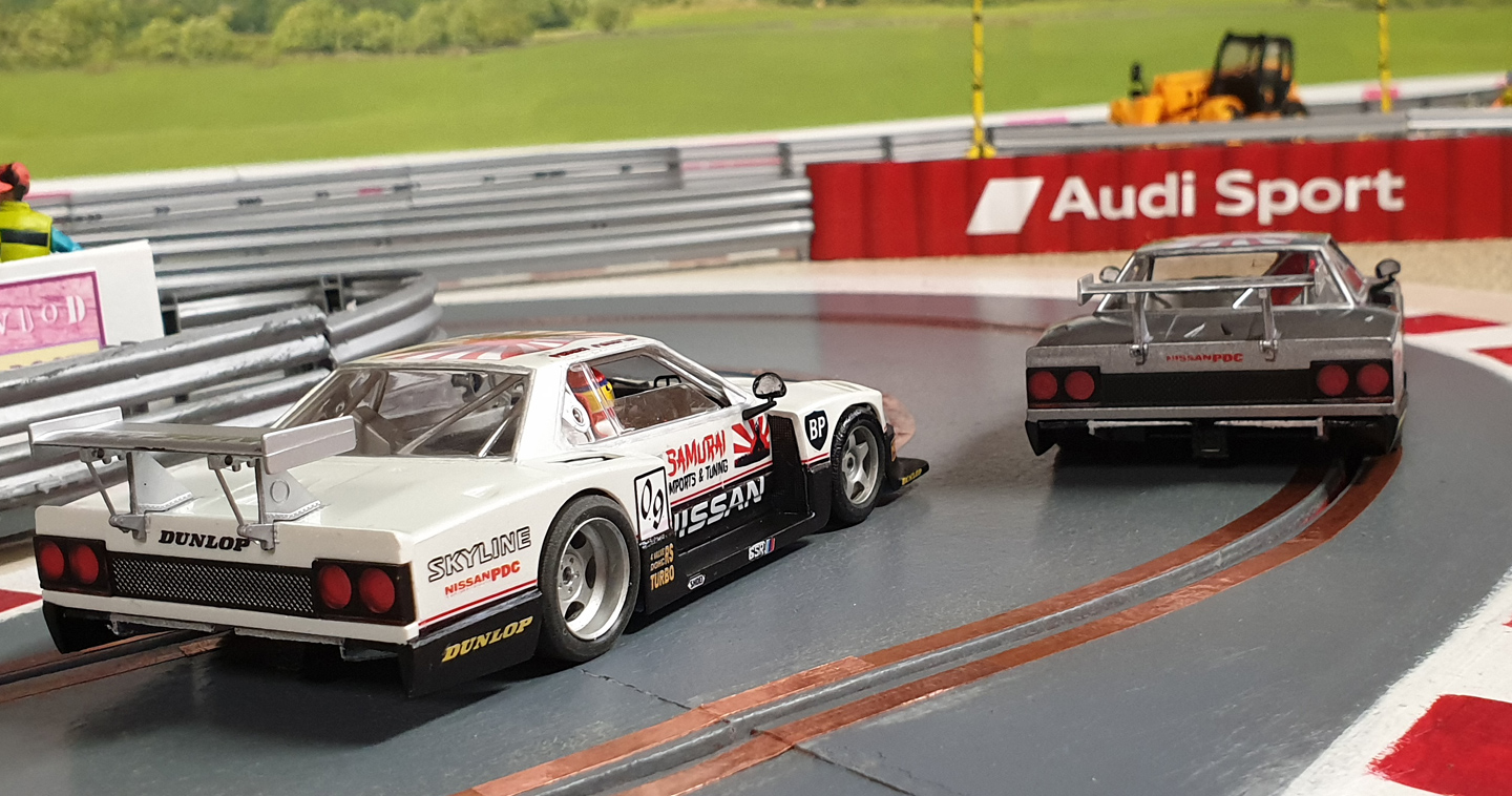

While I was waiting for everything to dry I had noticed a lot of the cars did not have a diffuser like the model, The livery/version that Sideways make did run with that shape diffuser from what I can find, but many had nothing but a couple of just visible frame rails.
So the dremel was used to lose the diffuser as I prefered that look.

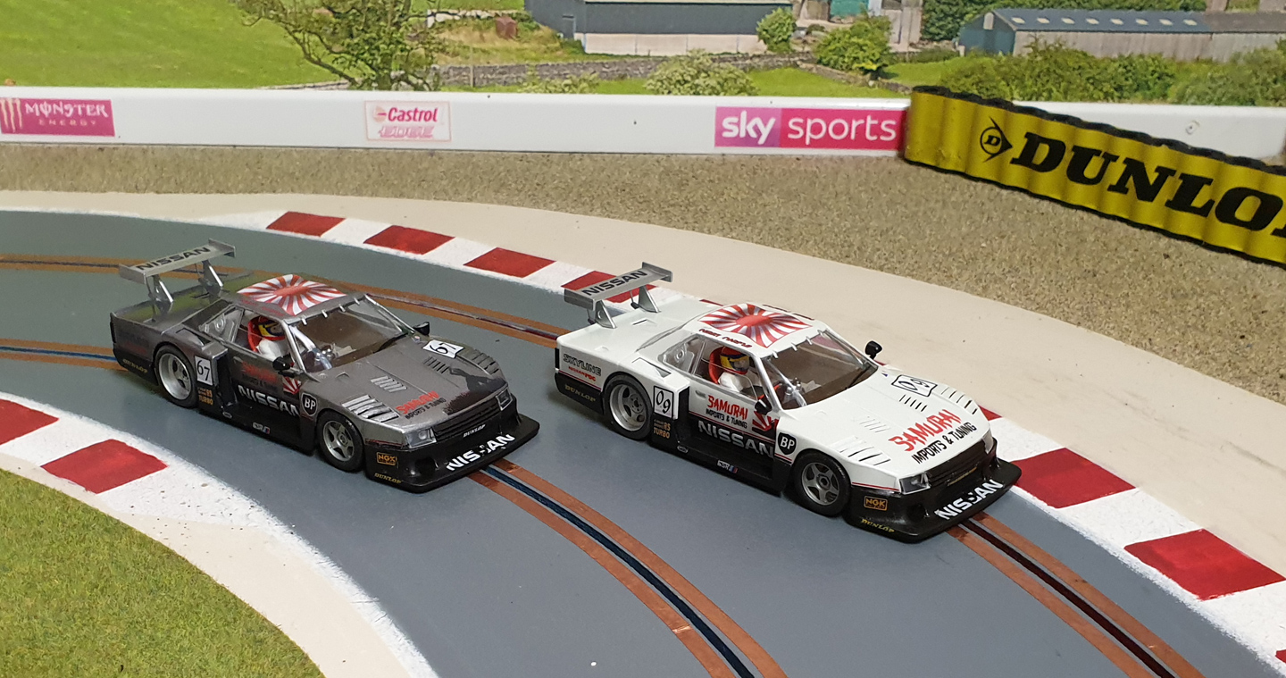

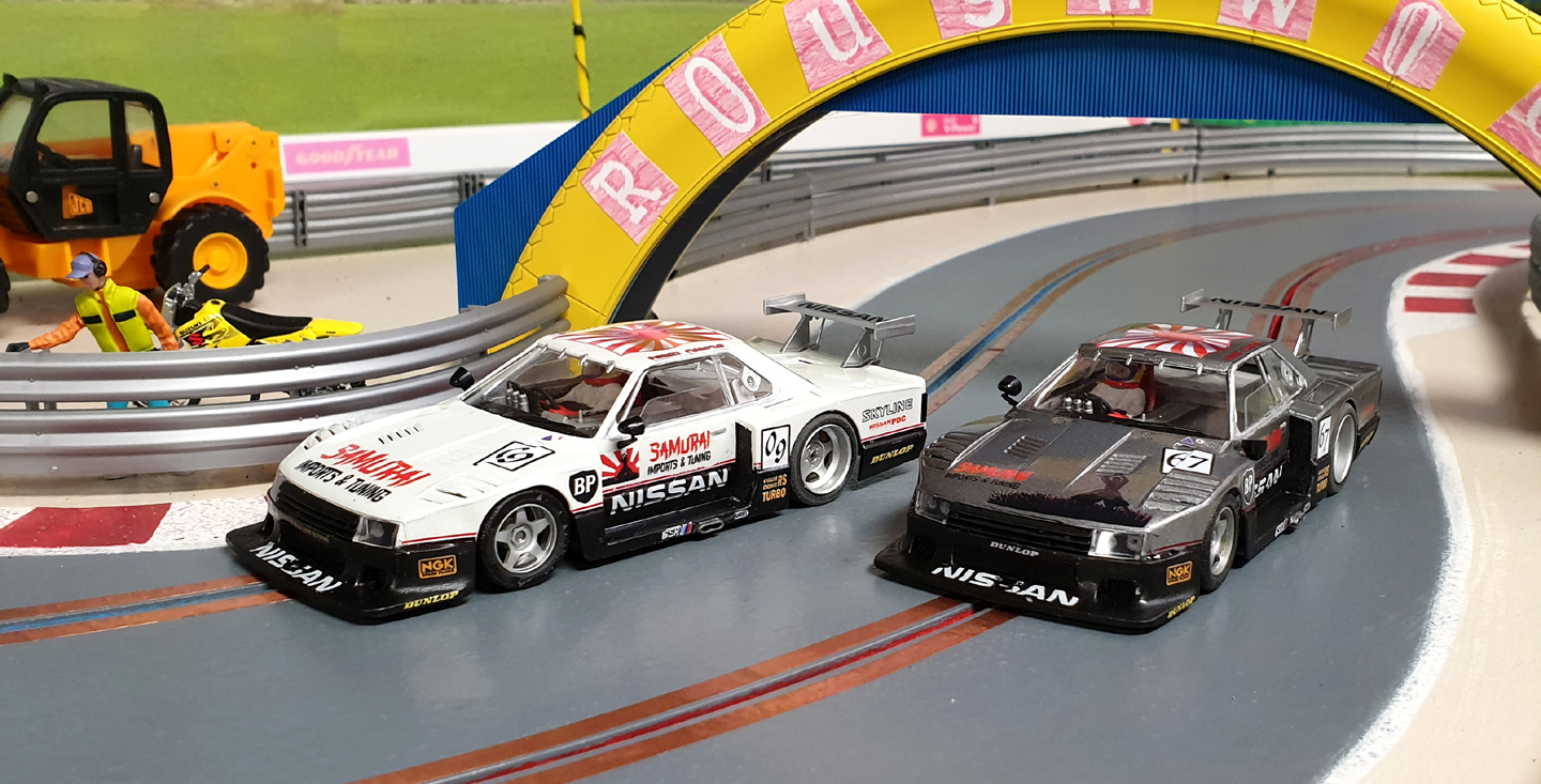

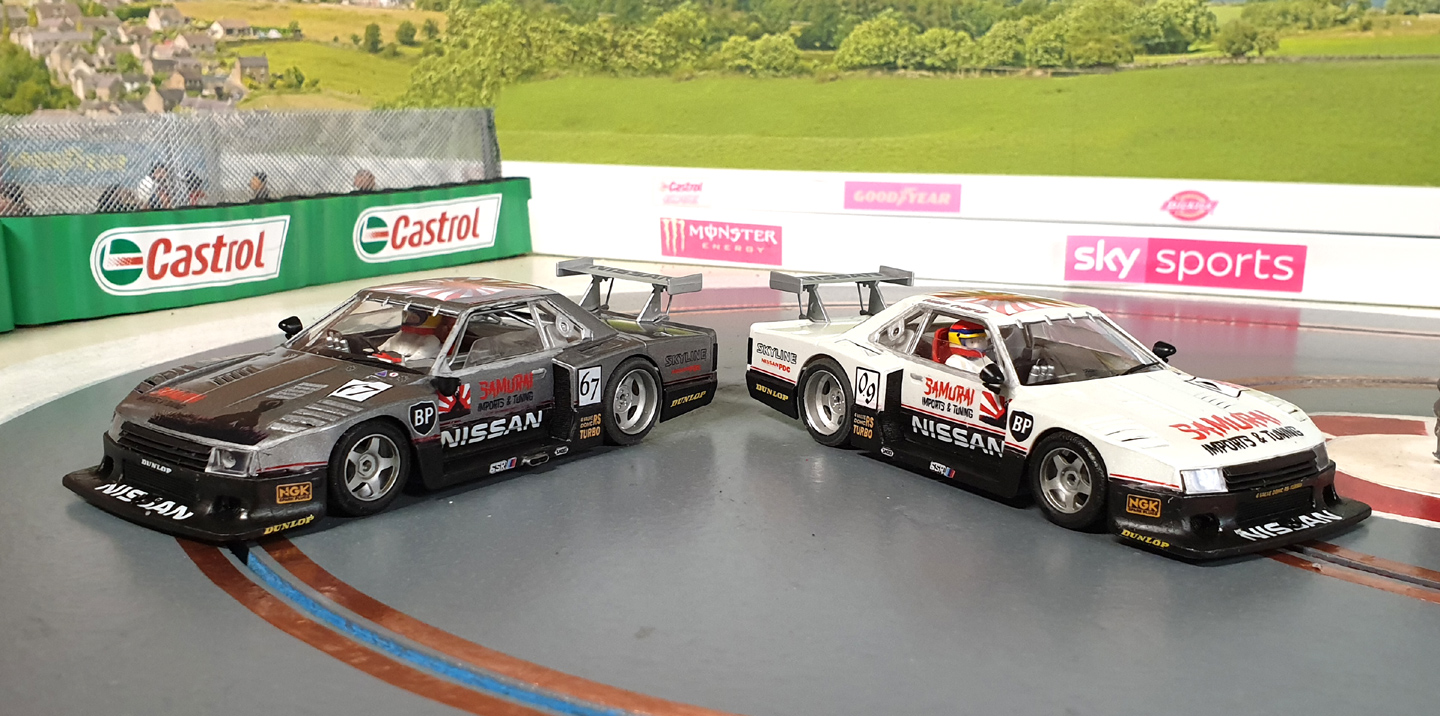

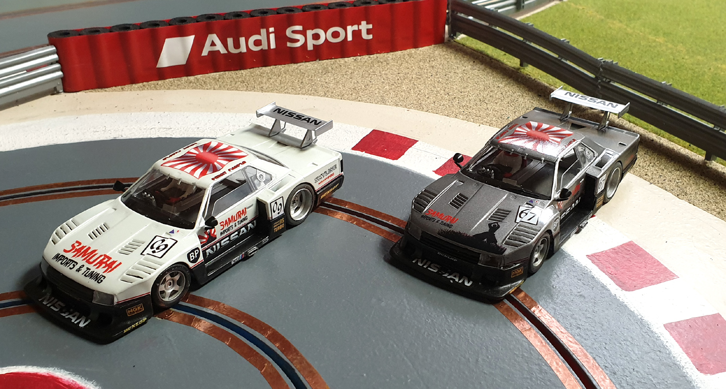

So, after all this waffle, I present the finished product. Once again a flawed finish, but lessons learn't for next time (if there is a next time)
