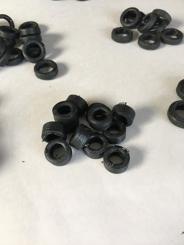

Lots of us have done it. During lockdown I opened my two pots of Smooth on Vytaflex that I had purchased some twelve months earlier and got out some old moulds and made some new ones.
I began casting using my experience from two earlier episodes.
1) It is messy
2) The one part (yellow pot part B) starts slowly going off as soon as you open the pot.
3) Use a syringe to inject the mixture, I used a 10 ml one mainly due to what I had and the nozzle size.
4) Choose tires to repop you like and use a lot.
   I wanted tall profile narrow vintage tires, tires to fit the Slotit 14mm rim, high profile wide, F1 wide donuts, SCX Escort and Fiat Abarth replacements.
5) Clean the rim and lids carefully after use because any residue on the rim starts to cure and getting the lid off the yellow pot will have you speaking bad words before all the contents are used.
6) You will have failures which is disappointing after waiting twelve to sixteen hours for demoulding. Some failures can be repaired when you mix and cast next time but some will go in the bin....my success rate improved as I learned my syringe technique.
7) The black pigment is extremely strong so take care not to get it on you, your clothes or anywhere it shouldn't be.
This pack cost me about 40GBP. I have given a few sets away but now have a supply that should last me a while.

They look good.
What do you make the moulds out of?
(12th-May-20, 08:36 AM)JasonB Wrote:  They look good.
Thanks Jason...for moulds I use a 20 shore hardness silicone
