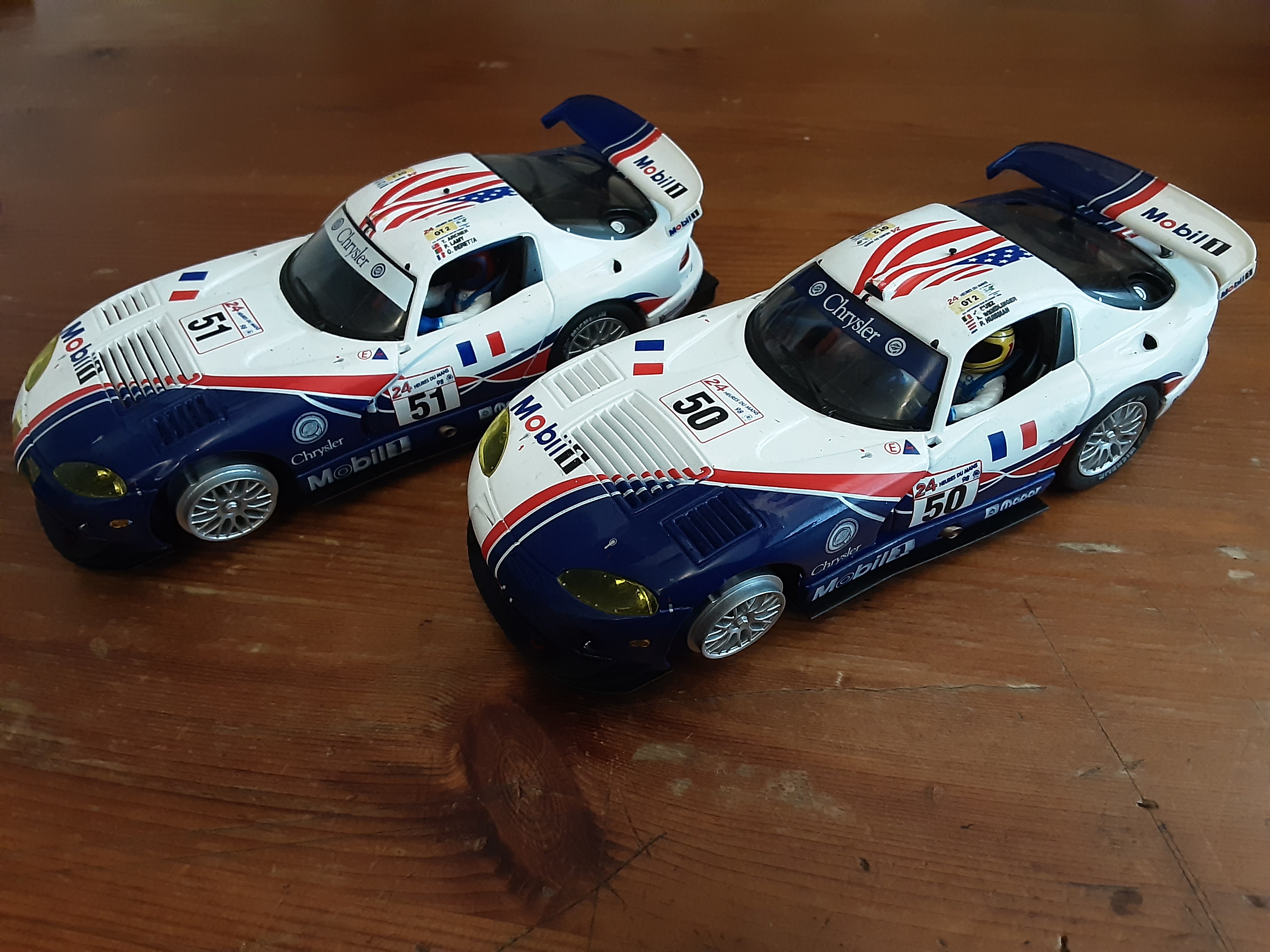

So I have seen a slot car that would fit nicely into a race series at the local club which uses standard Scalextric motors and track...but the car has the motor at the front end of the chassis.
1. Has anyone, ever, managed to build and tune a front motored slot car into a competitive machine using the original chassis configuration?
2. Does anyone have any clever tips for installing a digital IR LED somewhere at the front amongst all the guide and motor kit?
Be honest with me, I haven't bought it yet... But I am up for a challenge (with all you help!)

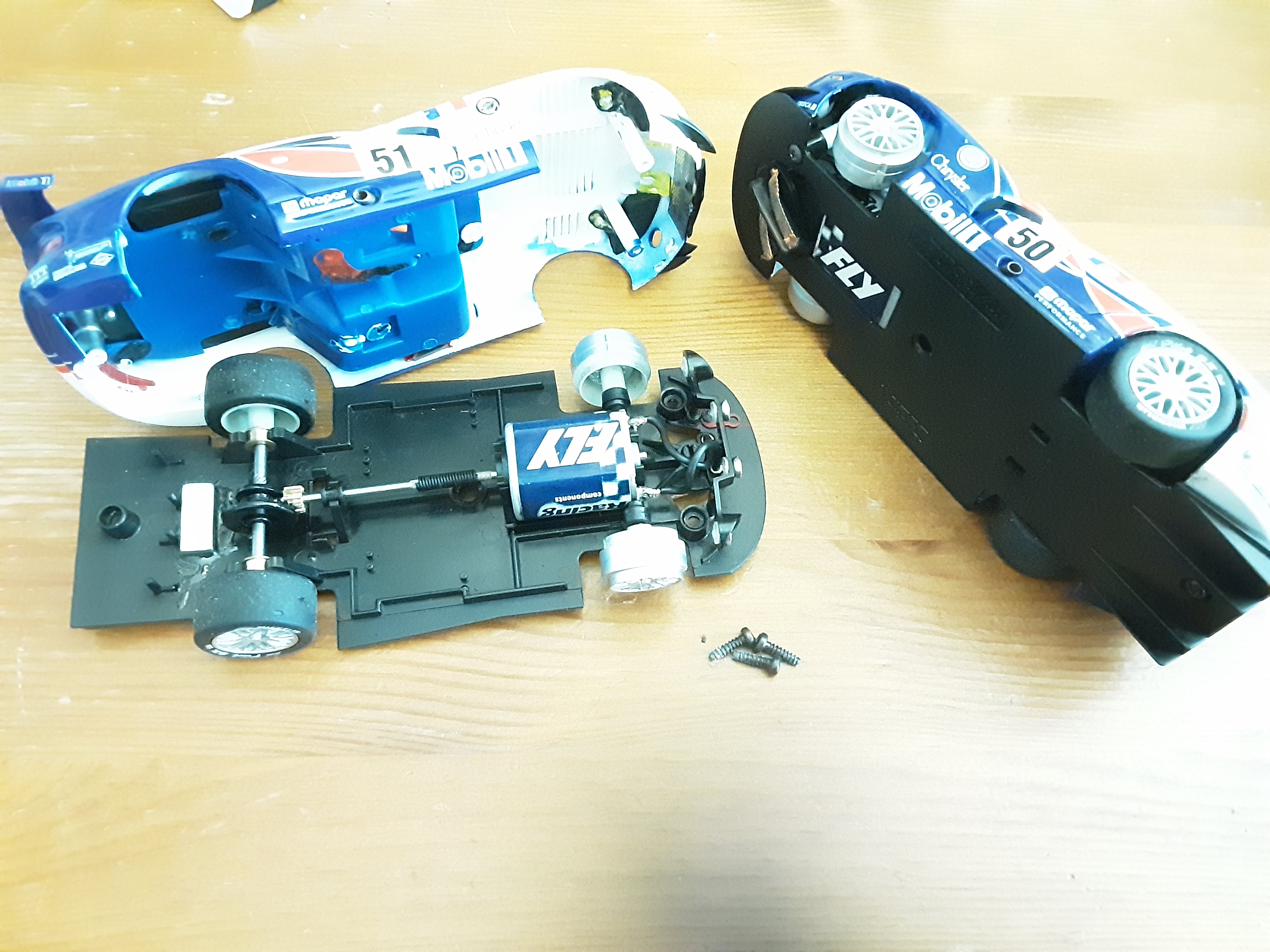

I have only ever owned 2 front motor cars, A pair of fly vipers.
Not quick, don't handle well. Even with the factory magnets installed.
Without the mags, they don't work at all.
Convert to digital? Not a chance! No space at all for the emitter LED because the motor is right up against the guide.
Bronze bushes for the axles but a plastic brush for the prop shaft.. not good.
Having dug these out of a box in the shed, I'm looking at them and considering if there is anything that could be done to make them competitive.
Probably not (in any classes at any clubs I go to)

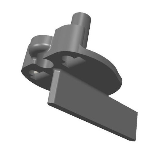

Surechange Guide...was directed to it earlier this morning, only seems to be available from a large French online store...I present to you, a guide with built in holder for an IR LED!

Isn't there an issue with ARC PRO and surechange guides in that because the LED is in front of the guide they don't work?
You can still use them but the LED has to be no more than 1 cm behind the guide.
Again, I am not 100% sure so feel free to tell me I am wrong.

(28th-Apr-20, 01:20 PM)dvd3500 Wrote: Isn't there an issue with ARC PRO and surechange guides in that because the LED is in front of the guide they don't work?
That's my understanding, too. They won't work with ARC Pro Digital. Glen
