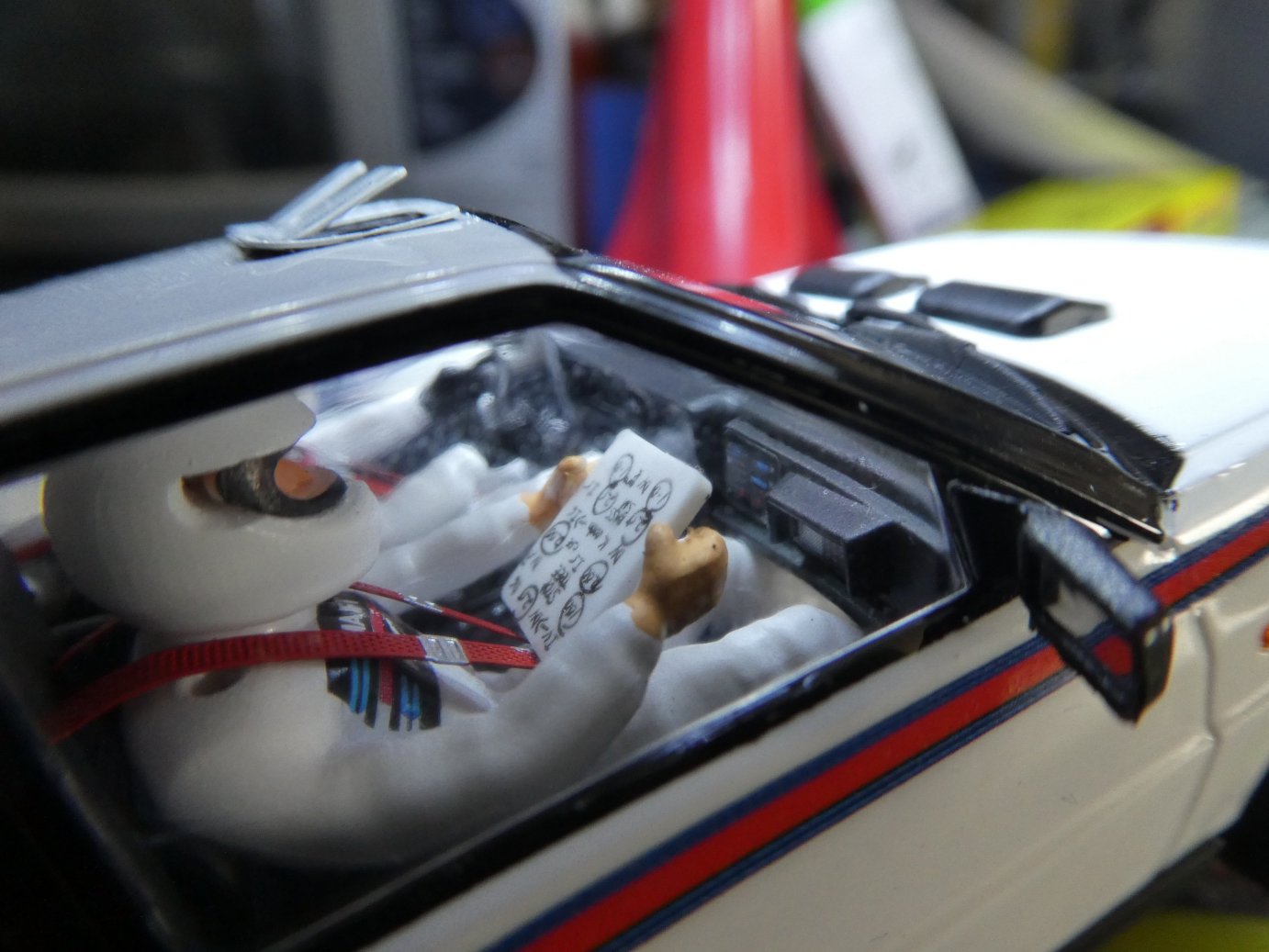

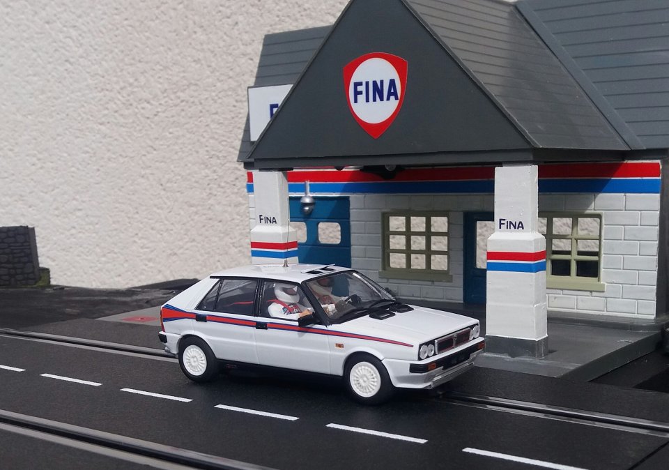

The first Team-Slot cars announced were an Abarth Test(Development) car and a Camel liveried competition car. The Test model looks great in images and out of the box. It felt quite heavy but my scales say 91g. Its a fairly good scale model of the Delta and sits nicely with the earlier T-S Delta HF integrale and S4 models. The roof-vents are very wide open and look at risk in crashes so I was pleased to find that I could bend them down a bit. The flaps are simply a photo-etched item glued on to the roof so I had to be careful to hold down the trailing edge as I bent the flaps down (or they may have detached). The air scoops on the bonnet are correct and distinguish the 4WD from the later ‘integrale’ versions. These scoops were also fitted to the concurrent two-wheel drive Delta HF Turbo. The model has a very nice radio aerial and it has an actual coil spring base. Detailing is good and the dash/instruments are as good as was promoted in advance (excellent) although the navigator’s notes are upside down in one of the two cars that I have.

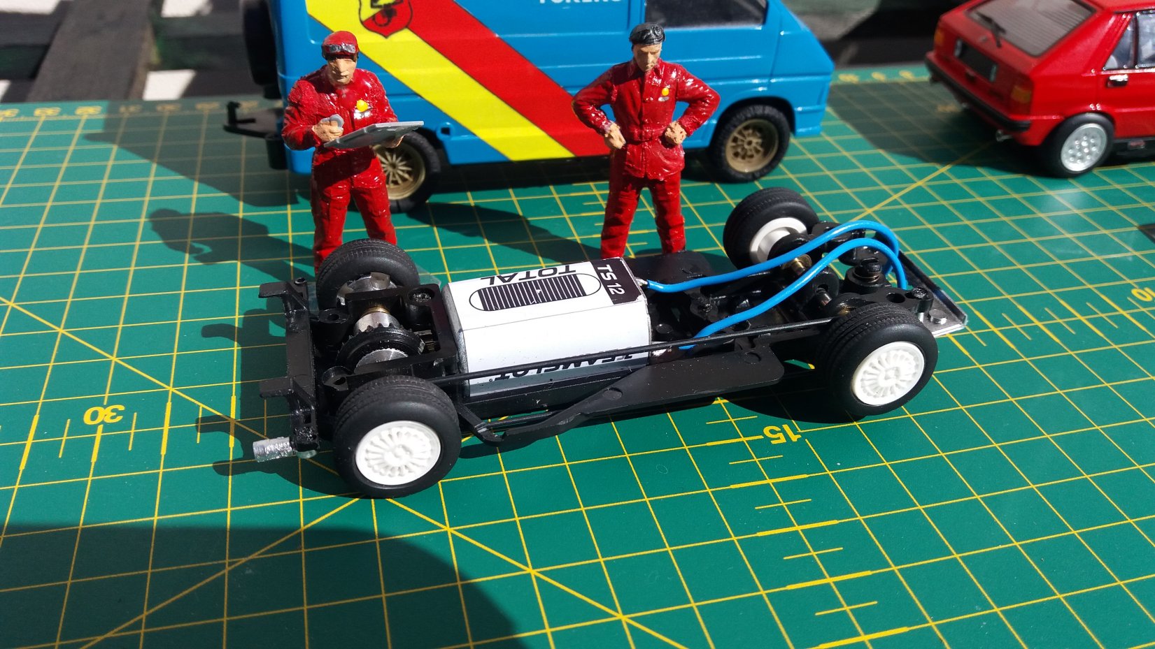

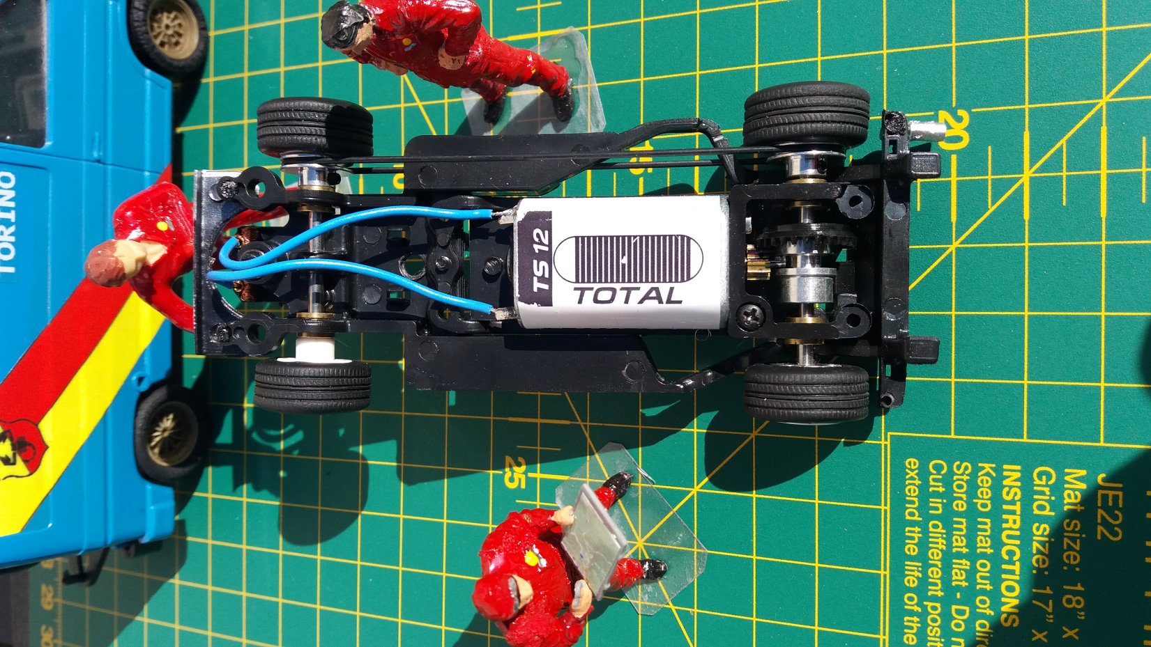

On the Test car the wheels are aluminium alloy and constructed such that the tyres hold the insert in place. Tyres need truing. The motor is mounted in an in-line pod with chassis designed to alternatively accommodate an angle-winder pod. There is no traction magnet and not really any provision for one. Plain belt-drive takes power to the front axle via alloy pulleys and the rear axle crown gear is an alloy and plastic combination. Motor is Team Slot TS12 Total (closed can), rated 22,00 rpm at 12v and 140ma with 290gr.cm The guide is a fairly standard thing. The motor position is offset downwards noticeably. Gearing is 9/27. Tyre width is 8.5mm and diameter is a touch over 17.5mm. Wheelbase is 77.7mm and overall axle/tyre width is 50mm.

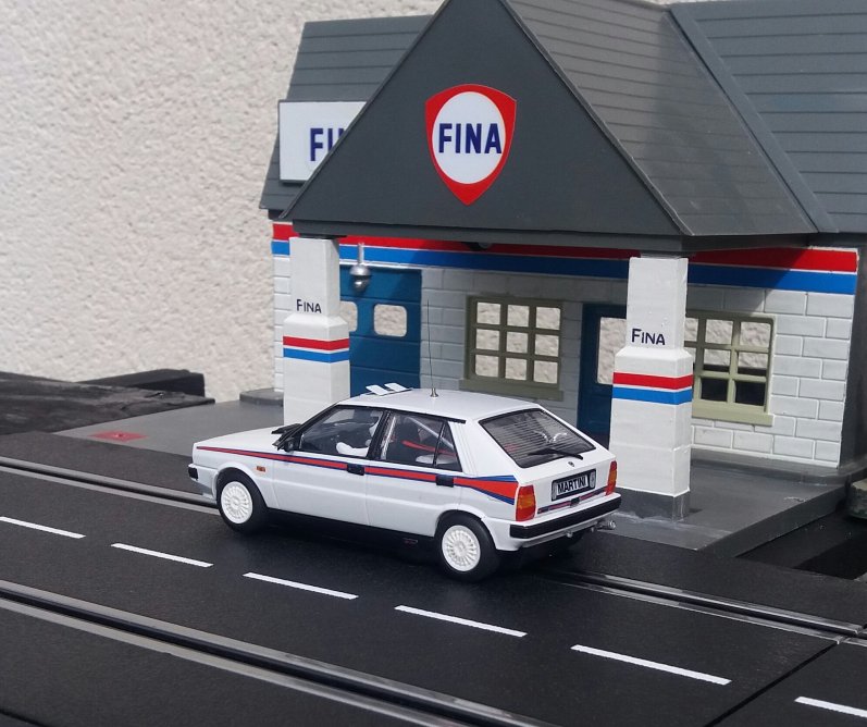

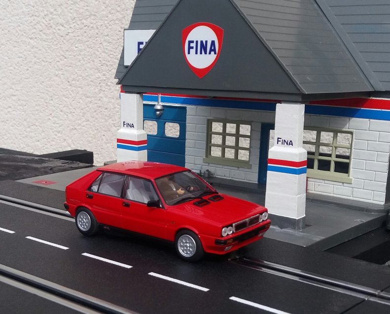

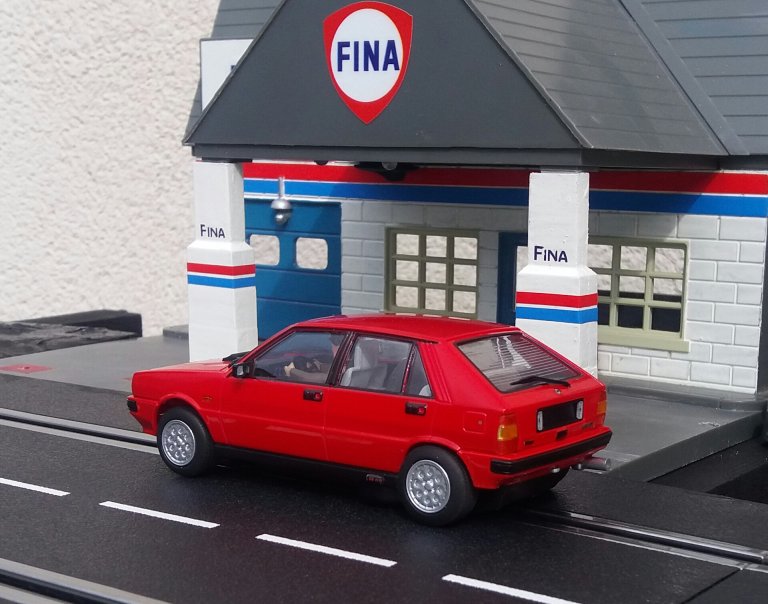

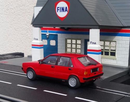

I haven’t mentioned the subsequently released road(stradale) car which is slightly different. The interior is fine for a slot-car but not the correct cloth pattern! An excellent detail is that the dashboard and instruments are devoid of the Halda Rally Computer and fuse box. The wheels are a bit of an issue though. Pattern is correct for the production car but are plastic front and rear so need truing all-round. Same chassis and motor arrangement and belt drive. Pedants will complain about only one exhaust tail pipe, should have two (I have fixed this failing).
