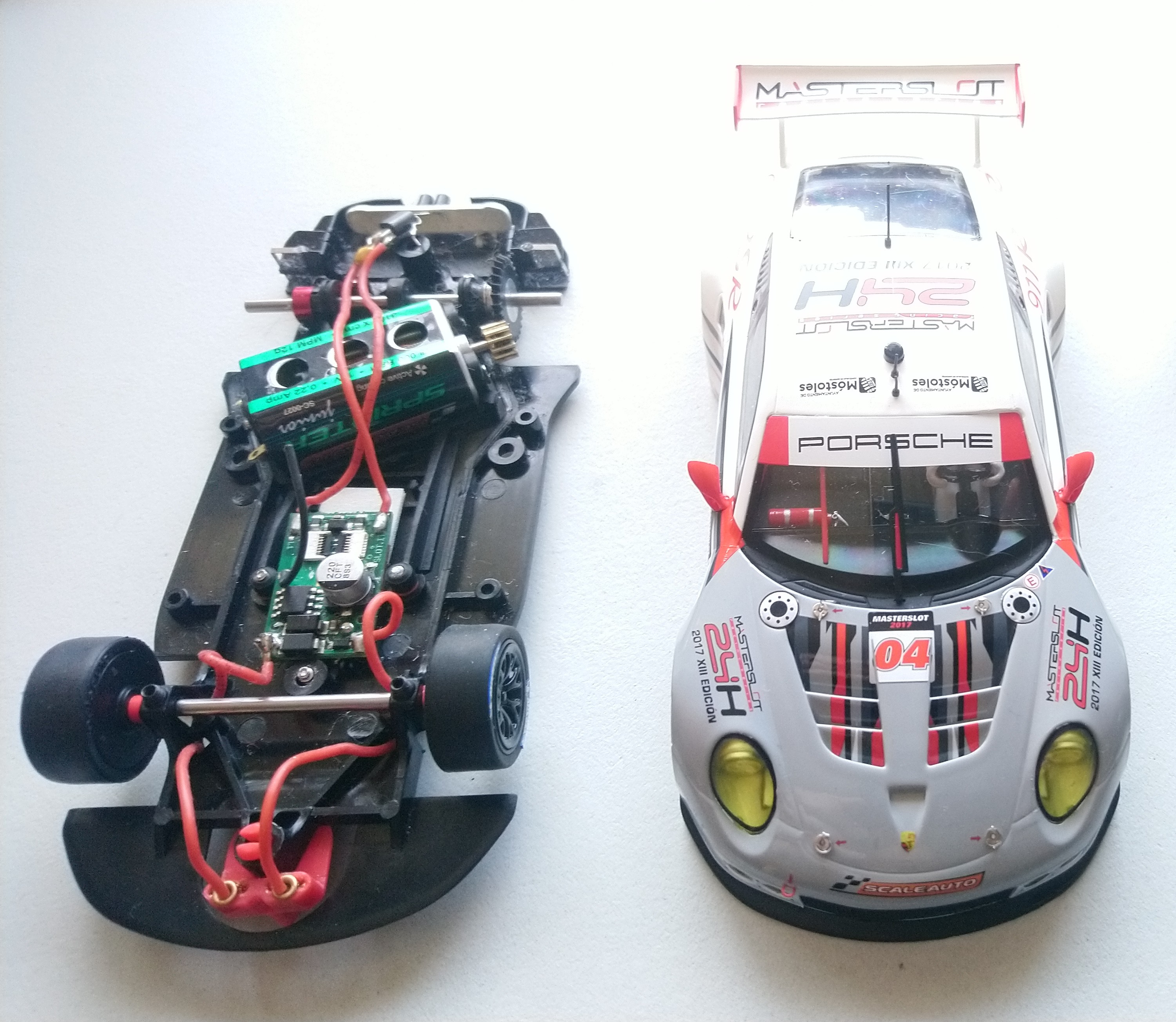

So here is my starting point...
Made up of...
Scaleauto 991 chassis from the R-Series donor car
Slot.it anglewinder motor mount, 0.0mm offset
Slot.it 12/27 gears
Slot.it oXigen Type C chip
Regulation motor Scaleauto 0027b 18,000rpm "Baby Sprinter”
Regulation rear wheels & tyres, Scaleauto SC2018 ProComp-3 20.5 x 9mm
With the intended Scaleauto 991 body, weight will be around 91g against the class minimum 85g. And I still have to fit the lighting kit, which will add a few more grams.
Some of the choices I made;
Slot.it motor mount over the Scaleauto mount as it makes for a easier install for the digital chip
A 12/27 gear selection as this mirrors the original R-Series model. I have never raced at North Staffs or Rockingham, so have no experience to know whether this is the best choice, but I am expecting gear ratios to change over time as I get to know how the car behaves.
Slot.it oXigen Type C chip as I can set it to SSD mode so I can run the car on my home Scalextric track and try different tuning options.
There is a body with my name on on the other side of the world which, when restrictions become relaxed, will be winging it's way onto this chassis.
I would welcome any comments on preferred set ups from those of you who have raced in this series previously and have experience of the events.

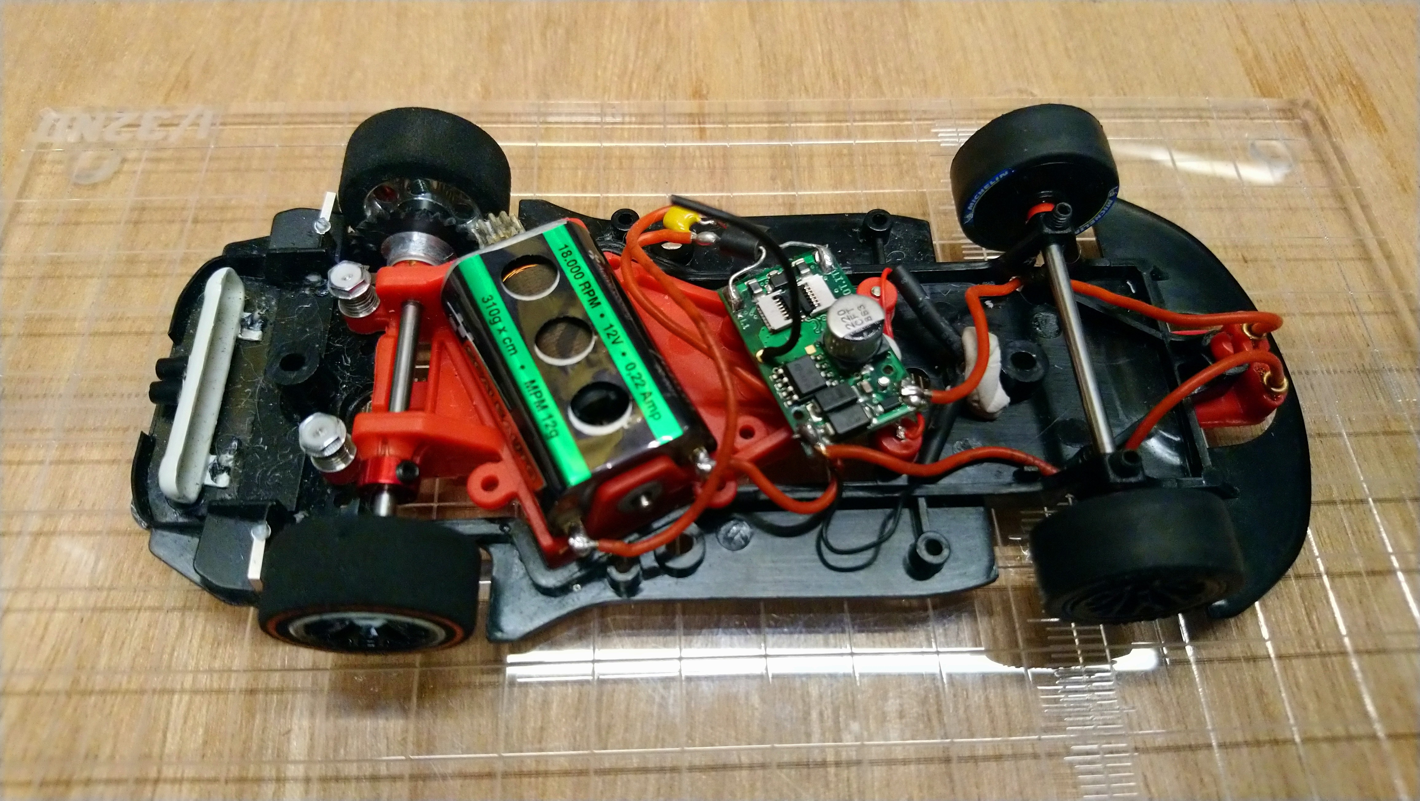

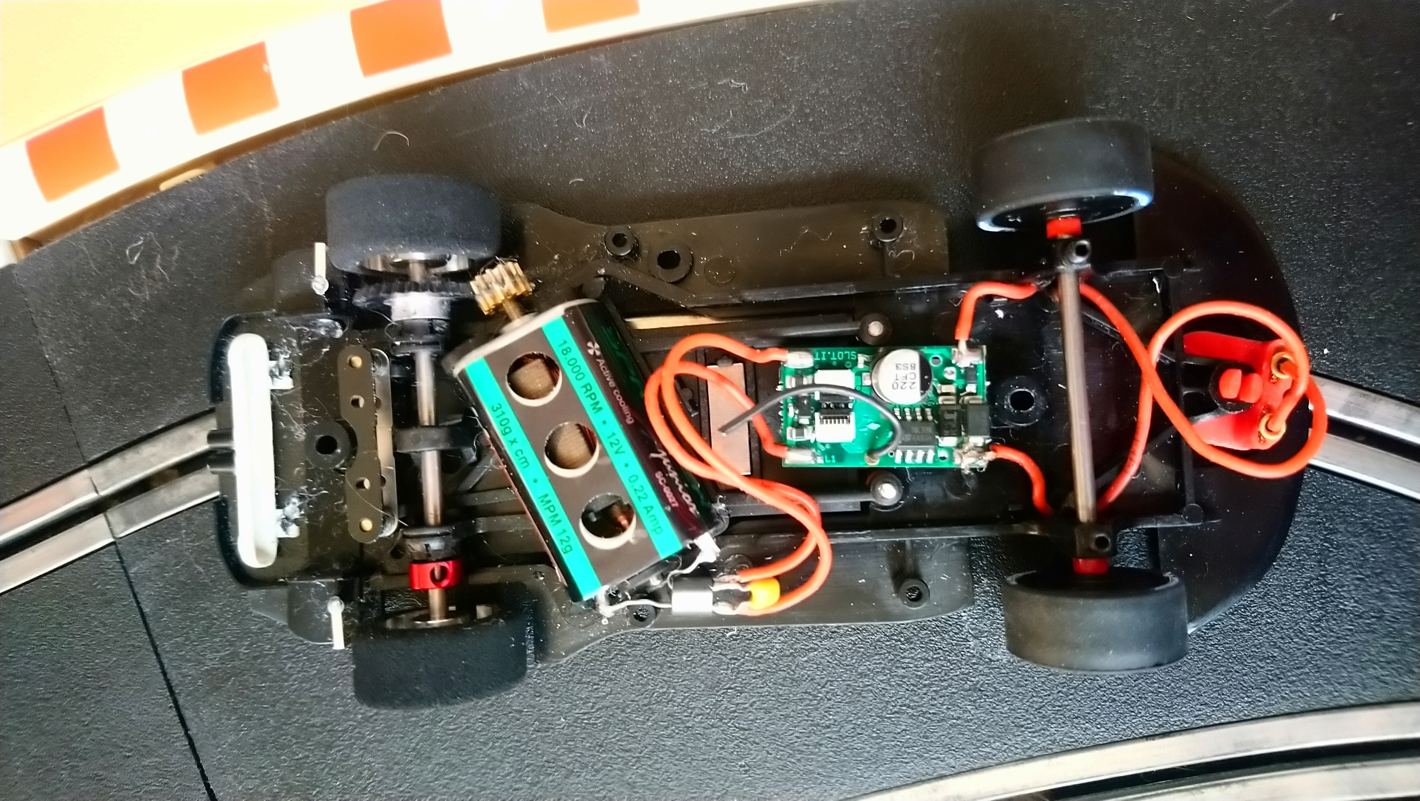

Ok, never let it be said that that I am not prepared to listen and learn...
Remote LED fitted [just held in with blutack at the moment, but maybe hot glue?]
Motor cable reversed to bring FM inboard and away from danger [?]
Tungsten weight removed [and to avoid leaving an empty slot, I have reverted back to the original R-Series Scaleauto pod]
So...I have got my head round getting a Lexan interior, and that relaxes the positioning options for the chip, which then negates the need for the Slot.it pod, and a part of me likes the idea of using the original motor pod. The scales would suggest the Scaleauto pod is 2.5g heavier than the Slot.it pod as the overall weight of the chassis has not changed...
Hello Jeremy....hrrrrrrmmmm Sorry to have to say this, but you're latest update....i.m.o. one step forward, two steps back.
Yes you have eliminated the chance of shorting the ferrite man on the blank motor parts, but now your wiring interferes with both rear body support post.
Yes you have listened to Alan's advice and added a LC led on lead wires...but have not moved it that much forward from its initial position.
So no gain here, just more parts added and thus also and added possible point of failure.
You have returned to the OEM Scaleauto pod but without the exploiting the main benefit of that configuration which i.m.o. is the central suspension at the front of the pod.
Not questioning your willingness to listen and learn.... but you have omitted the most important stage between listing and learning and that is to check what you have heard.. and verify for yourself by testing ;)
