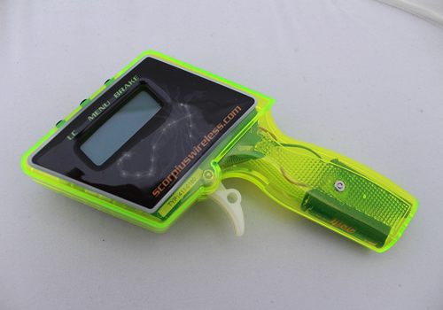

A Scorpius digital controller:

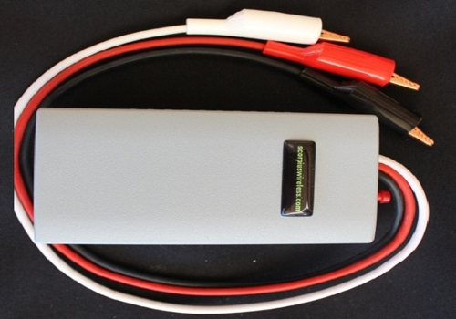

and a WAM (wireless analogue module):
The WAM is plugged into your normal driver position and communicates at 2.4 GHz wireless frequency with the controller leaving you free to wander about the track. It does not rely on line of sight so you can drive your car from the back garden if you really want to!

The controller itself is battery operated and needs a couple of decent AAA ones fitted (Duracell or similar). Poundland cheapies won't do! They are a bit fiddly to replace as you need to dismantle the controller but battery life is generally good and the controller will switch itself off after about 30 seconds inactivity to preserve them.
Before first use you need to set up the controller ID and link it to the WAM. This is easily done in a couple of minutes via the menu button and you are then good to go. It only needs to be done once as the settings are retained in the memory. If other people are also using one you need to make sure they are connected to a different channel or they will clash.There are 24 channels available so this shouldn't be a problem. You can also add your own name to the LCD screen to identify it as yours.

There are two available via knobs on the side of the controller and the settings can be viewed on the LCD screen:
1) Brakes - seamlessly adjustable from 0 - 100%
2) Sensitivity/throttle curve - 10 presets. A USB dongle is also available as an extra and this enables you to alter any of these to your own liking via your PC.
If you use high end electronic wired controllers with a multitude of adjustments available this is probably not suitable for you but, for the average user, they are usually sufficient.

I haven't noticed any real performance difference to a wired controller which is exactly as it should be. It happily adjusts to all my cars and control is smooth and predictable.
Some people may not like just 10 preset curves but I find that they do everything I need.
It is difficult to change the control settings during an actual race as you would need to take your eyes off the car and look at the LCD screen. I never do this as I have enough trouble driving the car without twiddling knobs at the same time so it doesn't bother me.
No maintenance cleaning is required as it utilises a Hall effect sensor rather than a wiper board.
It switches itself off between races so you do have to remember to fire it up again before the green light or you can have an embarrassing non-start!
