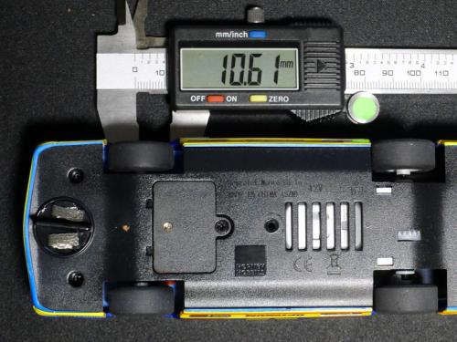

I measured the gaps on both the Thunderbird and the Monte Carlo...
The T-Bird is right on the money at 10.6mm. The Monte Carlo is 23.86mm, right on the limit - which explains the issues with lap counting.

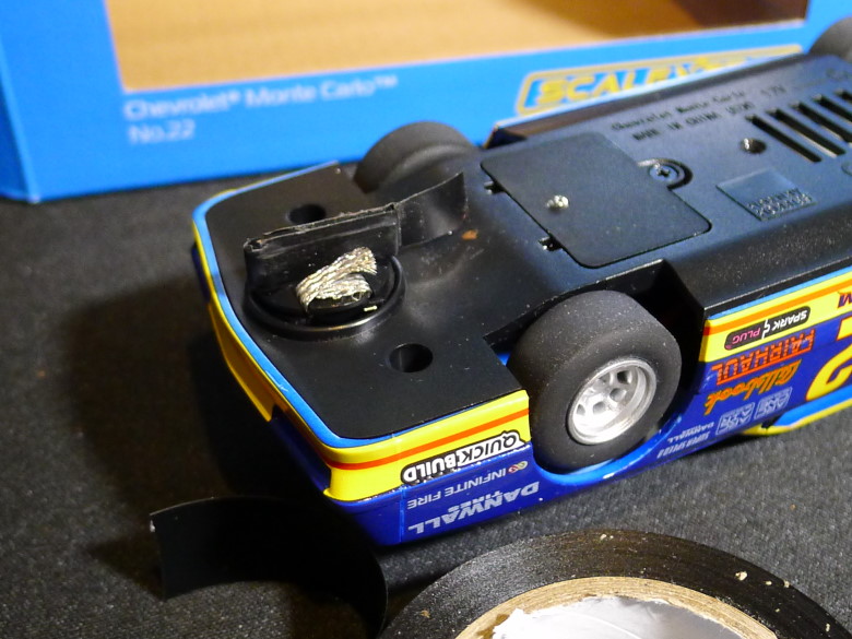

The easiest fix I've come up with is to wrap some black PVC electrical tape around the guide so it trails back to 10.6mm in front of the LED - marked with the gold dot on the picture below.
The tape does add extra width to the guide and - if you will be modifying the car permanently to run exclusively on ARC Pro digital - you could sand down the guide a little on both sides to compensate. I haven't found problems on any of my Scalextric Sport track pieces (including Radius 1s), but the tape does clearly rub. If you have any track pieces that have been bent and the slot closed up at all, the wider guide is likely to get stuck and the slot must opened out again or you risk damaging the digital chip if you gun the motor to get past the blockage.
The first thing to do is to remove the braid plate. Then cut a long length of tape and attach it - one side at a time - to the guide blade, the bottom of the tape just above the slot for the braid plate and then stick the trailing ends together. It is important the tape is wrapped tightly around the front of the blade...
Then trim the tape level with the bottom of the guide blade (or top when the car is up-side-down!) and cut at the back in line with the gold dot marking 10.6mm from the LED...
Then re-fit the braid plate, which will require looping it over the tape extension at the rear of the guide...
We are then ready to race and count laps...
