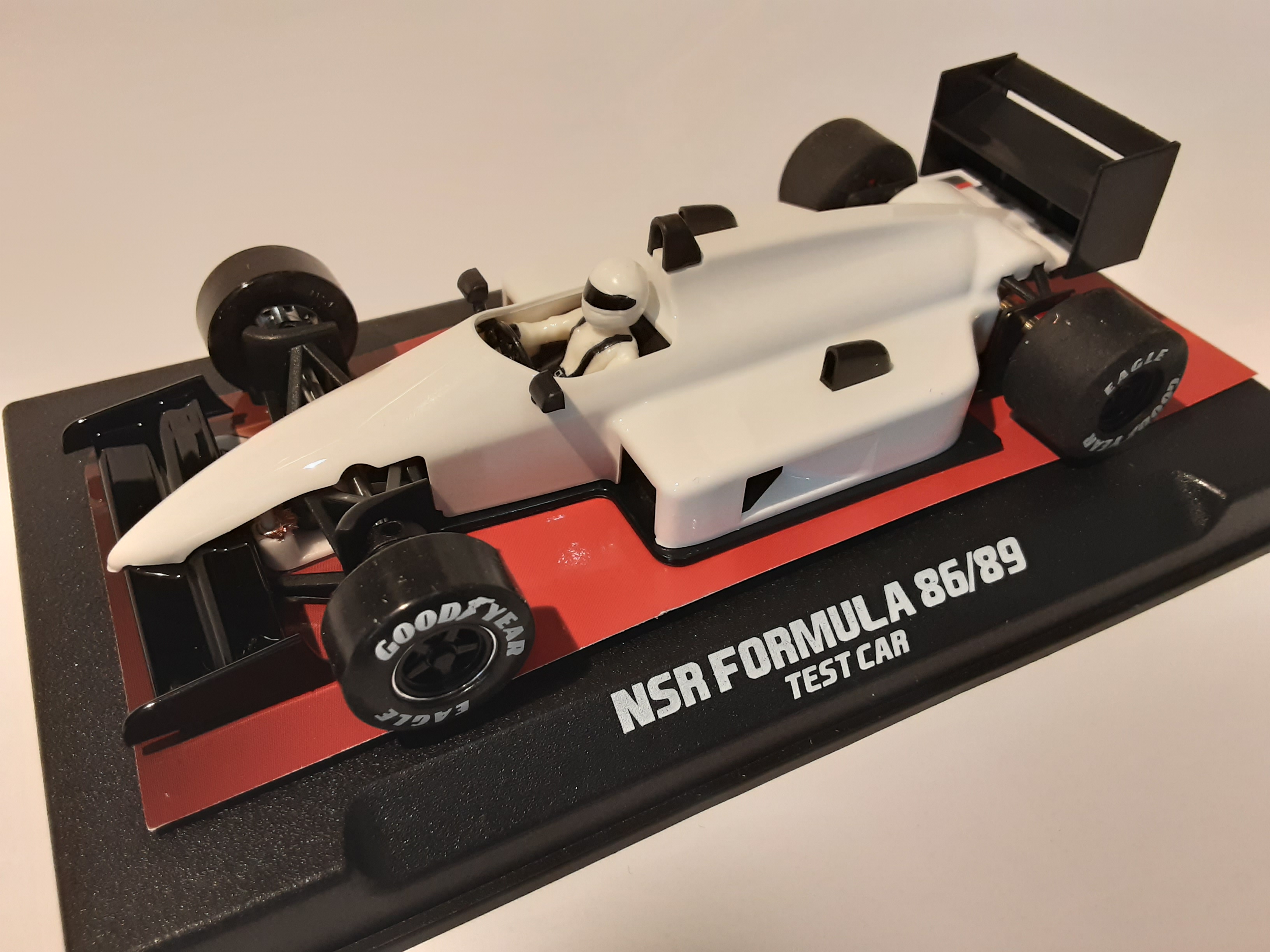

The NSR 86-89 model harks back to a period when many cars did indeed look very similar.
With a paint job and with some decal work, this NSR 86-89 can be a reasonable approximation to most of the cars of that period.

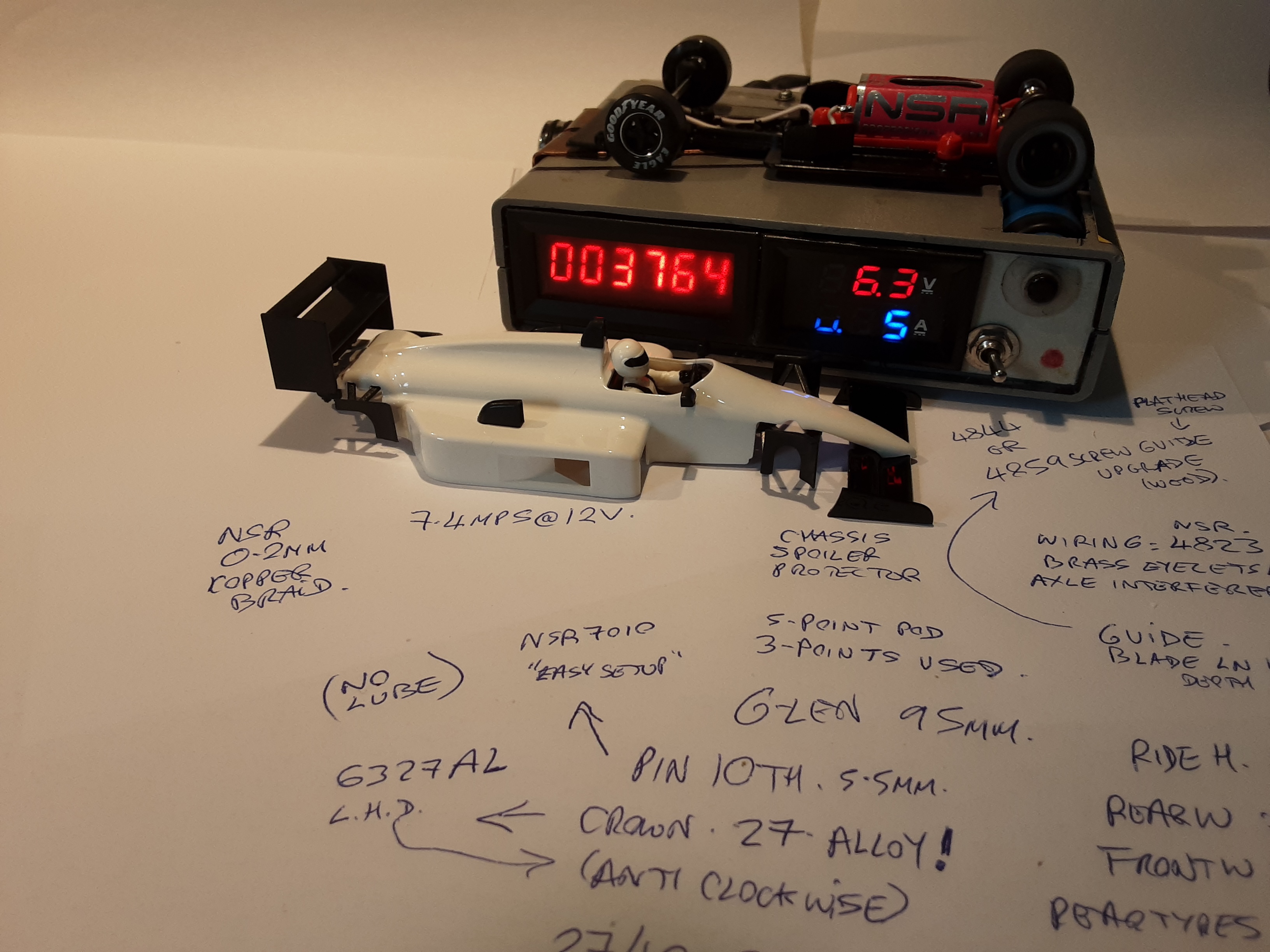

Motor NSR King 21k rpm, 350 G/Cm "purple wrap" fitted with 2xNSR4851 screws.
NSR 7010-10 tooth "easy" pinion.
NSR 6327AL 27 tooth black crown , Alloy as a factory fit !
Crown is factory fitted LHD , the motor is factory fit to run anti clockwise as per NSRs anglewinder cars
Gearing ratio. 2.7
Final gearing : 22.8mm per motor revolution.
Guide length 94.5mm (guide hole centre to rear axle centre)
Weight : 75g of which the body is 10.55g (without screws)
Wiring: NSR4823 white

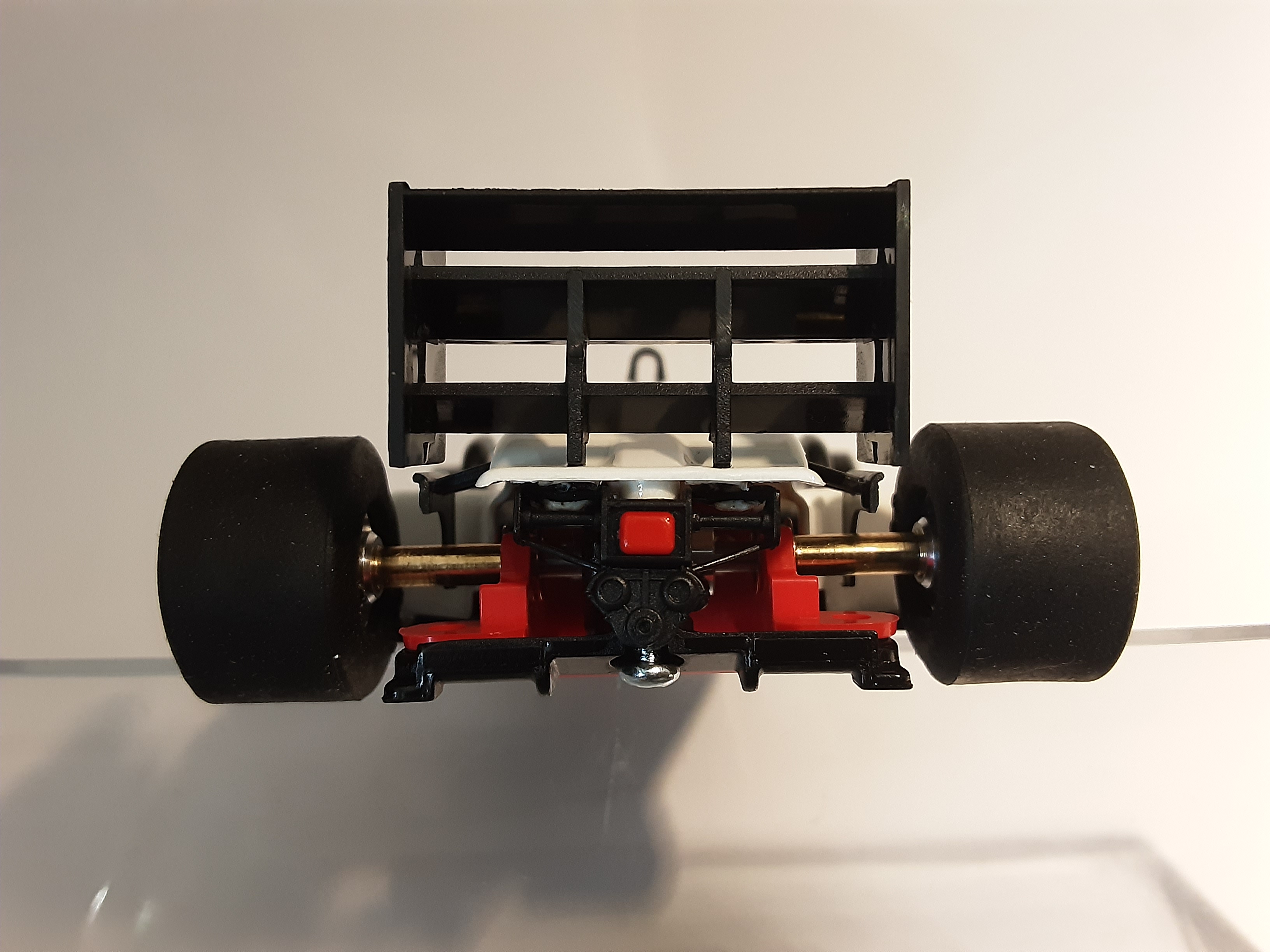

Ride height : 0.7mm out of the box.
The chassis has a front spoiler protection as part of the design.
The Body attaches to the chassis with two screws.
There are set-screw fitting holes to level the front wing and chassis.

How does NSR's proud "ready to race" motto hold up? Quite well as it turns out.
The only build problem was a slightly loose rear wheel.
The car is built with a lot of race-float on the pod and the body.

In Rolling-Road testing, the car ran straight out of the box.
Bench testing on the rolling road indicates 7.4 MPS at 12V which is the expected number for the motor, ratio and tyre size..
Inspection on the setup plate showed the ride height to be lower than expected at 0.7mm
The track facing motor wrap was razored off to prevent it scraping the track in the next stage of testing.
The setup plate showed that the front wheels were lying uncontrolled and heavy on the plate so fitting the enclosed set screws was the next step.

Red (hard) Motor pod, inline long can, 5 suspension points.
No suspension is provided on the factory-fit car.
Pod mounted with screws in the front 3 mount points only.
Initial bench testing.
The magnet and its plastic cover were removed before testing.
