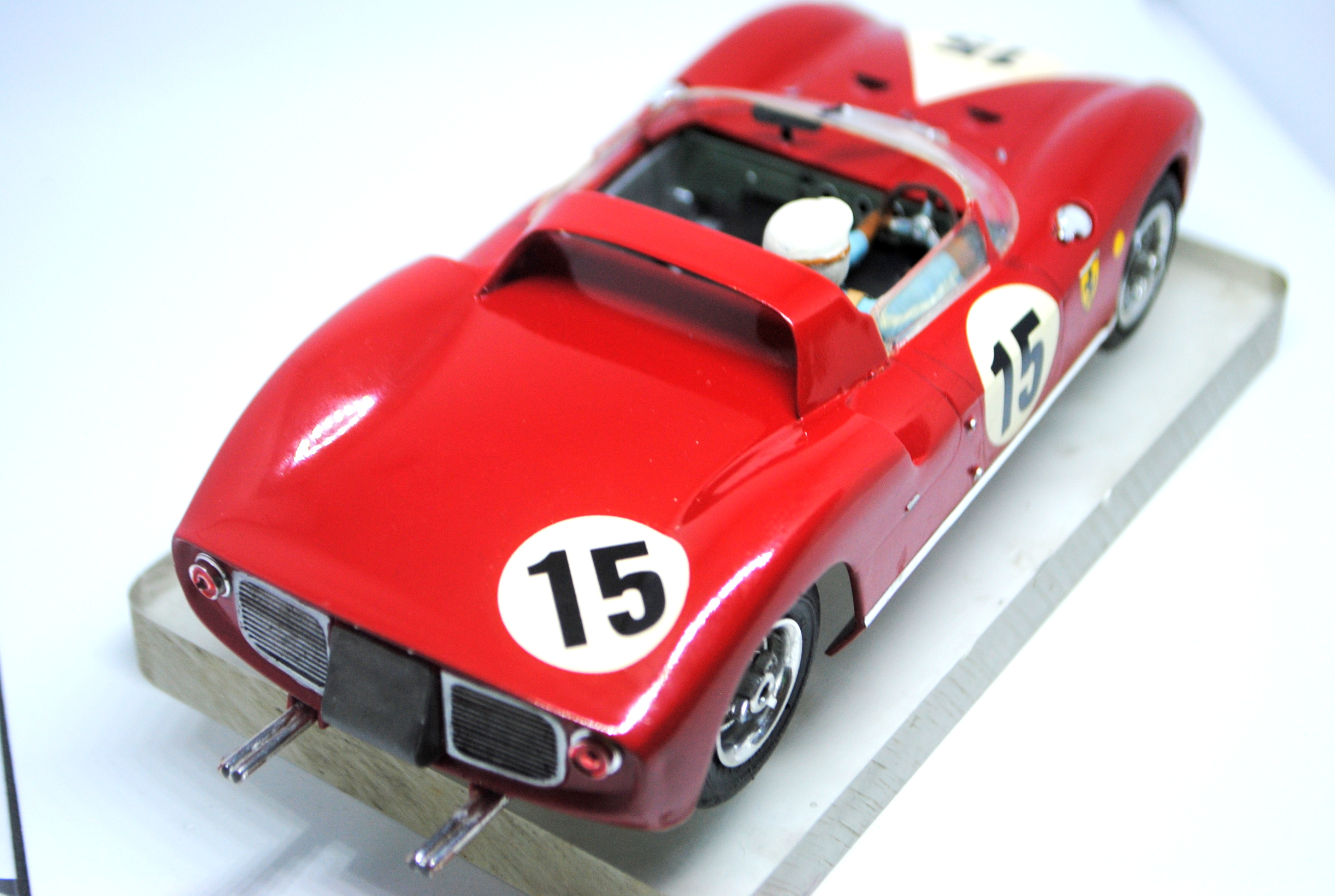

Outstanding Chris - like your idea on the bearings - I have 2 superbly built cars that have K&B Chassis - that I would like to tweak to get a bit more oomph out of the motors....so any advice welcome,
One of the cars I am referring to:
I picked up a collection years ago of parts and must have 20 new crown gears - but no matching pinions - any ideas on substitutes?
