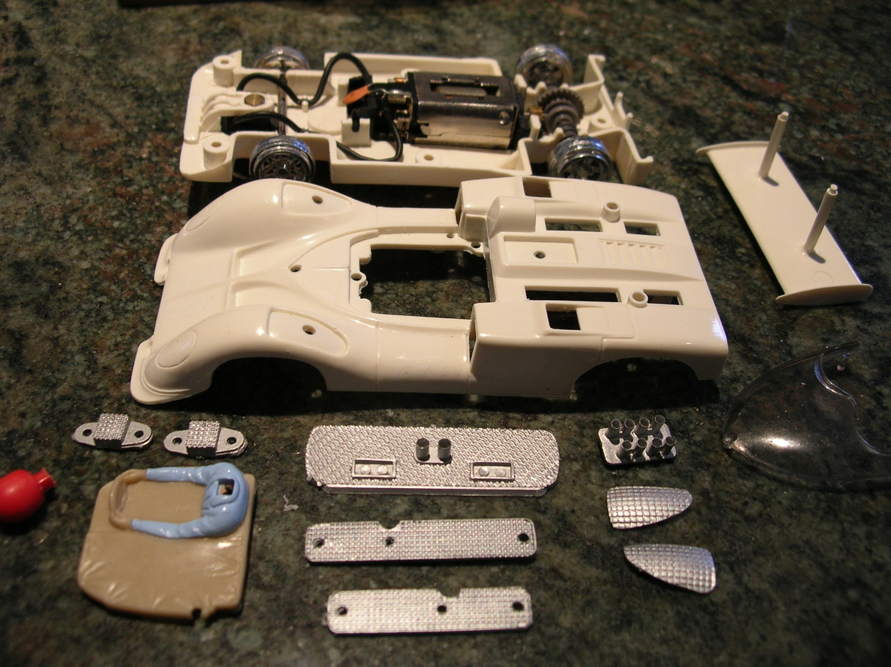

Step 1 (from above post),........all stripped down. and given a quick clean,....good news, no cracks/splits, and no missing bits.
Now to cut the necessary body bits from the chassis, and glue them to the main body.

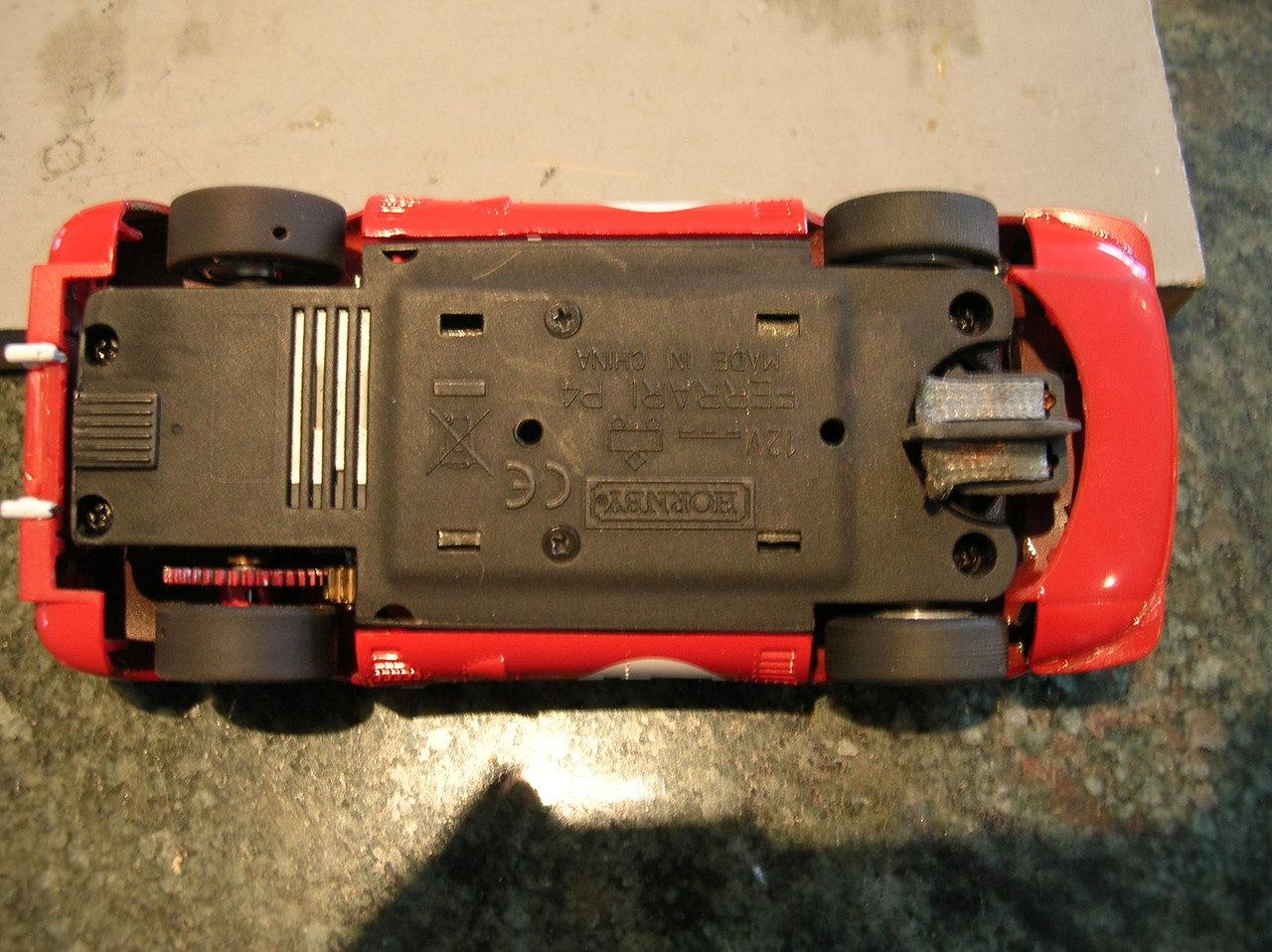

Even if not replacing the chassis, and, if your rules allow, converting a "clamshell" into a separate body/chassis is a very useful modification, as it it is much easier to get, and adjust movement between chassis/body.
Here is a "Clamshell" Scaley Ferrari P4 I did for a club member ages ago,....this was done after the gears/wheels bushings etc. etc. were done and it did make a noticeable difference,.......looks a ton better too !!

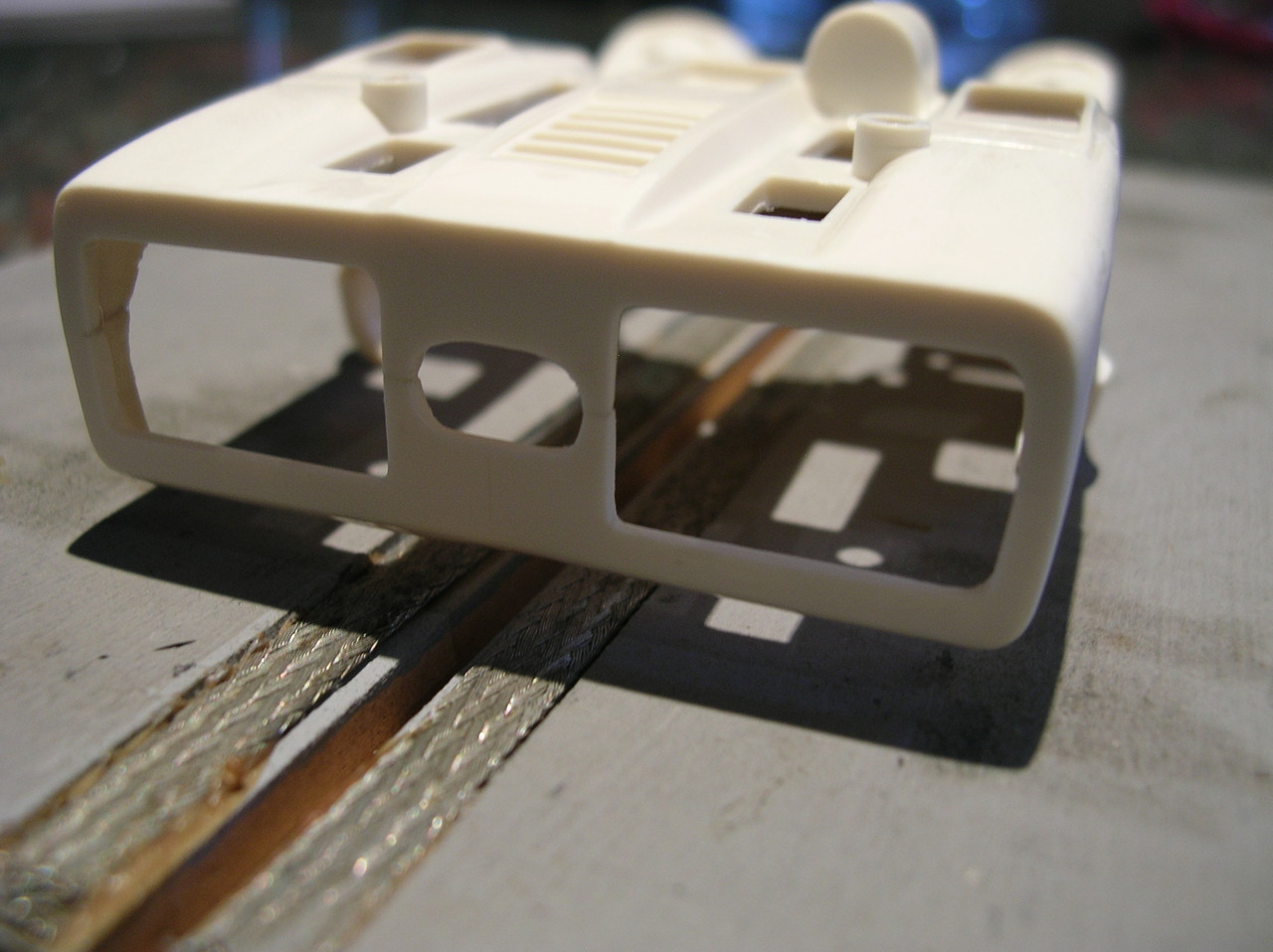

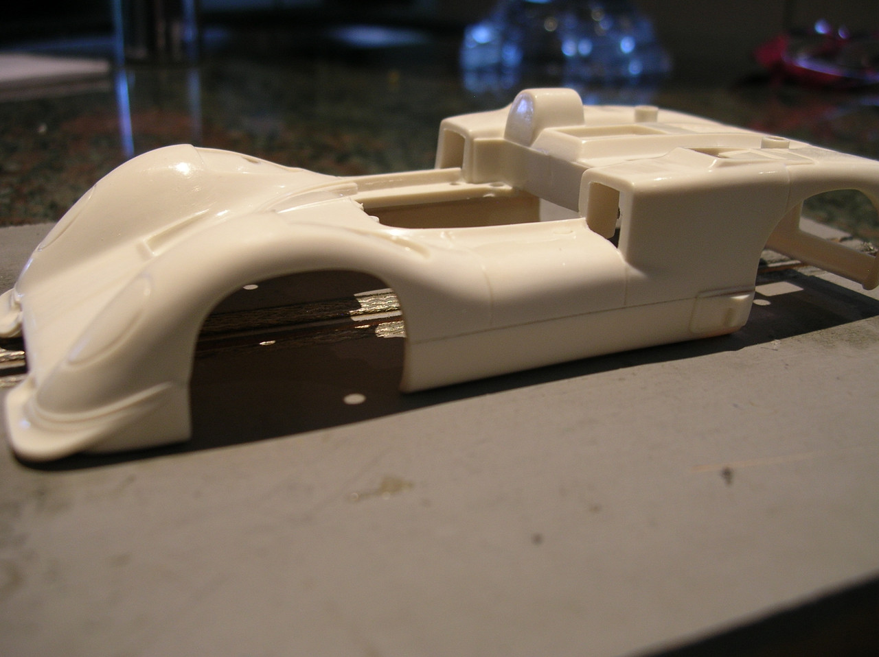

Got the body bits cut off the clamshell chassis, and attached to the main body,........a real pain
, as not much was square/even.
Still need to apply some putty along the back end seams/joins, and a fair bit of sanding to get everything even/aligned. but, even as it is, it looks better !
Chris Walker

I would generally agree,...however. this SCX Chaparral had the rear lights/mesh/exhaust panel fitted into slots in both the upper and lower rear body pieces, so I had to perform some serious grinding/cutting on the rear end bits in order to replace the panel once the 2 rear body panels were cemented together,.....as mentioned previously, way more work/aggro. than I had anticipated, and no where as easy as the Monograms/Revells/Nincos/Scaleys I have done.
Chris Walker
PS In post #833 you can see the "slots" (at the rear of the chassis part) that hold the rear light/exhaust/screen panel,....the factory would slide this panel into the slots on the chassis, slide the slots in the top body section over this panel, and screw the whole mess together,...... without some very serious grinding there is no way the panel could be inserted from the inside, once the top/bottom body section were glued.
