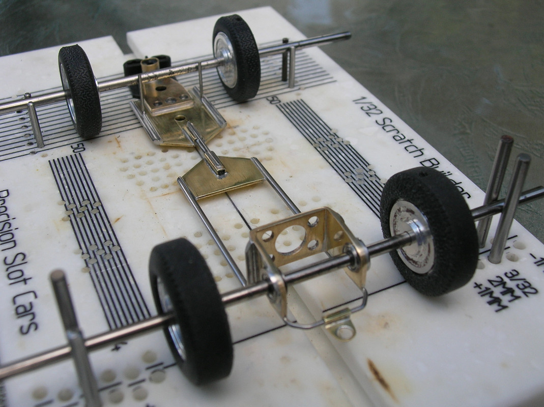

Not looking forward to the body, I started on the chassis...........a typical flexi board design, partially done.
![[Image: 2003-12-31-23-00-00-120.jpg]](https://i.postimg.cc/pTJdD2VS/2003-12-31-23-00-00-120.jpg)

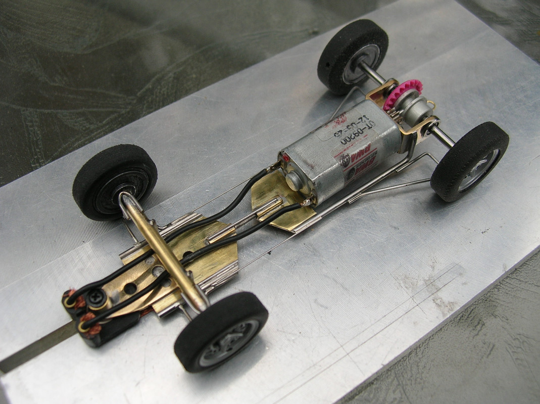

Chassis completed with the mandated BWA FF050, and 7mm wide tires.
![[Image: 2003-12-31-23-00-00-122-copy.jpg]](https://i.postimg.cc/ZR4bY1Px/2003-12-31-23-00-00-122-copy.jpg)
![[Image: 2003-12-31-23-00-00-134.jpg]](https://i.postimg.cc/7hBYWm2M/2003-12-31-23-00-00-134.jpg)

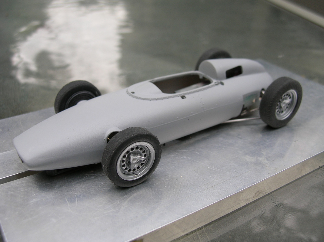

On to the body.........once all the bits were taken off, and the driver and his base were cut out,......it started to look better
![[Image: 2003-12-31-23-00-00-107.jpg]](https://i.postimg.cc/Qt3t9BD5/2003-12-31-23-00-00-107.jpg)

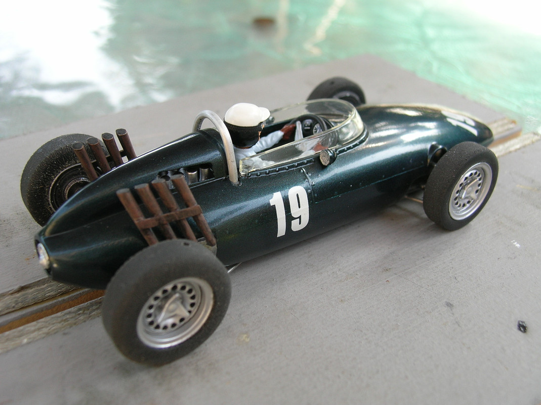

I made a few suspension bits, added some gauges, stuck in some BWA "Dunlop" inserts, and installed a more realistic looking Mr. Ginther............. and while it is no doubt a bit "porky, considering the starting point, I am quite pleased.
PS This car fared well, winning the VRAA series.
