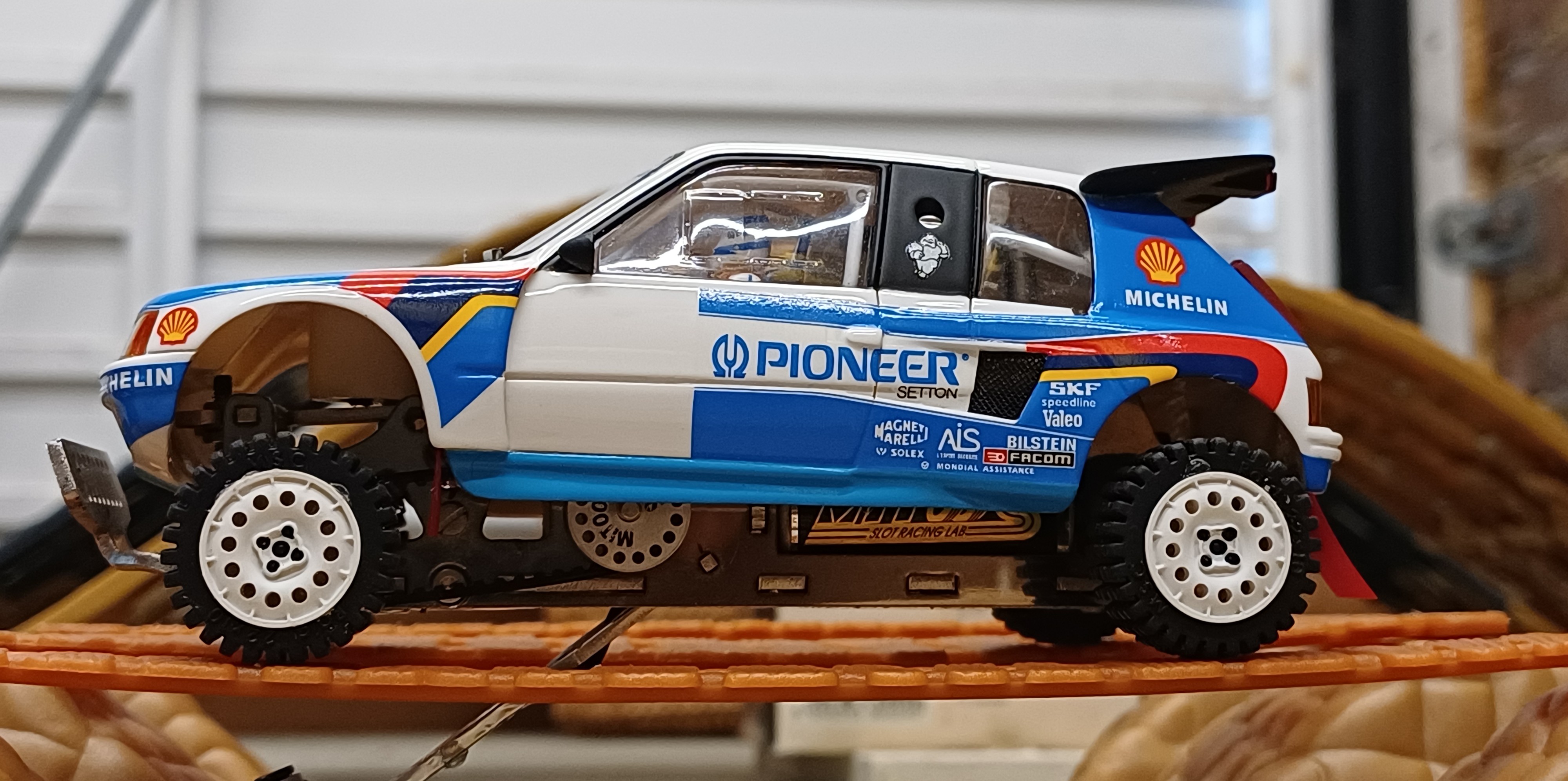

Dakar Raid mode in full flow in my garage. So dug out the 205 resin body I won in the free raffle at FDD5 last year and am in the process of fitting it onto a Mitoos chassis.
Its a heavy body, and when added to the lump of a chassis, its a solid combination! But its not a car you see racing, so worth the effort.
