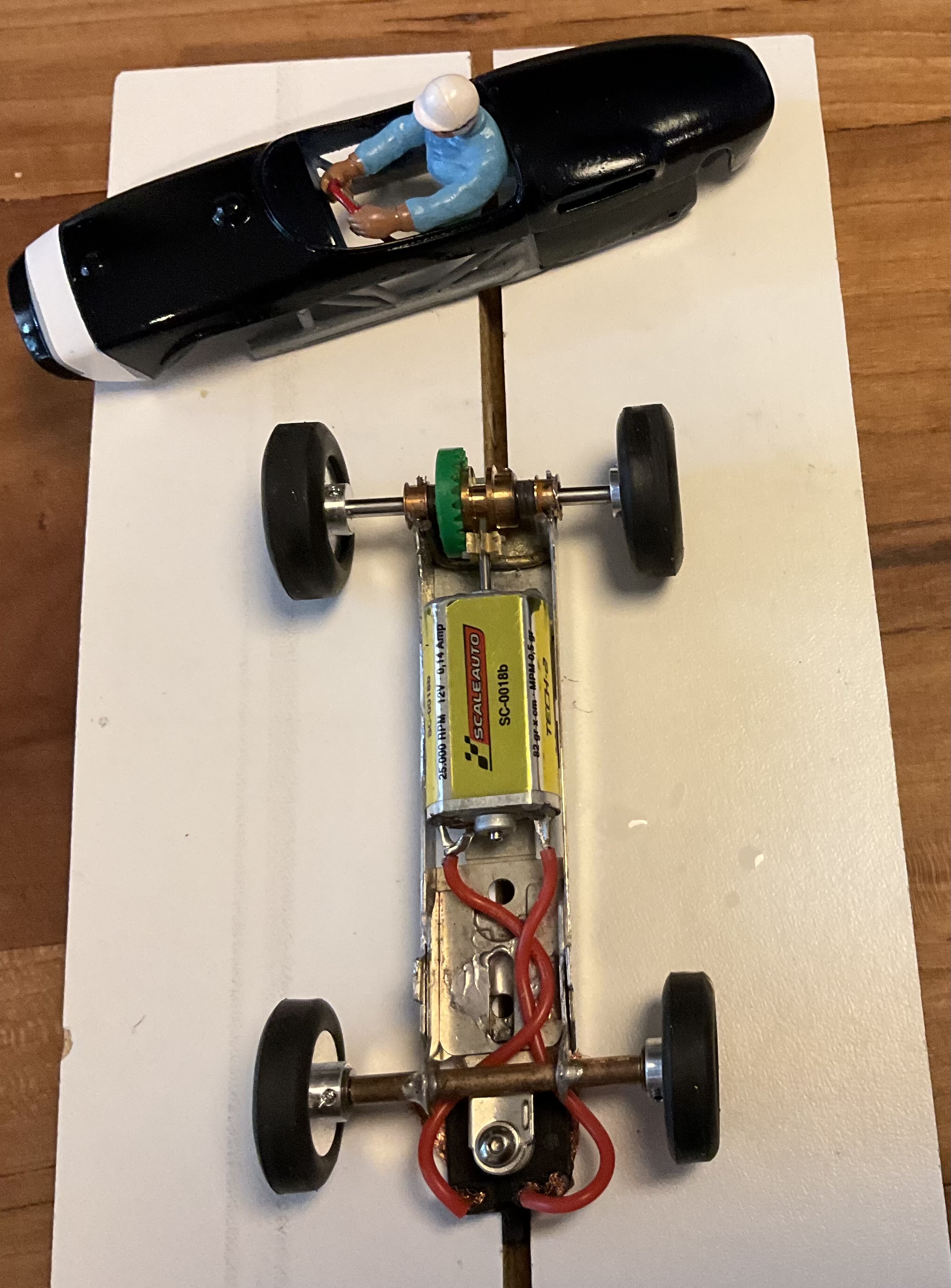

(16th-Sep-25, 09:32 PM)mickey thumbs Wrote:  Munter, great minds think alike.  Thumbup   Here is my take on rear support.
A 1/16” U brace soldered in place as are the bearings.
Hi Mike, Next time you use these bushings, (especially when using a very narrow chassis) , place the bushing "relief" to the inboard side,.......this will slightly widen the effective support surfaces  of the bushing on the axle, improving the resistance to twisting/tilting of the axle, and therefore improving both bushing and gear wear.

I did eyeball that myself and thought the same thing, including pushing the bushings out as far as possible.
Bearings in, bearings out......building really narrow (scale accurate) GP cars is challenging.
Either placement works well enough but how much body work needs to be removed to get the body placed correctly can often be a factor in your decision.
The lotus 18 falls into the "medium width" group of available bodies in my experience.
I look forward to seeing the end result.

The Lotus is coming along. The body is a work in progress to say the least. But the chassis is finished. I swapped the provided 18K motor for a Scaleauto 25K. It has a shorter shaft so the stock motor mounts didn’t work. I bent them back flat and soldered the motor in place and set the gear mesh using spacers between the rear bearings. 8/27 ratio.  A front axle tube was installed as Chris suggested.
Preliminary runs of chassis suggest it will be near the Policar 70’s F1 cars, limited by its high COG. A little lead under the chassis should help that.

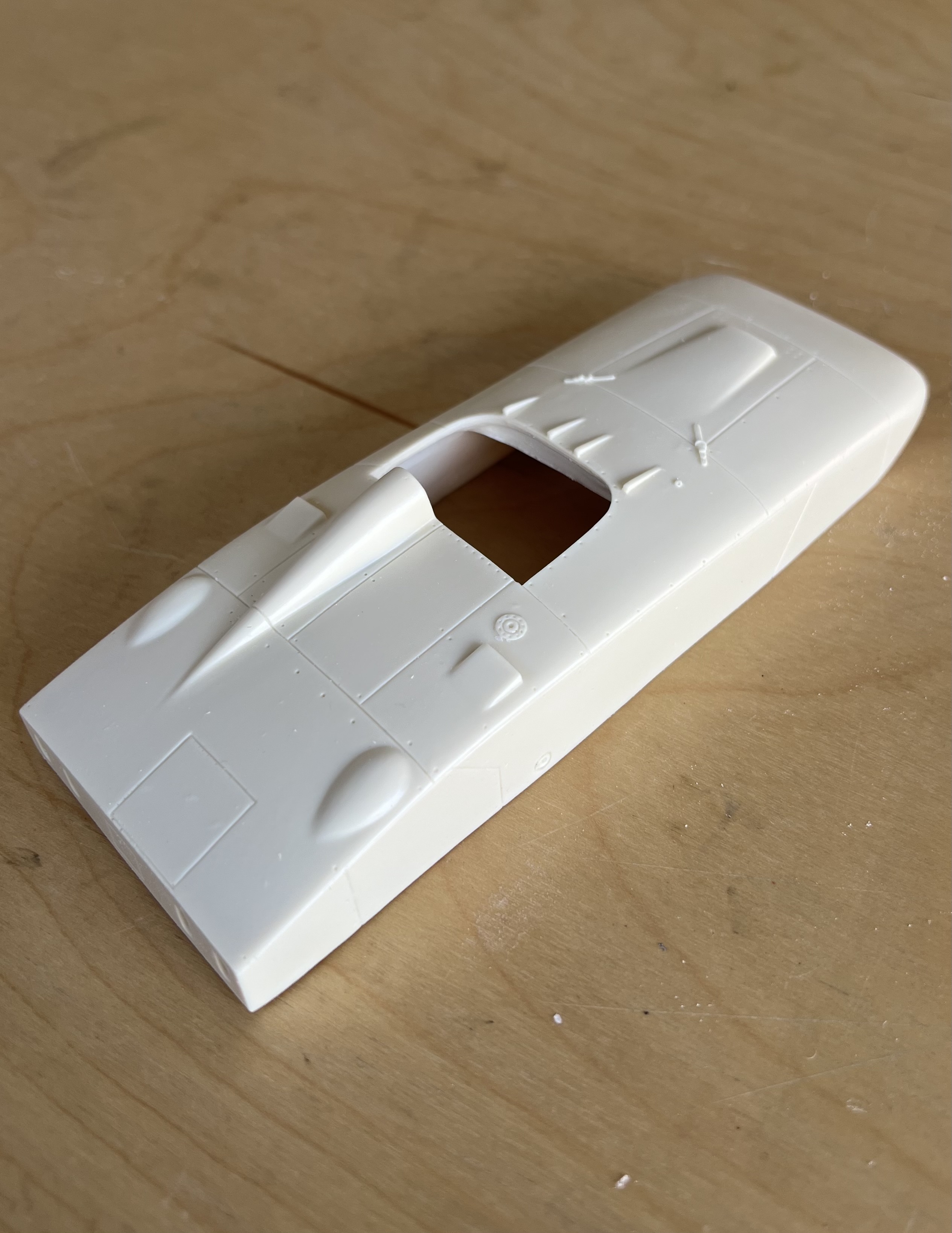

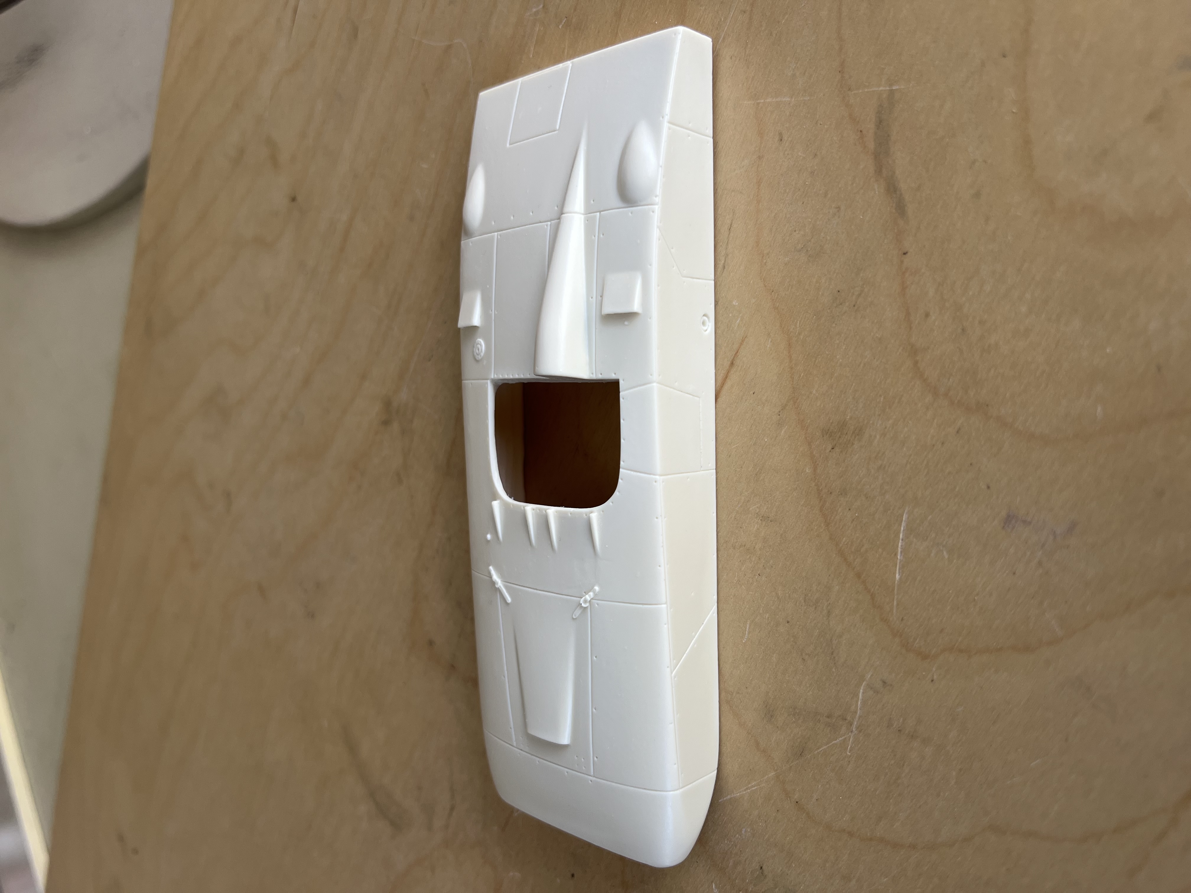

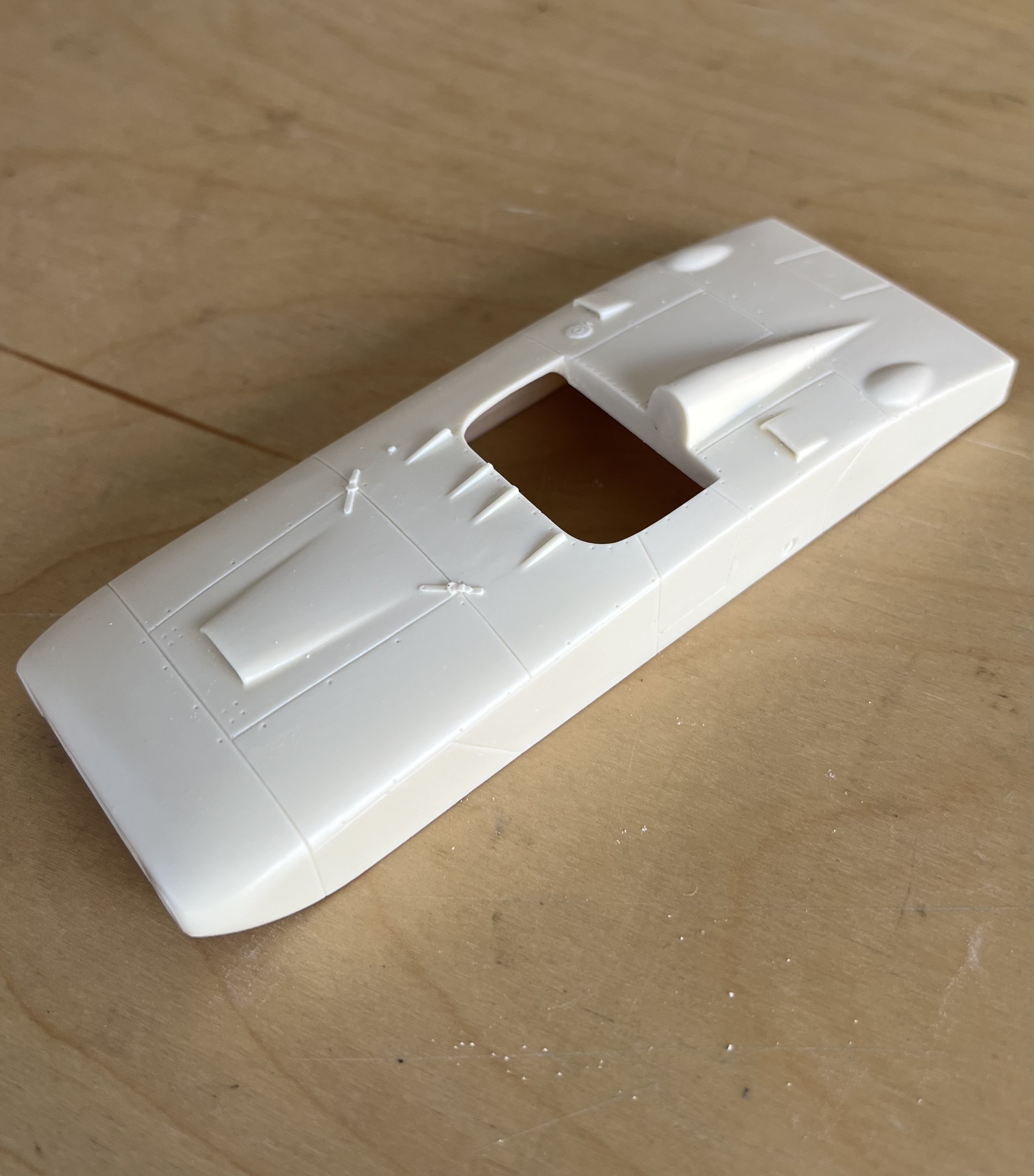

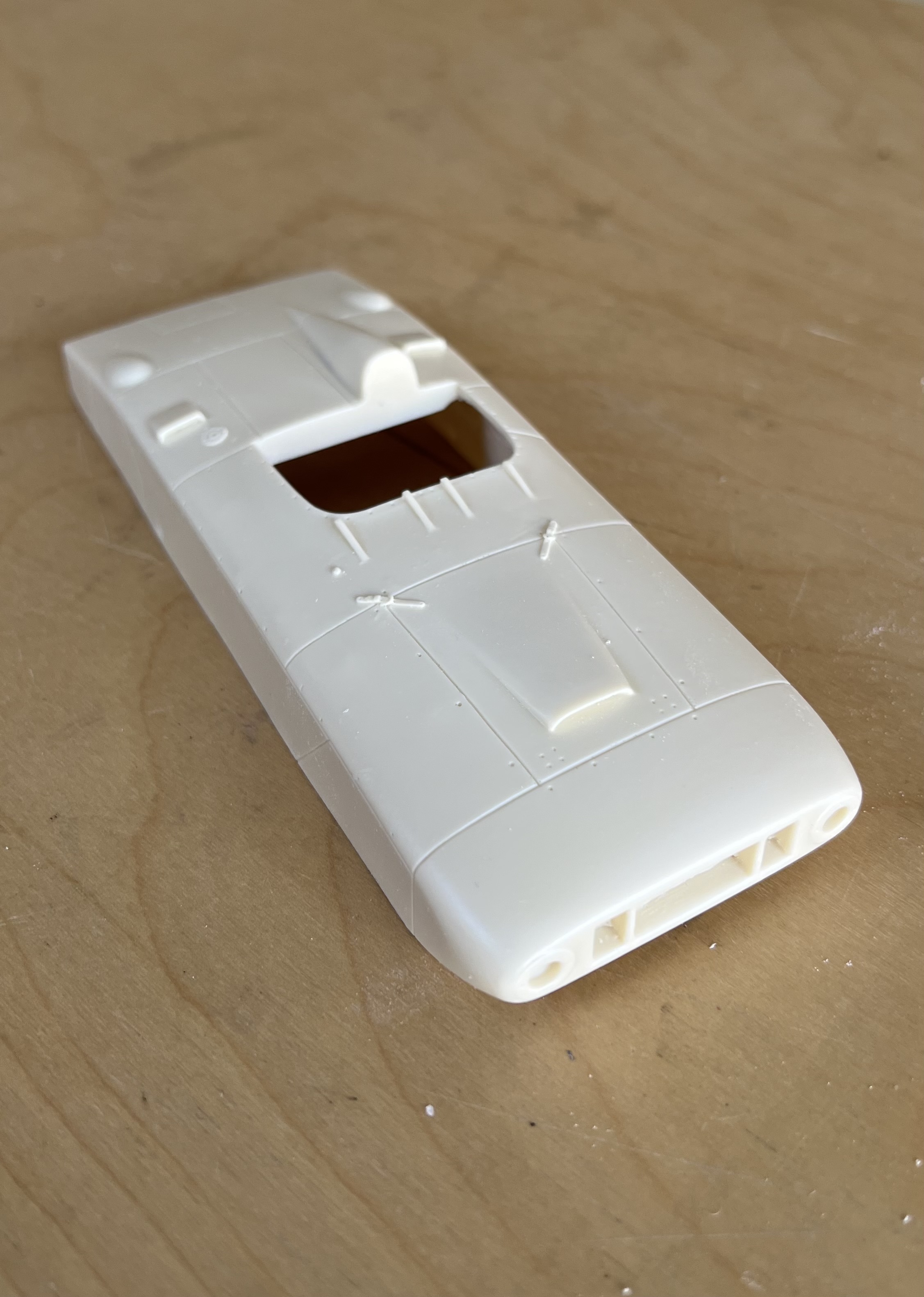

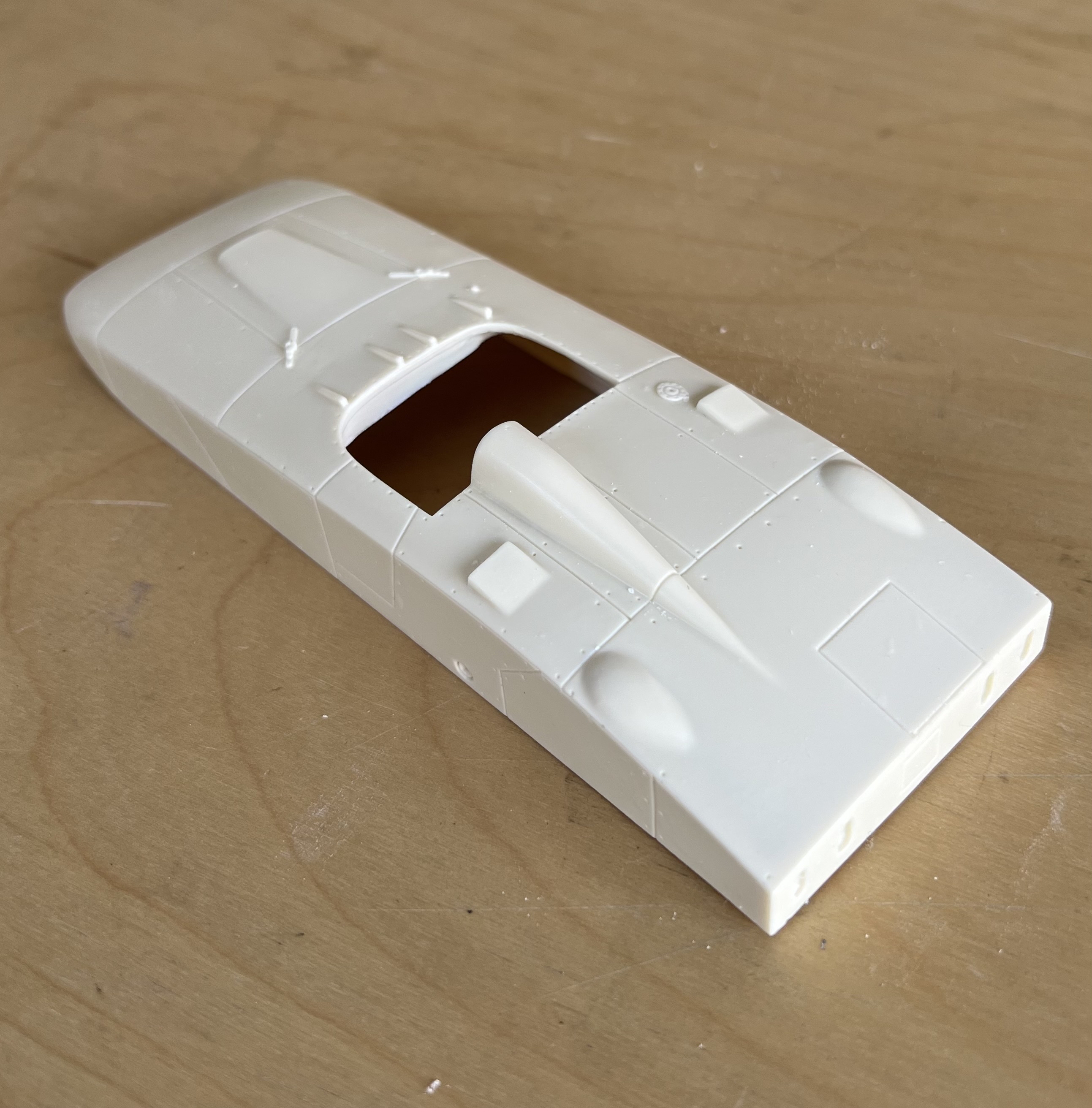

I bought this Strombecker Ford J-car body at a recent flea market for $15 Cdn (8 quid). It seemed in reasonable shape at a quick glance.
I took it home and dissassembled it. Then dropped it into a cleaning solution. It's in better shape than I first thought. Most of the red pen marks came out. It still had the original rear window which is rare to find.
The wheel arches are clean, and were never touched by a file or any other nonsense.
The interior has nice chrome radiators on each side.
I'm not exactly sure what to do with it yet. Ideas are brewing.
