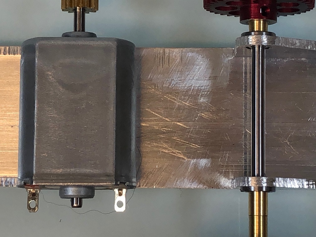

The spur is a 38T x 19mm dia by MrSlotCar. Pinion is an 11T x 6.5mm dia. The motor is a 25k Fox-10 from Professor Motor.
Dry test fit to make sure the pinion is centered on the spur. The motor is locked in and touching everwhere the arrows are located. The pinion is touching the spur. The motor is pushed in and up into the aluminum chassis.
I had to come up with an easy way to create backlash. Locking the motor into the chassis was the ticket.
The epoxy surfaces are too shiny. Nothing a little 150-grit sand paper won't fix. Clean well after sanding.
Soldering the wires to the motor would be wise before motor goes in. Heat and urethane tires don't mix. Ask me how I know?
I used an off-cut of scrap aluminum from a chassis as a spacer (1.5mm). I apply the 5-minute epoxy to the motor, and lock it into the chassis. Then slide the spacer between the axle and motor to create the backlash. Hold for 5-minutes and it's done.
How much backlash is another topic. Too loose or too tight are both bad.

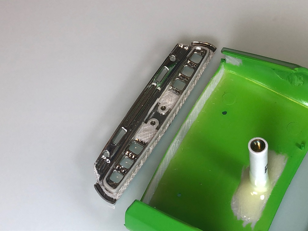

These were designed as static kits. A touch of glue will usually do for a static model because it never has an off.
The prep is very important if you want it to survive as a slot car. These cars have experienced some very hard hits, and they still survive.
Besides removing the paint and chrome. A box cutter with a fresh blade was used to mark X's on both glue surfaces and surrounding areas.
While holding the car in one hand. The front bumper was held in place with one finger. 5-minute epoxy was liberally painted on the inside of the car. The car was held nose up to prevent expoxy from seeping past the bumper.
Same treatment for the rear bumper.
The extra weight is worth the improvement in strength. It's starting to look like a car now.

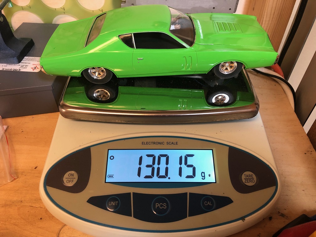

The all up weight is just over 130-grams. The target weight is 140-grams.
A piece of 2" inch brass by 0.032" thick does the trick nicely. Cutting a piece just over an inch wide should give about 10-grams of weight.
A line is scribed down the center of the chassis, and the brass weight. The mating surfaces are rough sanded with 150-grit sandpaper, and wipe clean. Then the weight is epoxied to the chassis with both lines lined up. A clamp is used to keep it in place for 5-minutes.
The weight hangs under the chassis at about 1.5mm off the track. Stick-on lead weight can be added to the top of the outer wings if needed.
