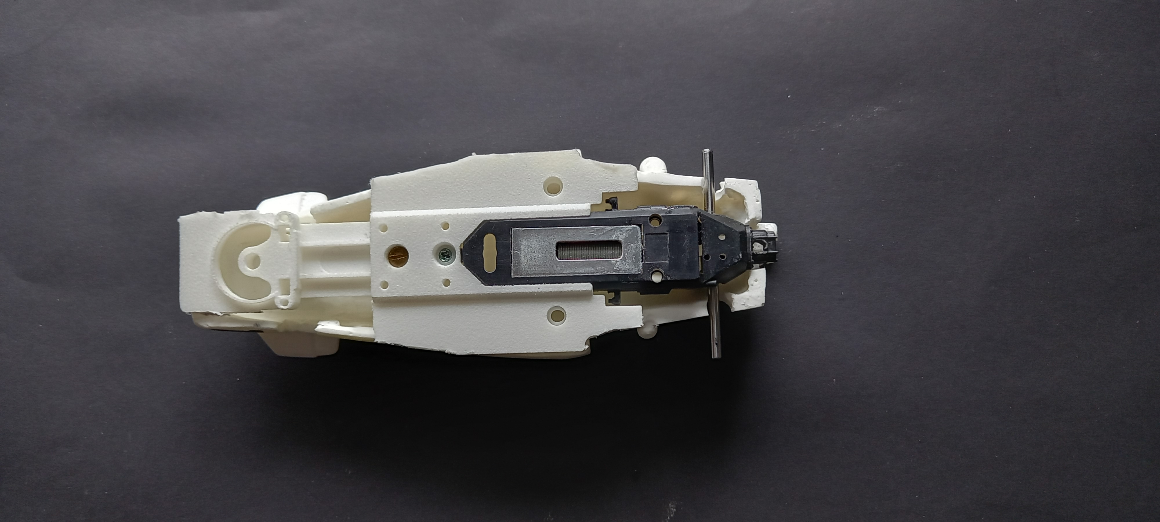

Picked this up at Cobham as well as the other shells highlighted recently so well worth the trip. Mostly intact body wise, but prime for conversion so out with the miniature circular saw and sectioned the under pan chassis as shown to drop in one of my sprung Goodwood chassis’. Remaining under pan parts superglued or screw retained back on and new body posts resin glued in to suit the new chassis.
Now its is boxer powered (Scaleauto SC0025b) and goes a lot better on its PSR alloy wheels, tyres and 10:24 gearing than the original S can powered chassis.

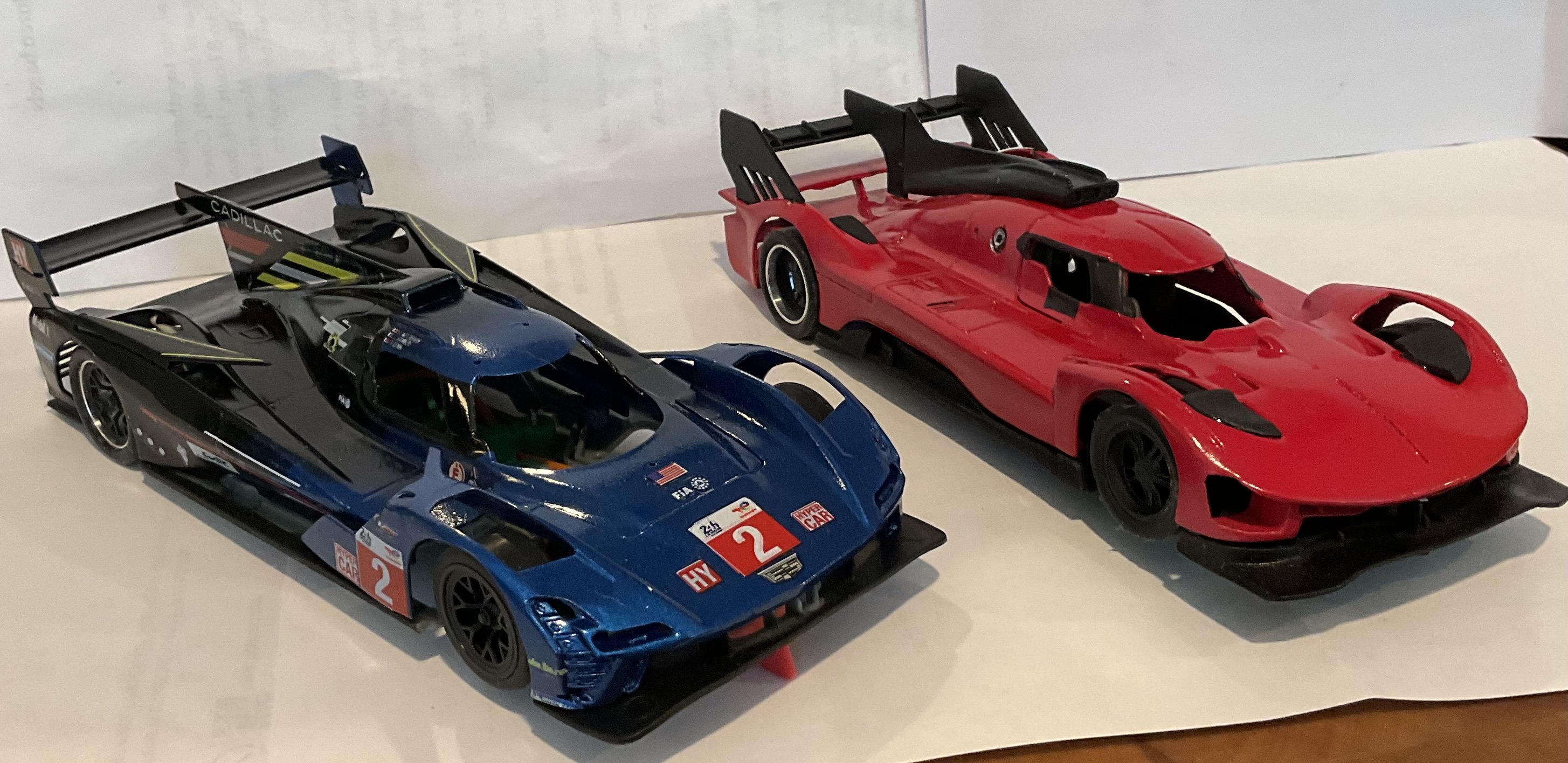

Very slow progress on my Hypercars. Life got in the way between purchase and today, so much so that the factory liveried Scaleauto Cadillac has been out for a while now. But it was fun to try the blue/black fade with rattle cans.
Decals, detail parts, clear coat for the Ferrari and clear coat and clear parts for the Cadillac. I don’t even want to think about the vac formed windshield for the 499.

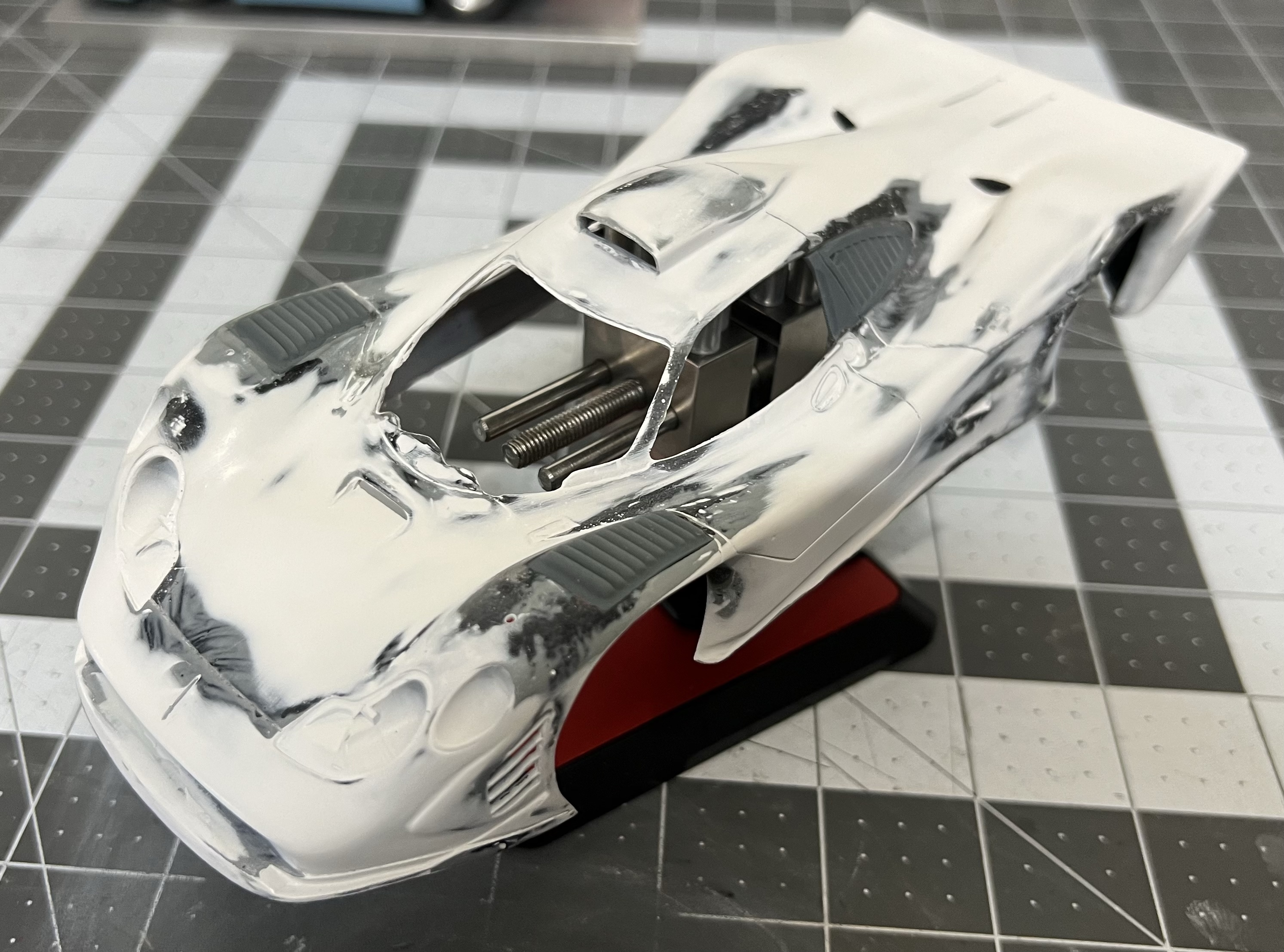

Working on this one…..

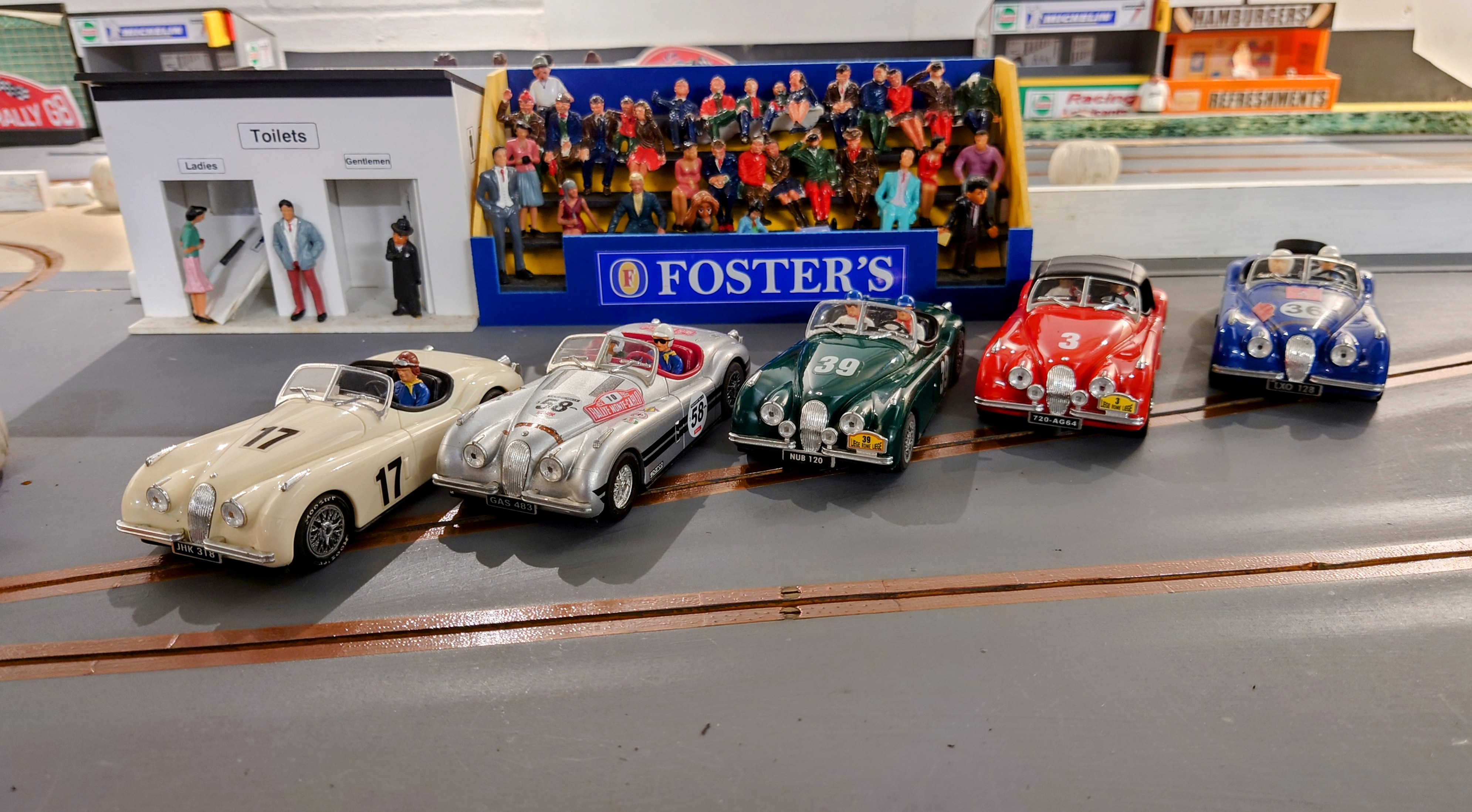

White Jag XK120 finished recently...now the gang of 5.
All have a different chassis (the red one is all standard Ninco apart from the rear tyres.
