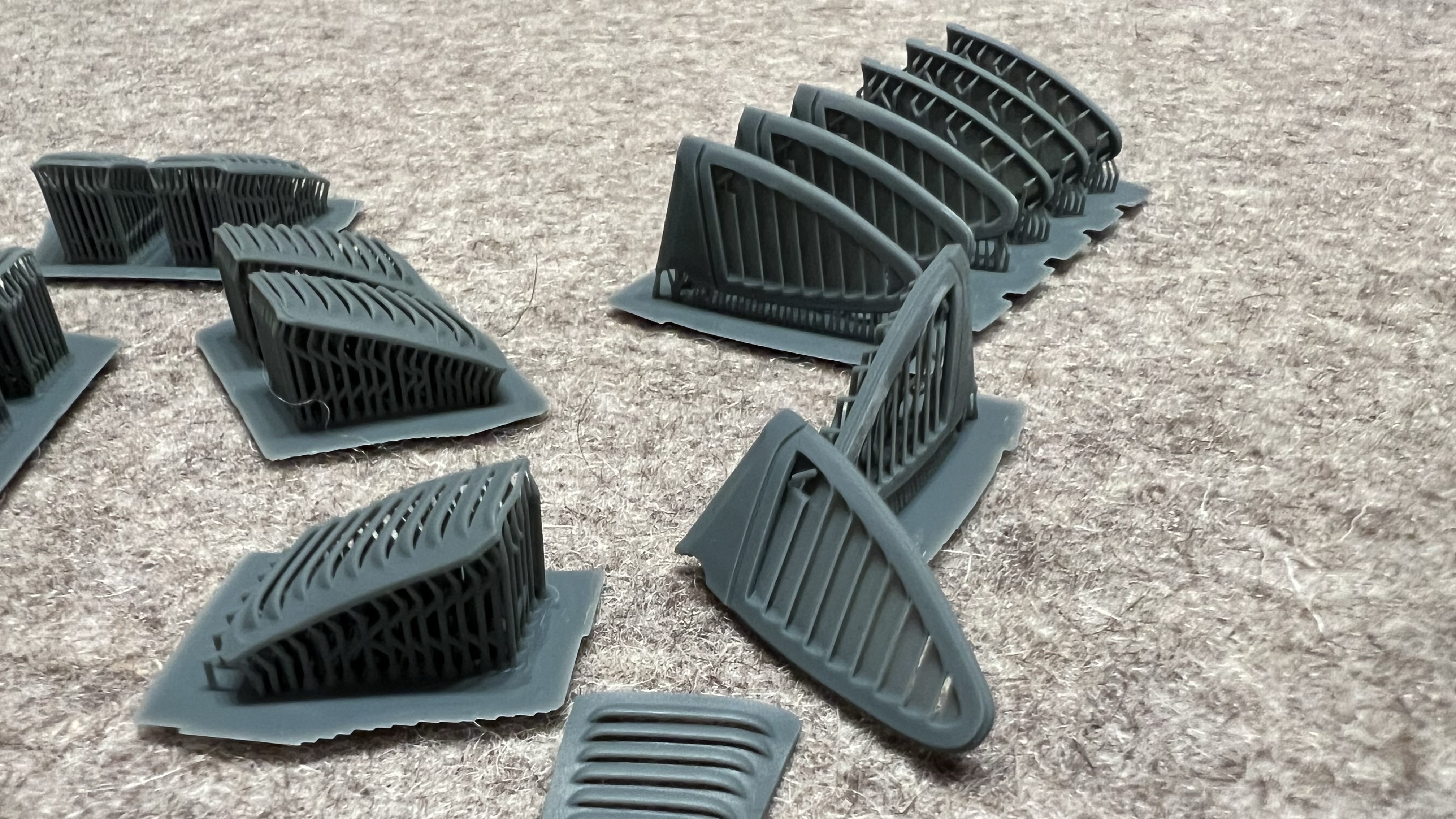

Update... the chassis in the pictures is the wrong chassis for the 911 GT1 - I'm waiting for the correct chassis to arrive. I've made a lot of progress on the body, and the detail parts have arrived from the printer, now I have to install them.

Started fitting the new 3D printed parts with epoxy. I'll fill in all the gaps on the next mix, this was just to be sure the alignment was correct.
