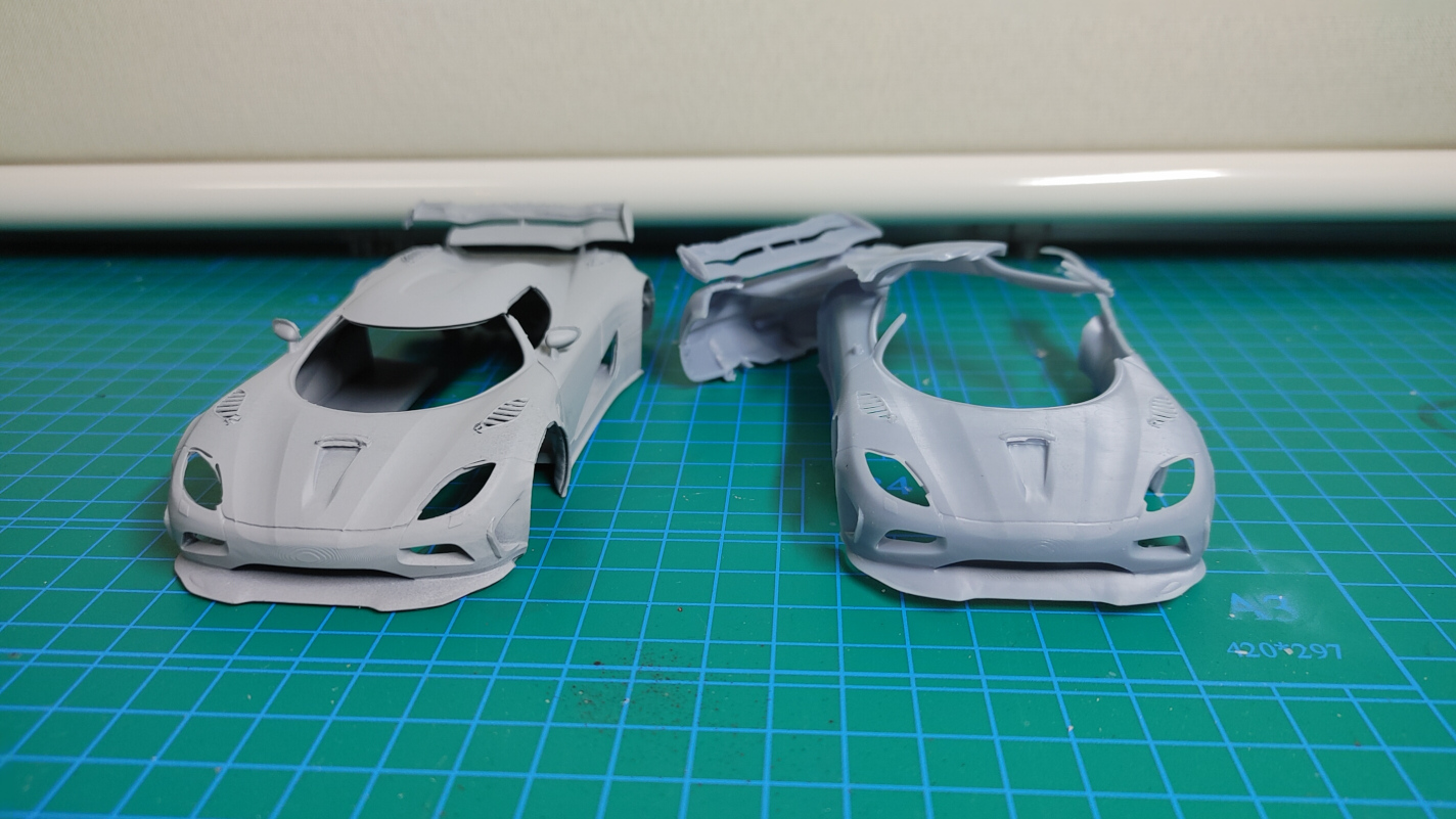

(18th-Nov-24, 08:43 AM)Kevan Wrote: Although it takes much longer to print vertically you don't end up with a 'camel hump' on the roof like you do if you print them flat.
...I hope that ABS-like 3 is tougher than the ABS-like I used 2 years ago...prone to smash in a bad crash
Recently before a club race I was seeing some of the bodies that members had painted ready to start racing and one other member was trying out on the track. I had run this on the track previously and had a fair few crashes. A few body cracks and lost side mirror was the extent of the damage though. But one guy at the club had a big off and the car hit the concrete ground with some force and the rear completely shattered. So ya the ABS is still quite brittle.
Having said that, I have been testing some other resins and making mixes with some more flexible resins with the ABS. As they are having a demand for this and offered to pay for bodies as the "durable" resins are more expensive, I wanted to test them for the durability. So I got a body printed with standard ABS resin, and another with a mix resin and dropped a weight on both from a fixed hieght. The ABS shattered while the mix resin actually bounced the weight back into the air. Suffering just a small break on the rear wing.
So much more durable, but more $ and is tricky to work with. Longer print times too as after calibrating for mix resin the layer exposure times were much longer.
I will keep playing and learning :)

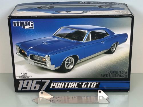

Just when we thought everyone in our group had a 1/25 Boulevard Cruiser (or two). Someone new shows up that wants to join us, and needs a car.
I was asked to make a chassis for a '67 GTO. The chassis is done. That changed into building a full car including paint. I'm always happy to help.
It's an amazing looking muscle car. My friend is leaning towards bright red for a colour.
