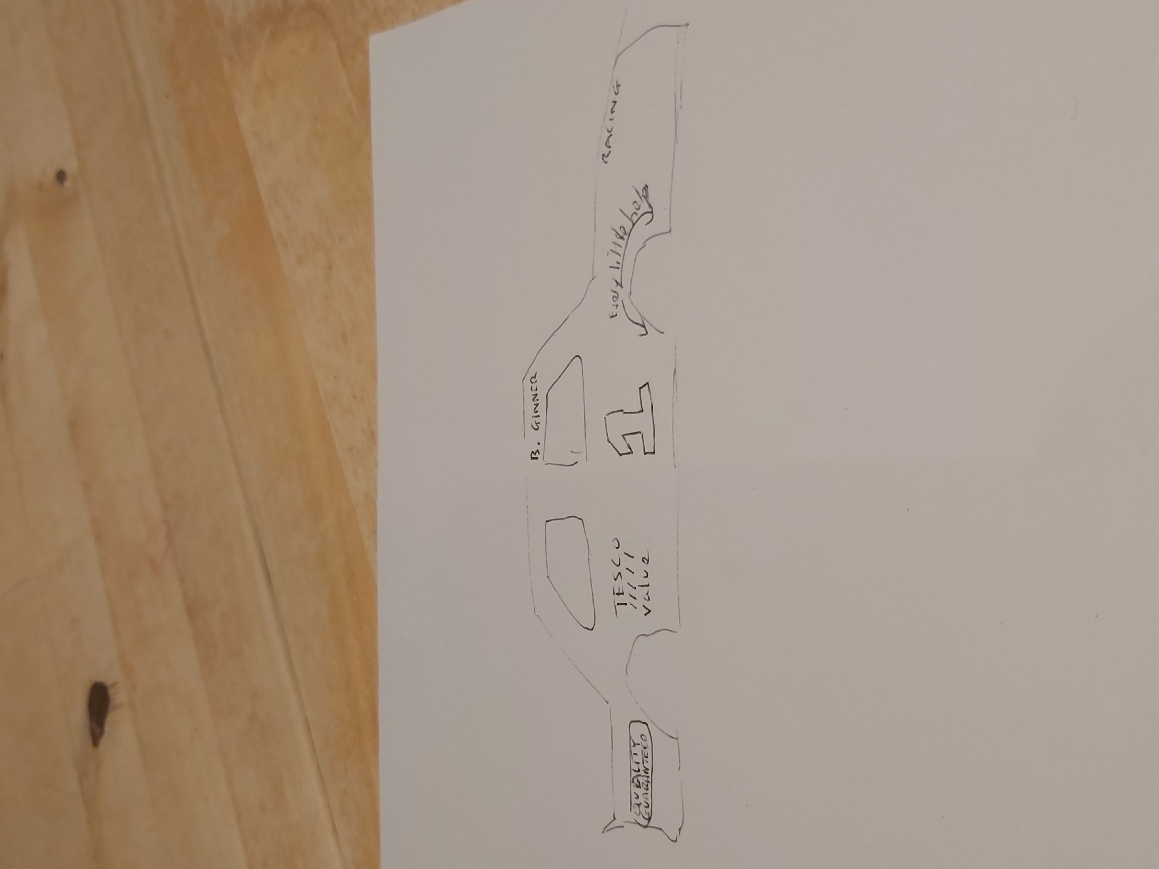

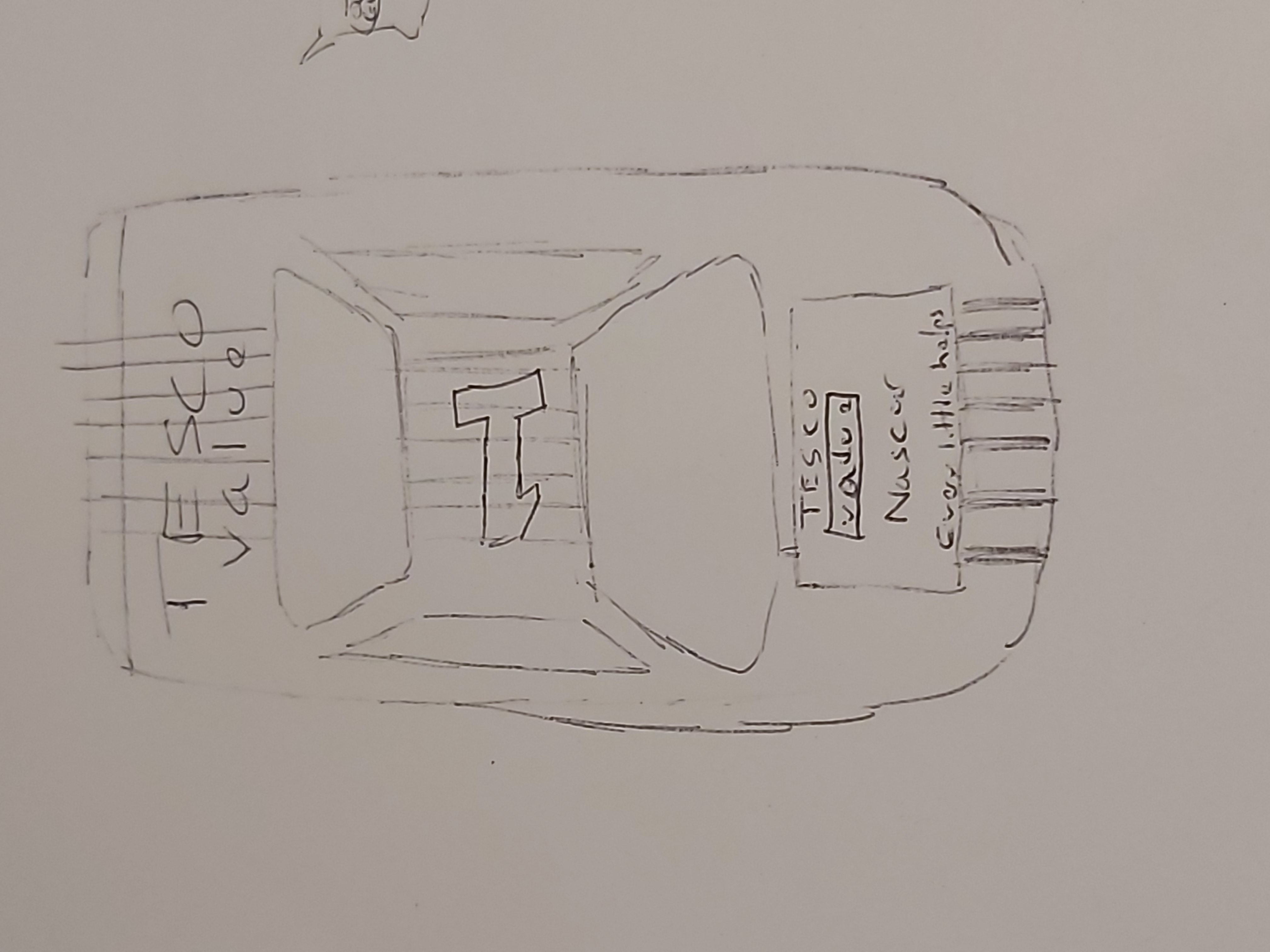

Here's a rough sketch of what I see the car as being. Please excuse my appalling drawing skills which go along with my rubbish graphic design....and sense of humour!  Bigsmile
This is the Value logo I'd like to base the car on which would go on the bonnet/hood. Might be better to say Racecar so that it is multi purpose for other people.
And then here is the top and side view. Its basic but I think that works and would look cool.

I'm assuming that this is for an HO size car, so please send me side on photo with the width, overall length and height dimensions.  I think that the way to it is to do the blue stripes as a base decal and put the number and bonnet label on afterwards. Assuming a white body colour.

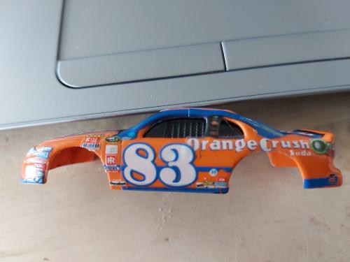

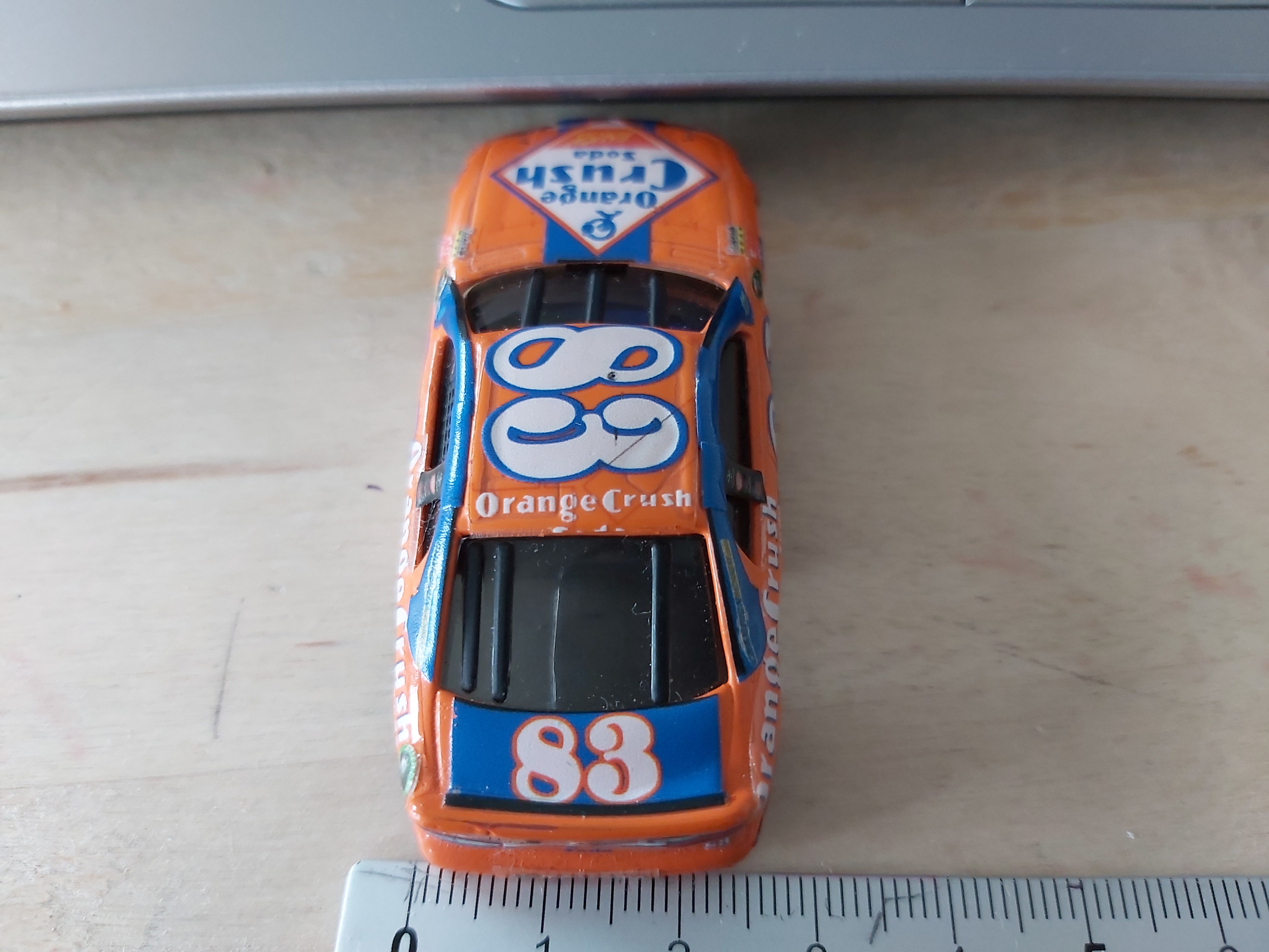

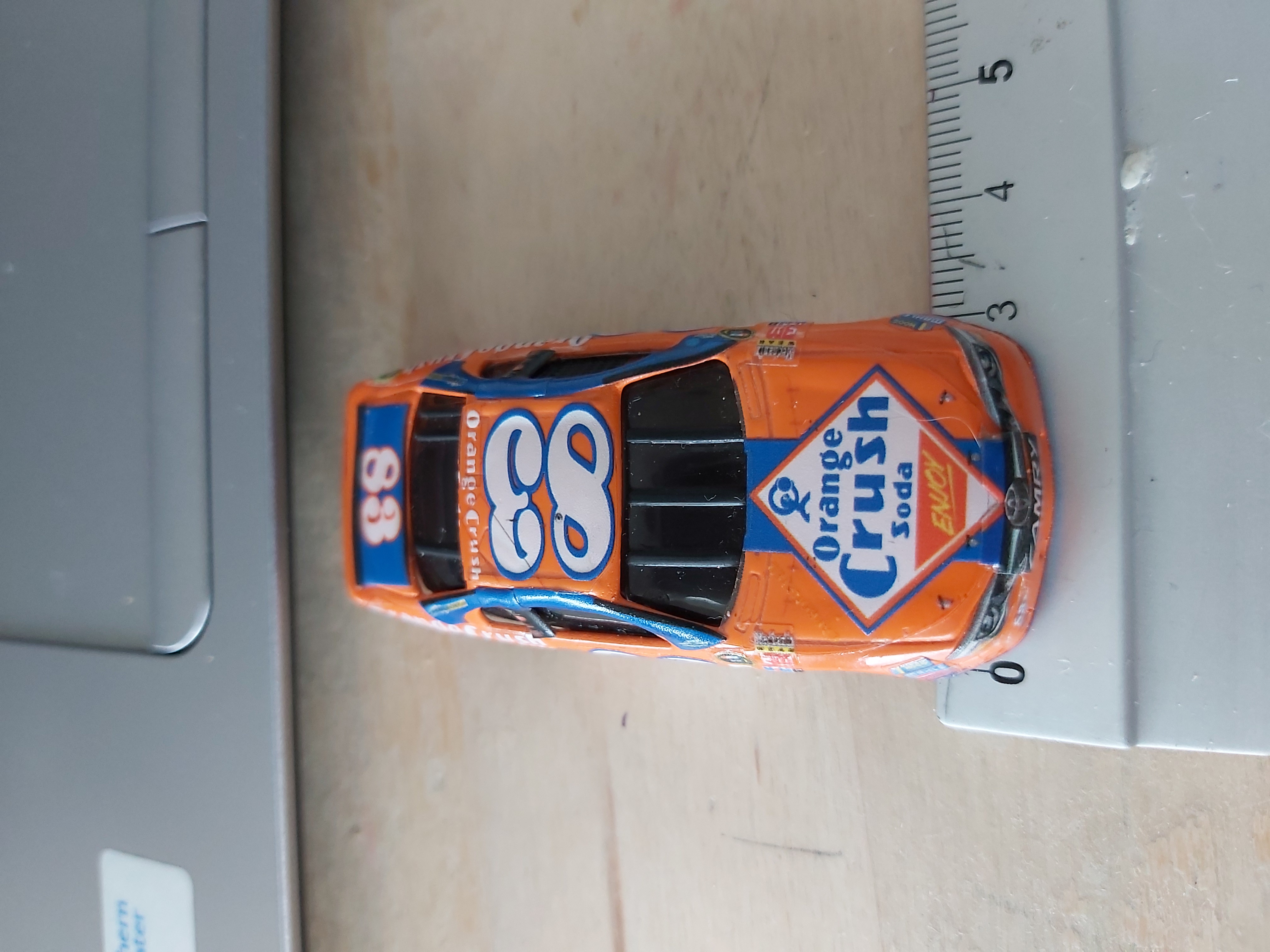

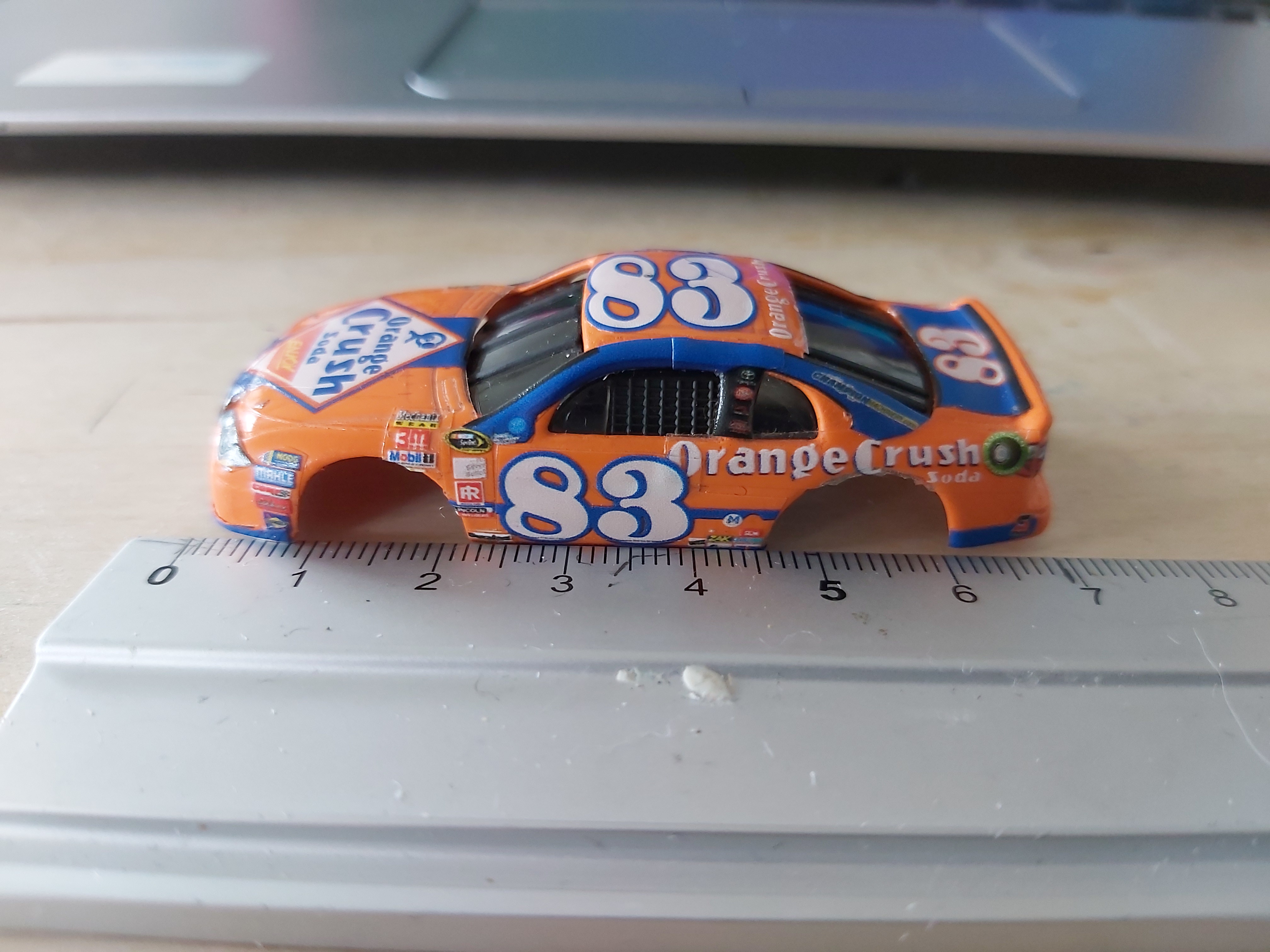

Here are some photos of the same body to give the dimensions. The Tesco car is white as you say.
Length of car is 70mm
The hood and the central part of the car is 30mm and it narrows to about 25mm front and rear.
Door height to the windowsill is 12mm.
Rear deck is 12mm.
Roof is 18mm by 18mm.
I agree on doing the stripes first and then overlapping the box on the bonnet and the roof number.

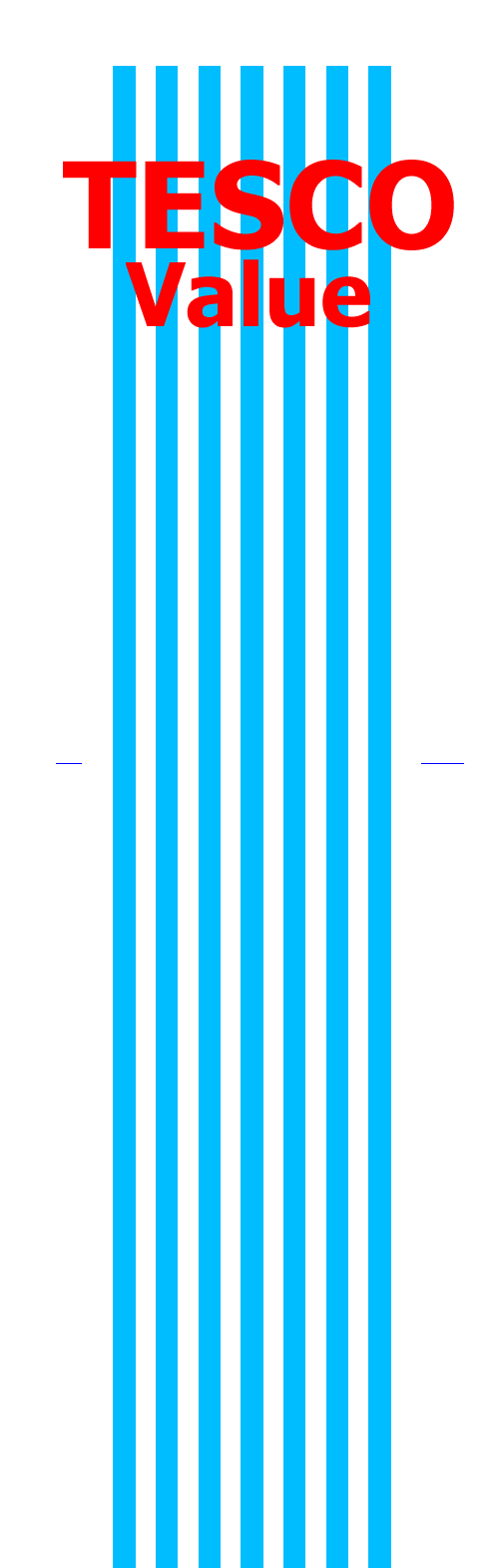

Anyway, I have attached the print file to this. Version one, feel free to suggest improvements.  Print on plain paper to try for size.
Have tried to scale to suit but can adjust (if you have used Microsoft Word much you can probably re-size the images and fonts yourself ).
Hopefully the file works OK from here, will send another message with my email address. (The messaging system doesn't seem to allow attachments).
The lettering is very small for the HO bodywork! Have used a bit of artistic licence in attempt to make the lettering more legible.

It looks incredible. Thank you so much. Will get it printed to test asap.

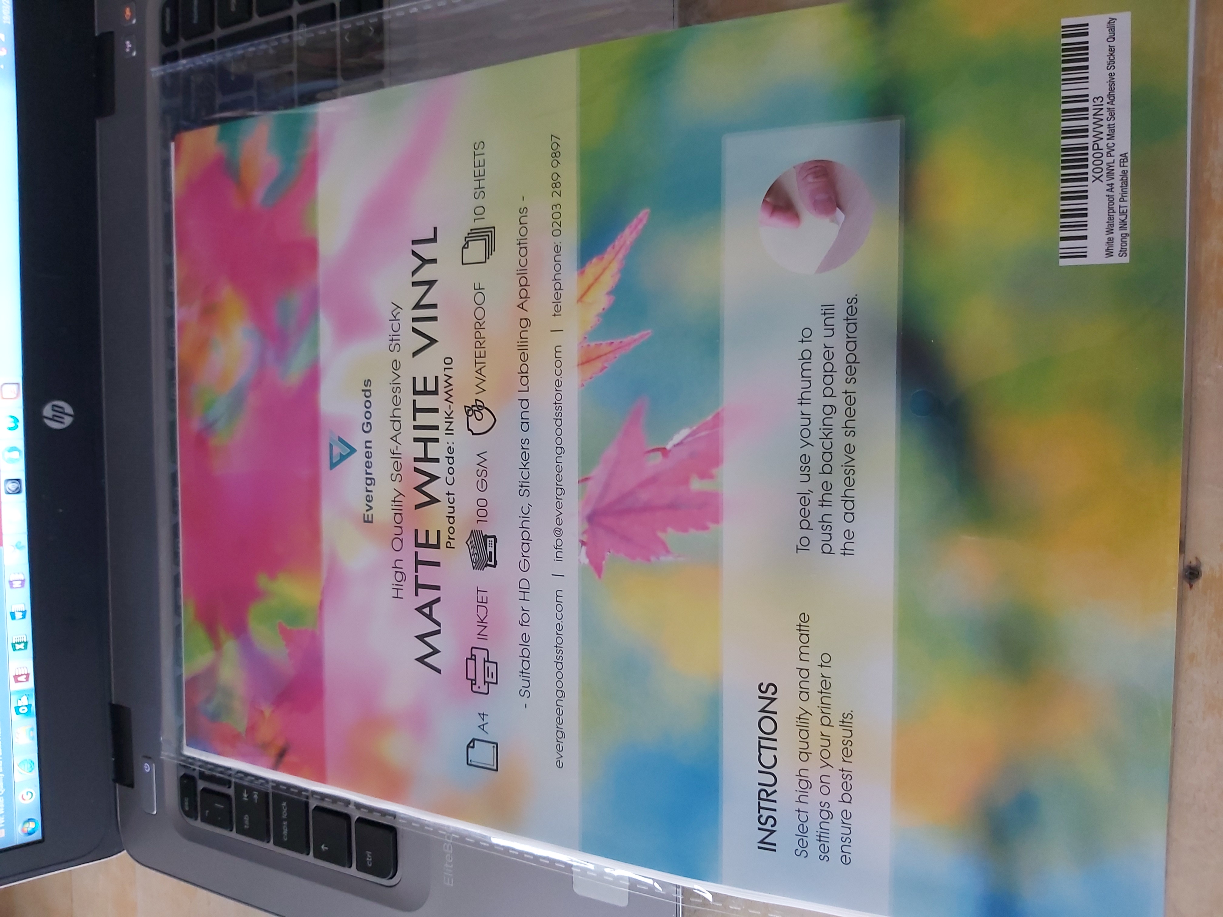

Look what arrived today! And a printer cartridge yesterday as well. So I can give the decals a whirl. Can't wait!

Hope that vinyl sheet works out ok but to be honest I worry that it may not be flexible enough for the curves of the HO size car.
You mentioned "decal paper" and that is usually water-slide type stuff which is very thin and will conform to curved body panels happily.
I use a laser printer so only have that type of sheets or I would have sent you one to try. I think the difference is that the inkjet sheets are more porous so the ink permeates into it where as laser sheets are more suited to the heat and fusion process where the toner sticks to the decal sheet.

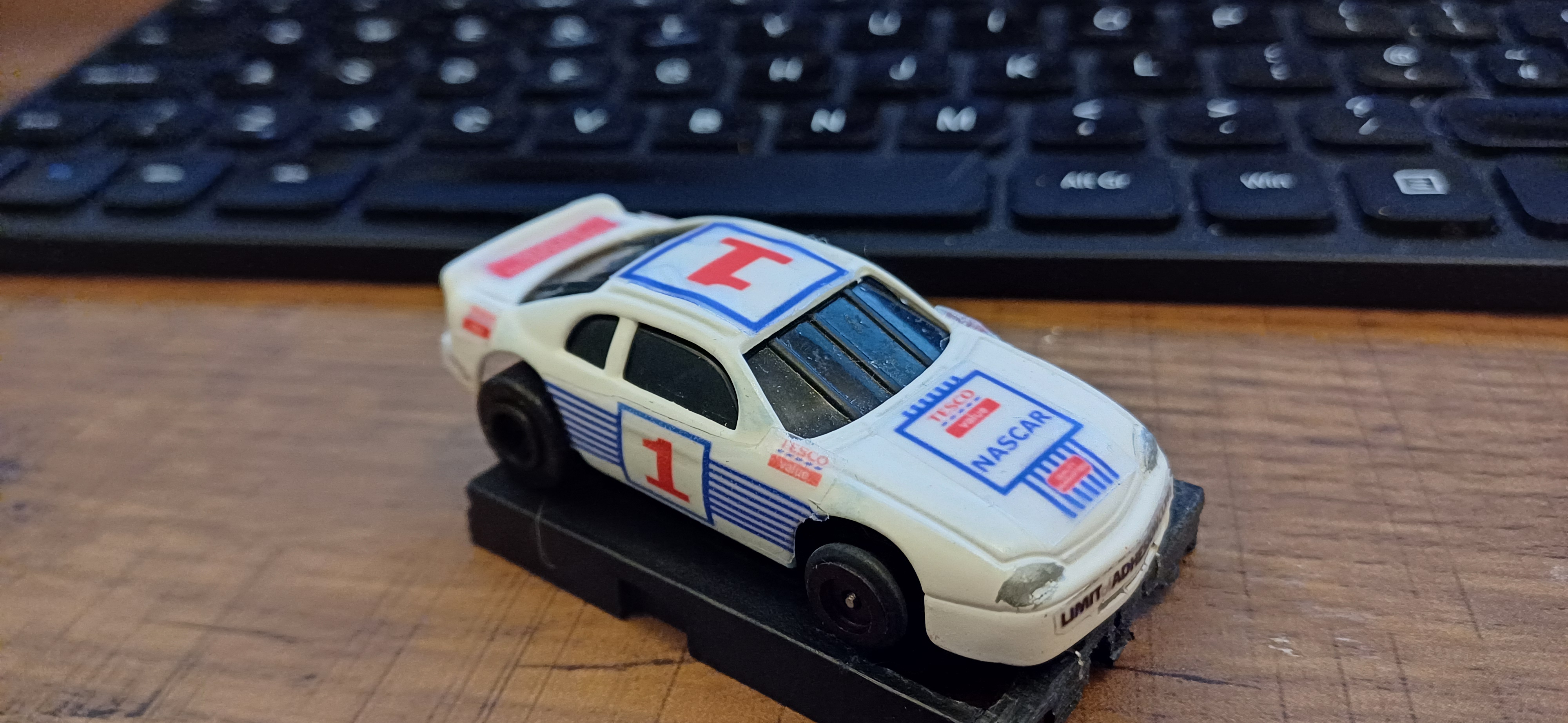

So obviously the pandemic hit and club racing went on the back burner for me until the back end of last year.  I filled the time with sim racing which has been enormously fun but now I'm back to real racing, my desire to get my old projects done re-surfaced.
I came across the white body for this car in a tub in my shed several times and then had it under my monitor for another few months before finally plucking up the courage to work out how to size the decals and do something with it.
One advantage of the last few years of sim racing is learning how to use Gimp so I took the excellent work that Leo had so kindly provided and then added some of my own touches.
My first print was on waterslide.  I ended up using brush varnish which I thinned but the decals were still very fragile.  When I applied the red Microsol, they were destroyed and I ended up stripping the car completely, respraying it and then printing the decals on a sheet of peel and stick.
It's not perfect but I'm mega proud to have actually made the car.  I've also added the sim racing league on there (as that is my other creation that I'm proud of) and a couple of small WHO Racing logos on the rear quarters.
