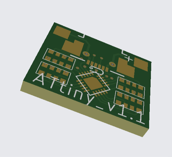

Here is the prototype PCB showing the location of the ATtiny3226 and the LED biasing resistors. The LED display modules are to be attached on the other side of the PCB. The board measures 14.5mm x 12.5mm.

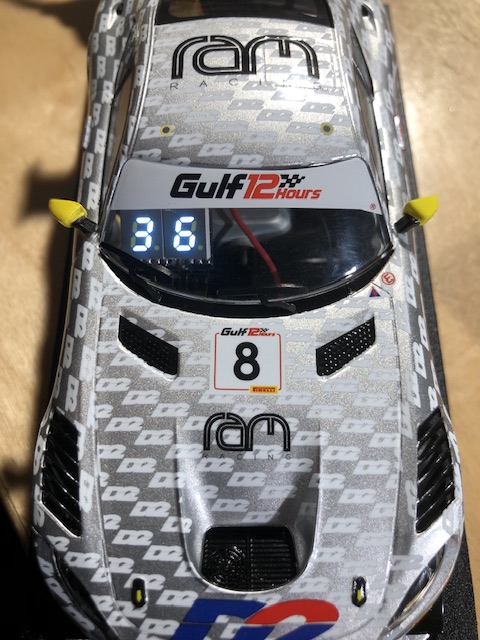

#10
A car displaying its ID.
