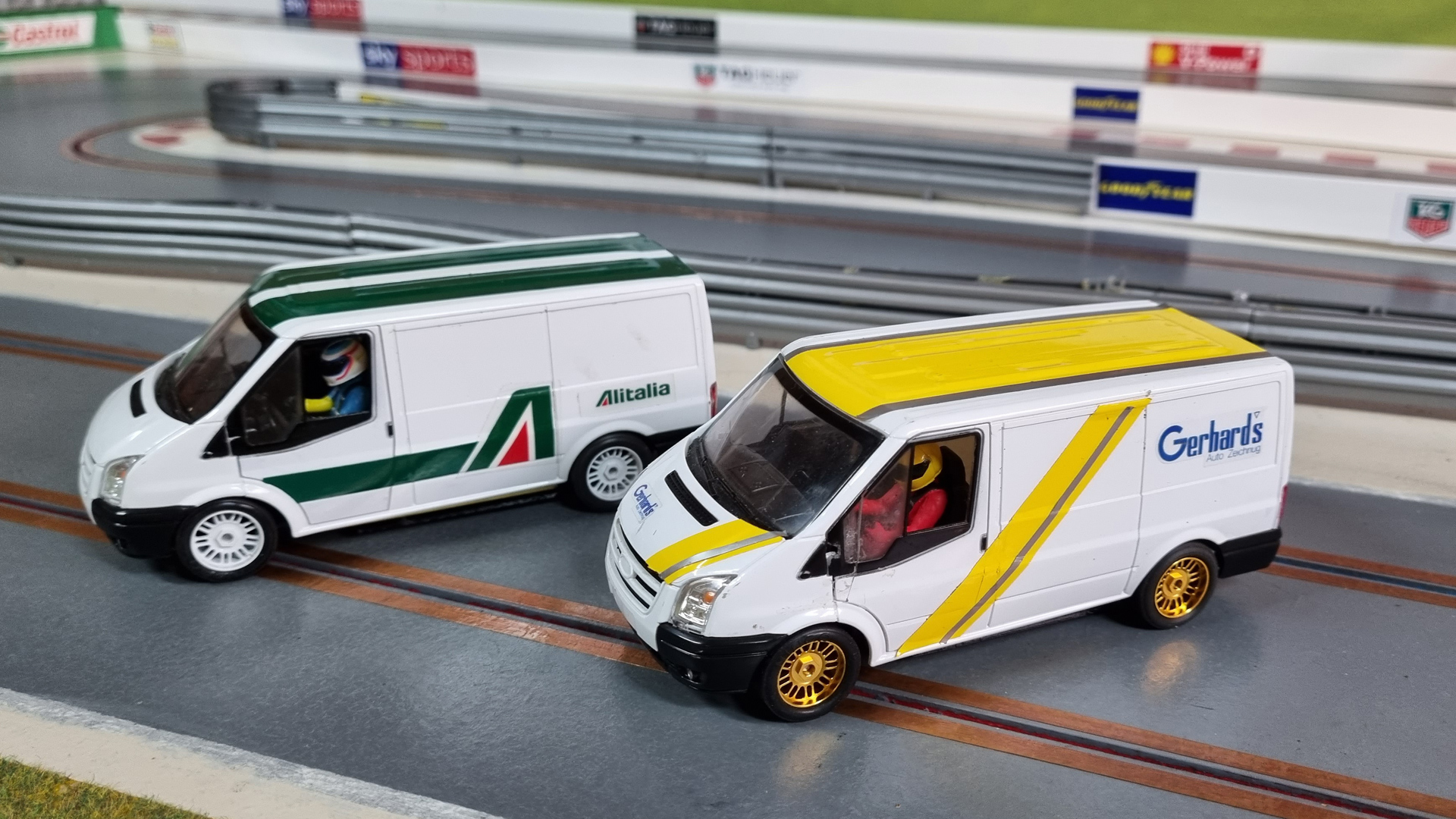

I finished the Transit Vans for Brian a while back, and he collected them when we had our GOLD meet.
I got the other 2 van bodies in a deal with Brian, and had started building a less cost limited version for myself, today I finished them off.
Amato universal inline chassis,  Brass angle bar for chassis weight (the bodies are very hefty!) and filling unsightly vertical gap between chassis and body, Slot.it pod axles and gearing , NC5 motor and Staffs wheels with urethane rear tyres and Revoslot deep guides.

(21st-Aug-22, 01:37 PM)Savage GT Wrote:  I finished the Transit Vans
where did you get the bodies ? would be nice static scenery
I got them from CMOTD, they were once used at the club many years ago.
No idea where they came from or what they were before they were slotified !

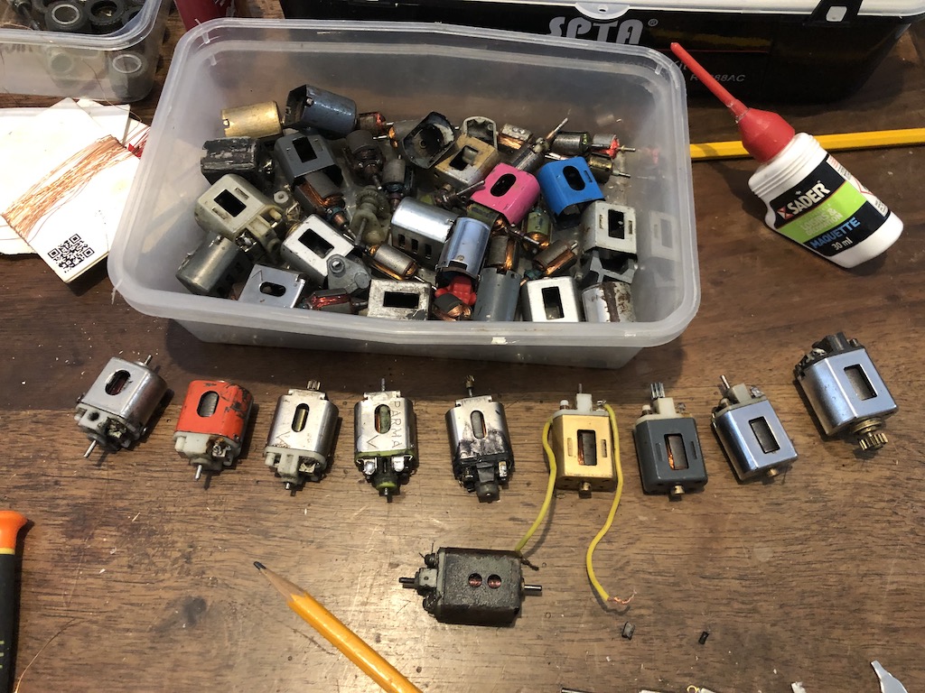

Ronnie has been in the UK for a few days so my bench (dining table) looked like this. She's back today and it looks somewhat different now!!
Anyway, I was shocked to see how many dead motors I have. Not sure if it's the power supply, the way I drive or just the fact that most are approaching 50 years old. The Parmas are not that ancient but bang they go just the same.

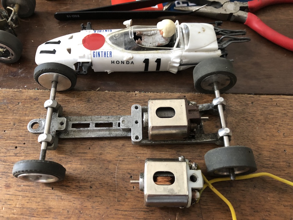

While bits were out, I rewound a 26D for the Honda with its Dynamic inline and want to get the Revis going as well. The maser had a Pittman in as it blew the Atlas - another!! - but I managed to re-solder the wire that had detached and it goes round again and its back in the Maserati.
Most slot stuff I've done for ages but whilst the cat's away......

All the best laid plans etc......
the 26D rewind seems very good. It goes round at least. Get in the car then.....oh s..t!
