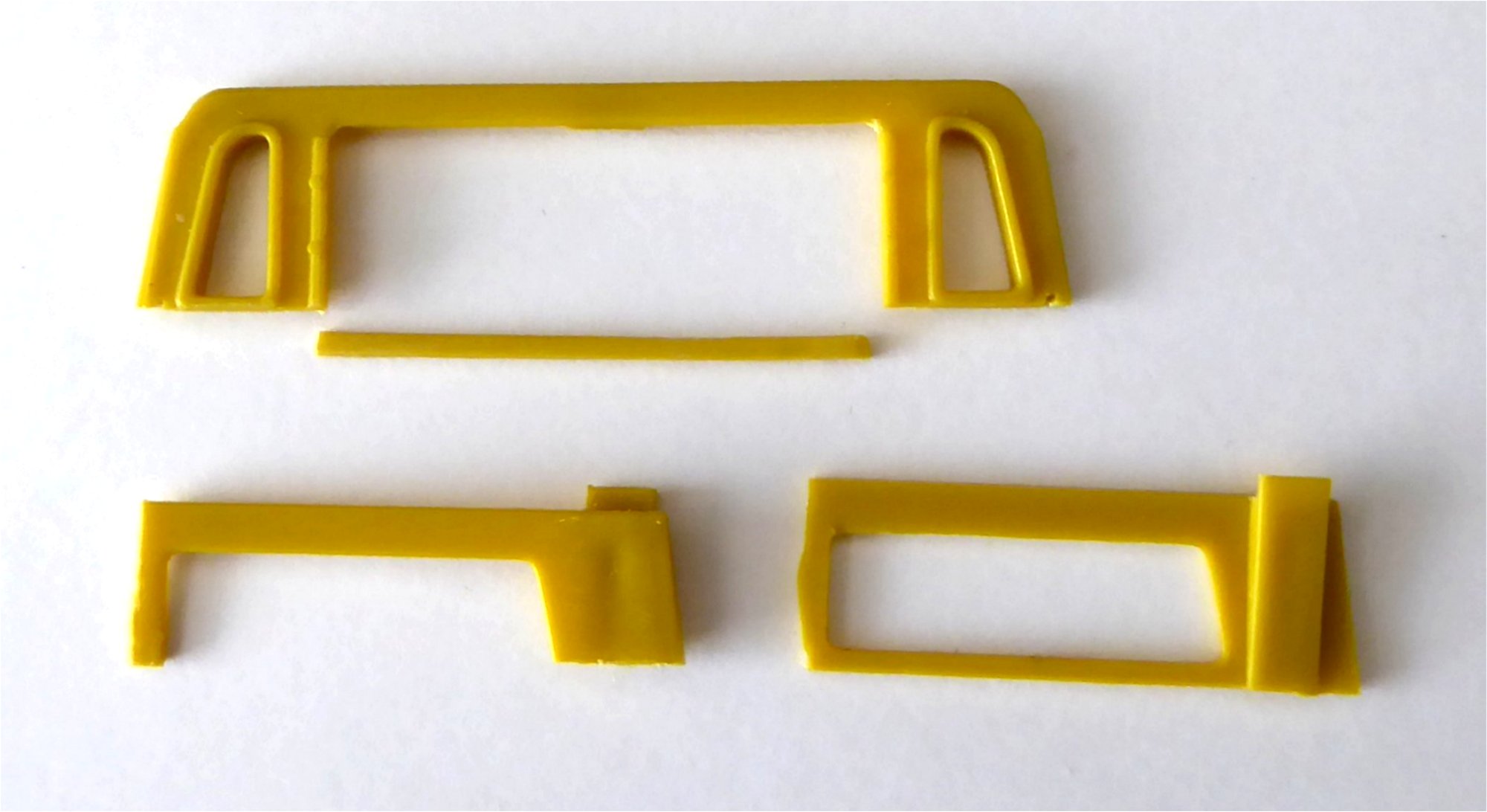

Time to cut the roof to length, then deal with the rear window. The central bar didn't look right, nor did the door shut lines - but the latter made ideal score lines, allowing me to open up a new rear window that matched the height of the glazed 'quarterlights'.
That big rear window just didn't look right though. It needed a bottom glazing bar to match those sidelights. Not having thrown anything away, a 'station wagon' side window provided a piece of plastic just the right length, although it took quite a bit of work to remove that chunky internal brace bar.
The original plan had been to do a complete repaint along the lines of Power Slot's own much more colourful Crew Cab or full Rally Station Wagon versions but I simply ran out of time. As I'd been careful how I cut - and re-purposed 'waste' material from the conversion to complete the transformation there was no need for paint at this point. The only non-original part of the body conversion was the glazing for that big rear window. The lower portion of the rear doors became the tailgate, with the stump of the vertical rear window bar removed by filing it down level with the base of the former windows. I could have left the bed without a tailgate a la Power Slot's version - but this was MY version of a Crew Cab.
