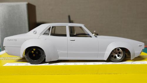

Working on my first 1/24 car to use at the club track.  Trying to get the stance right before going to paint.  With the body style it may not be competitive, but should be fun to race.  Is fitted on a Plafit chassis and the club is a reseller for the parts.  So should have some tuning potential and benefit from the experience of the club owner in getting it right.  This is based on the KenMary 4DR Skyline works car.
My DIY projects and failures at  https://dazee-projects.blogspot.com/
[+] 2 members Like dazee's post
