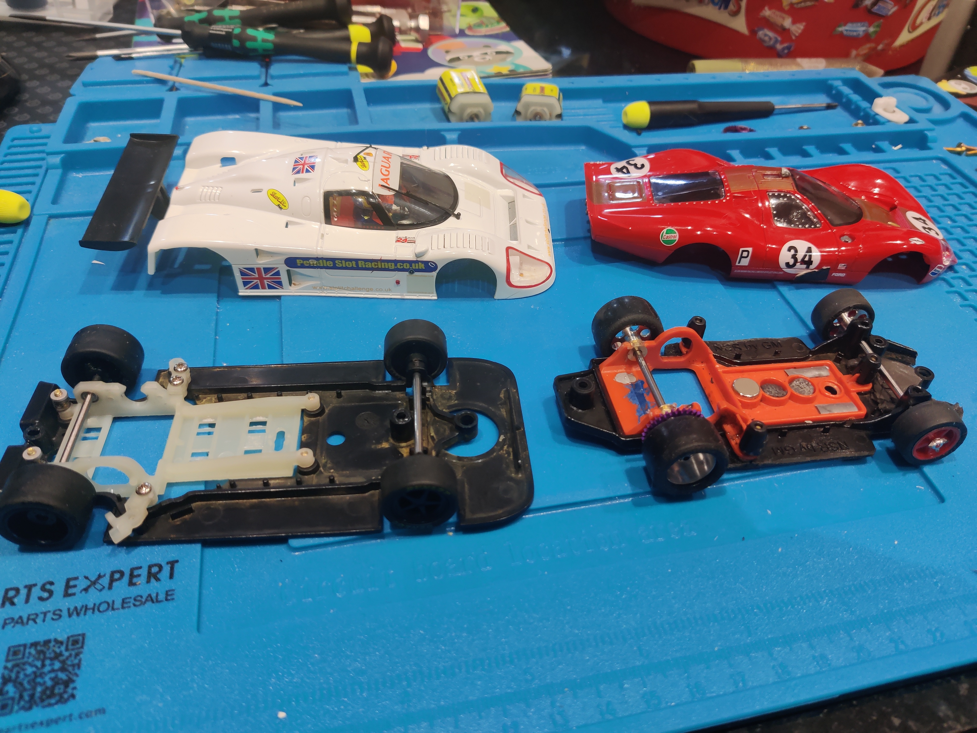

Build 1
Slot.it group c Jag
Lightweight interior
Staffs slots  alloys all round, 15.8 X 10 air hubs on the rear, independent fronts
BRM F15 tyres
1mm offset SW slot.it pod (new one with ballraces)
Reduced centre rear axle
Trimmed sloting plus deep guide
11*36 gearing (18mm lightweight aluminium slot it job)
Motor tbc, need to test some I have
Medium suspension in rear of pod
Build 2
Nsr p68
Standard chassis, pod, wheels,
Nsr ultras rear, zero grip front
Nsr wood guide
Nsr medium suspension
Lightweight hollow rear axle, Sideways bushes (for 2.38 mm axles)
12*36 gears
Motor tbc
Rolling chassis so far

Yeah I need to look into drill blanks, I had a few bent hollow axles. I thought the reduced centre would be required for the slot it pod as I was expecting to use an nsr motor, and from memory they don't fit?  But as the slot it motor won out I can revert to a normal axle. The hollow one was just a 2.38 axle I had handy to replace the nsr one.
Using an NSR motor in the slot.it pod does indeed require either a reduced center axle or mild grinding of the can. Eajsy work with a Dremel.
That's what I thought, I think any sort of messing with the can will be found upon tbh, even if it's perfectly legit.
What would constitute a quality drill blank? Is there a brand, specification or property that would mark it out as quality?
These seem cheaper than actual axles!
3/32 hss drill blanks
Or ease the round holes in the pod so the motor has a little fore/aft movement which has the added benefit of not being restricted to a particular diameter set of gears.
Good idea, I'll try it with a broken pod first to see if it is in my skill set.
Jag is "finished", not seen a track yet so maybe a bit of tweaking required on front axle and weight. Not as neat as Chris W's build!
Turns out the brown motor did have screw holes so fits fine, solid axle reinstated, had to change to 7mm pinion and 17.5mm gear for clearance (body and ground as wheels/tyres are only just 18.5mm)
