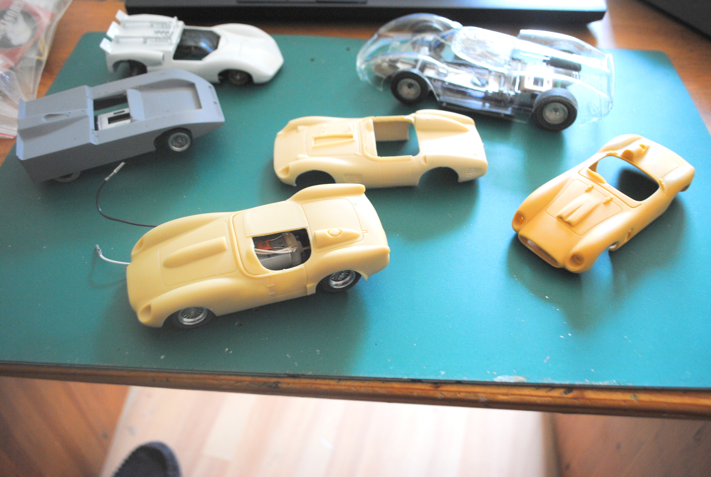

So on my workdesk now is what could be called a Plethora of Ferrari's

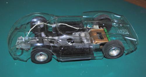

I have had this  Russkit chassis for a couple of years now. then I was able to pick up a brand new Ferrari P2 body by Russkit , body clips arrived thanks to Don, and now I need to get some paint this weekend.
I have always wanted this version of the Chappy - I assume it is simply the Chapparal 2 (as opposed to the 2 A by Cox and Monogram) - made by Hawk, having to recreate a screen from a water bottle and it now has a Riko chassis added.
This is a poor make unknown resin Chappy 2J - body is not low enough so will add the ground effect sils to get it a bit lower. Fitted with a Monogram chassis

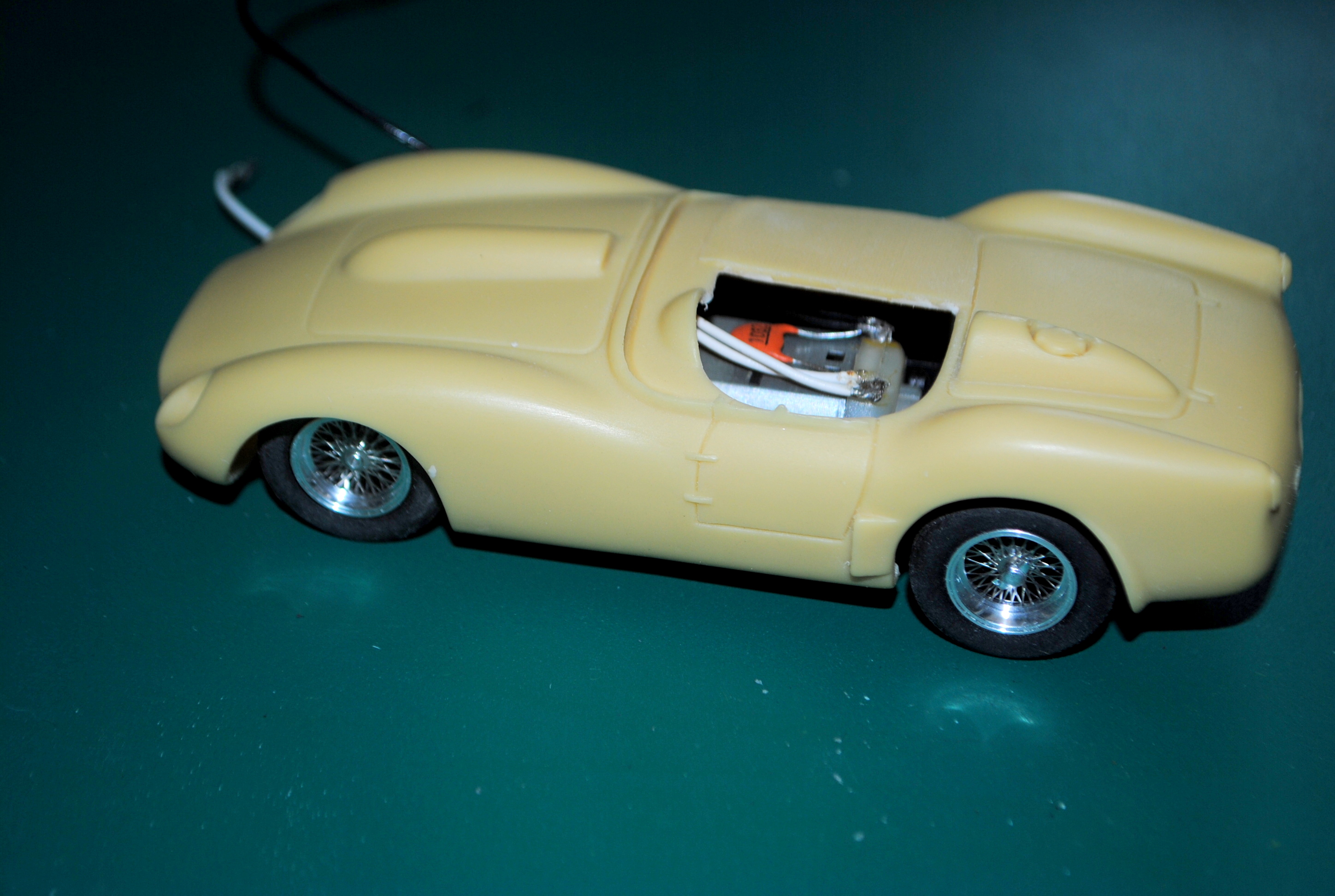

Ghost Models Ferrari TR58
Classicslots (Ocar copy of Slot Classic) Ferrari TR59/60
And then a superb Ferrari 860M  - bought off ebay - and I have NO clue who the manufacturer is - great quality with etched metal grills etc.....

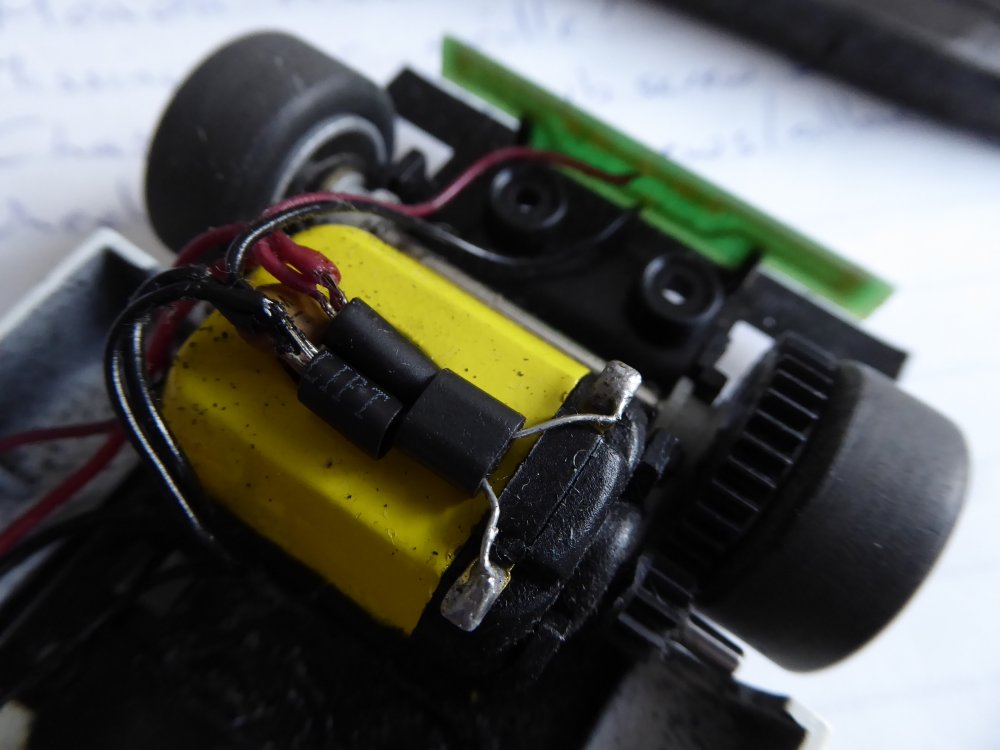

Nothing so exotic on my bench. Just a bunch of second hand cars bought at Gaydon, to run at a 1/32 club if/when I get the chance to visit again. The quickest seems to be the Scalextric Chaparral 2F - BUT - is the motor stock?
Anyone able to identify it for me please - and if so the RPM spec?
I can't see any markings on it.
If not stock it is a VERY neat swap.
#23
That is a Scalextric motor - came out a few years ago as an upgrade - will need someone more knowledgeable about RPM - my guess would be around 21k
#24
Yo T-D,
The second user cars are the best bargains and have lots of potential.
That yellow motor must be the C8421 20K Scalextric Sport+ motor.
Edit: Just found the scrap that I kept from an Impala Pro-Kit.
#25
Scaley did a 20k, 25k and 30k S-Can usually together in a tuning set with a white kit (I had an Audi R8 like this).
Yellow - 20k, Orange - 25k and Blue - 30k.

The Sport Plus long can motors are Red (20K), Lime Green (25K) and Black (30K). Avant Slot do a pink unbranded 25K long can that has that same cooling slot arrangement ...
