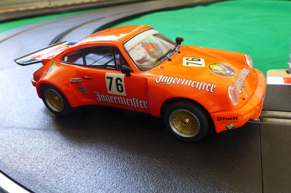

This new Porsche 911 Carrera 3.0 RSR was unveiled in the Scalextric catalogue back in January and there was quite a buzz around it. A classic Porsche racing car, the 3.0 RSR competed both sides of the Atlantic and will give Scalextric fans a nice range of liveries - the first being the Jägermeister-sponsored Kremer Racing car that raced at 1975 Monza 1000 Kms and Al Holbert’s 1974 Trans-Am entry. Scalextric kindly sent me a pre-production sample of the Kremer car to have a look at...
It's certainly a very striking livery! Looking beyond the bright orange and focussing down on the model itself, I had a few questions... First, all the dimensions are nicely 1:32 scale - 137mm long, a wheelbase of 70mm and rear track of 58mm. Those rear wheels and tyres are massive at 13.5mm! Maintaining the accuracy of the wheels means there was no room for the preferred sidewinder motor - but the combination of inline S-can Mabuchi and the big tyres is the right choice, I think. That means a tray interior, but there is a decent amount of detail, with a seat back and decorated driver's helmet...
You can see from that picture that there are some compromises made between producing a highly-detailed model and a robust slot racer - most obviously the lack of a vent between the front quarter panel and the door. I understand that makes the car nice and solid, but there's not even a painted approximation or moulded recess. A bit of paint on the vent behind the door would have improved the look too. Another slight disappointment I had was the motor cover wasn't quite as tactile as I had hoped for - the grille could have been a bit more pronounced. It's the same with the wheels - not as much detail as the similar wheels on the recent XJS.
I did wonder about the stance too. Looking at period photographs of 3.0 RSRs, the rear wing and line from front lights to rear wing are correct, but the gap between front wheels and arch does give a strong suggestion the nose is lifted up. And the curve of the rear wheel arch is just a little too flat. A few criticisms, but overall I do like it - and it looks great on the track...

Again a great report, Andy.
Nice livery of the Carrera 3.0 RSR, but the rear side windows look a bit strange to me.
They should lift at the rear at the bottom side.The B-pillars are a bit too short to my opinion.
