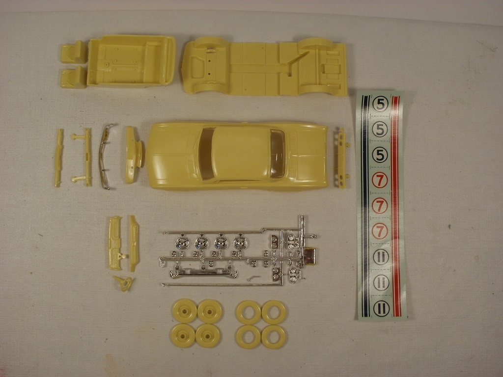

I just acquired one of these kits yesterday. It was made in 1965, but looks new from every aspect. It's somehow tempting me to change build priorities. No one I know has one of these as a slot car. We run an SCCA class race and this would be by far the most original car in the field as a "Yenko Stinger". As if I didn't have enough builds ahead of me...
#59
So how low
are you going to go?
I love puttering with gears
#60
Hi Jeremy. I'm heading in this direction for the car. Yenko did a good job upgrading it to a reasonable perfomance status. Light car, flat-6 with 240hp. I'll take one!
Here's a Yenko Stinger. These cars won a lot of races.
