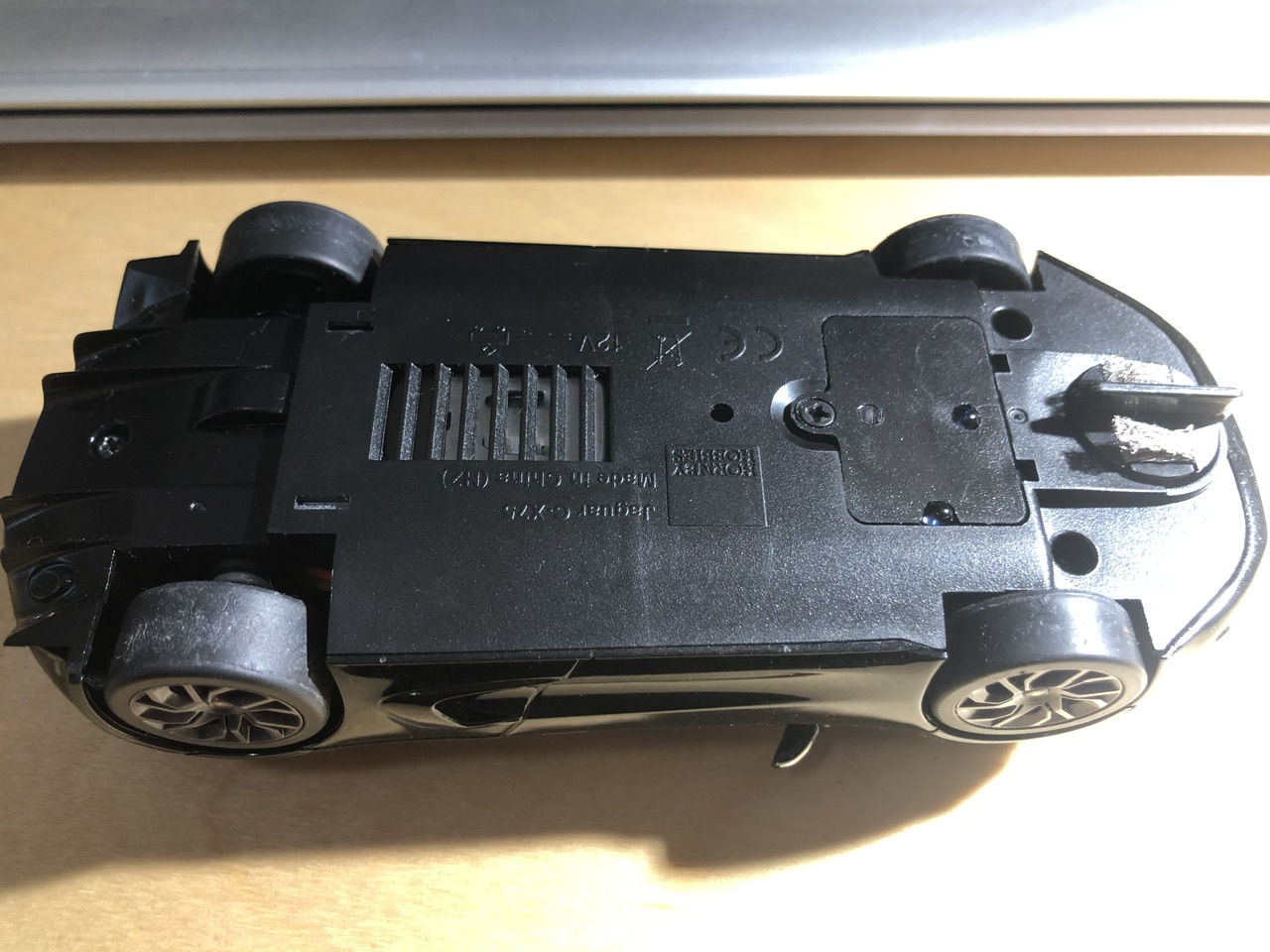

Here is the underside of the Jaguar C-X75 which has the new wireless decoder fitted.
The decoder currently drives the IR LED on the centre-line i.e. the position used for Scalextric Digital.
As you will see there is a second IR LED in the off-set position as used for Carrera Digital. For now, only the centre-line LED is used and this is for both lap counting and lane changing.

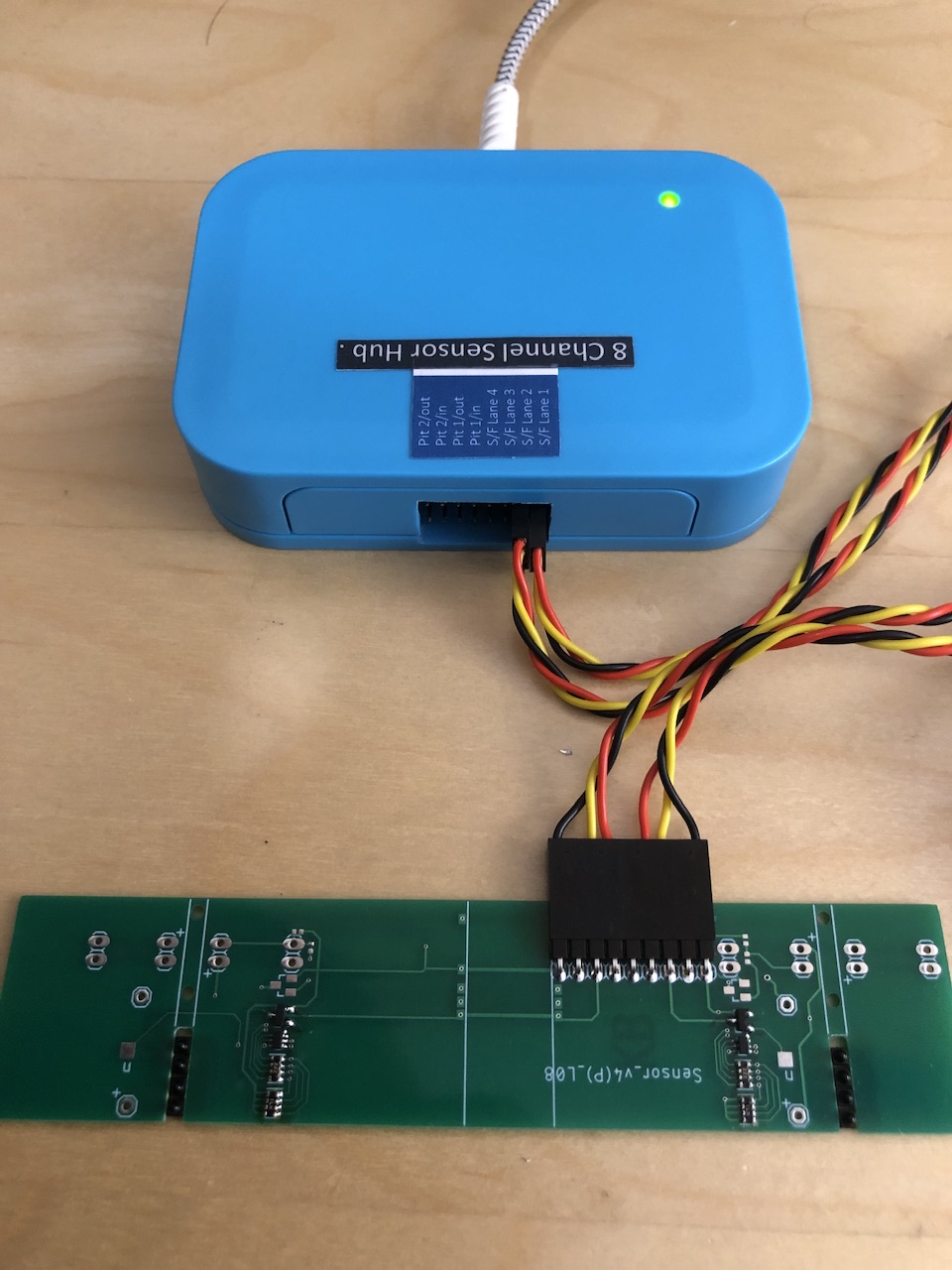

Here is an 8 Channel Sensor Hub together with a two lane track sensor designed for Policar/Ninco lane pitch.
The Sensor Hub is configured for up to four start/finish lanes and two pairs of pit entry/exit sensors.
The Sensor Hub reads up to 36 unique IDs and sends ID detections to PC Lapcounter via USB at 115200 bps. Currently PC Lapcounter has a limit of 32 cars - still more than plenty!
Some very kind friends have been testing the firmware used in this Sensor Hub over many months - big thanks!
c

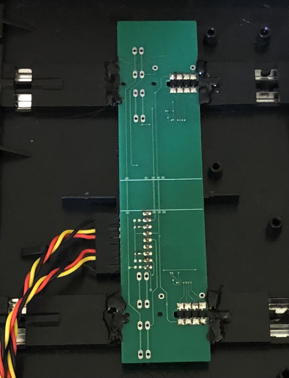

14th-Aug-24, 10:09 PM
And, here is one of the dual lane S/F sensor boards which has been hot-glued into position on the underside of a Ninco track piece. As mentioned previously these are high speed sensors.

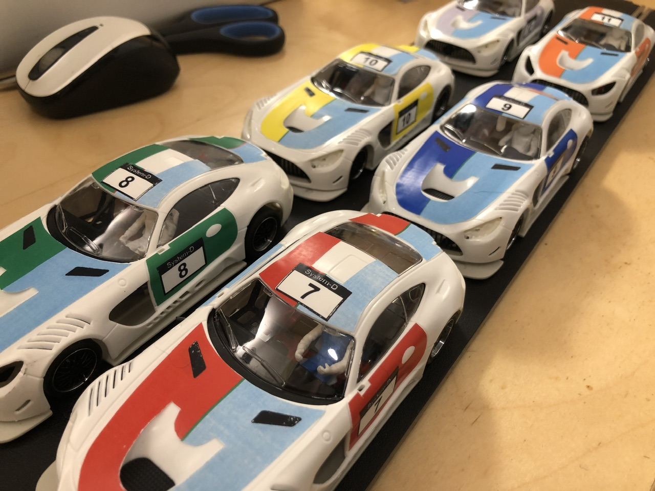

As a final positive, we now have hardware readied which includes a twelve car race pack of NSR AMG GT3s with decoders fitted. It also includes twelve matching throttle controllers, a high power wireless hub and of course the Ninco trackpiece with S/F sensors and associated 8 channel sensor hub. It’s a full system development platform.
